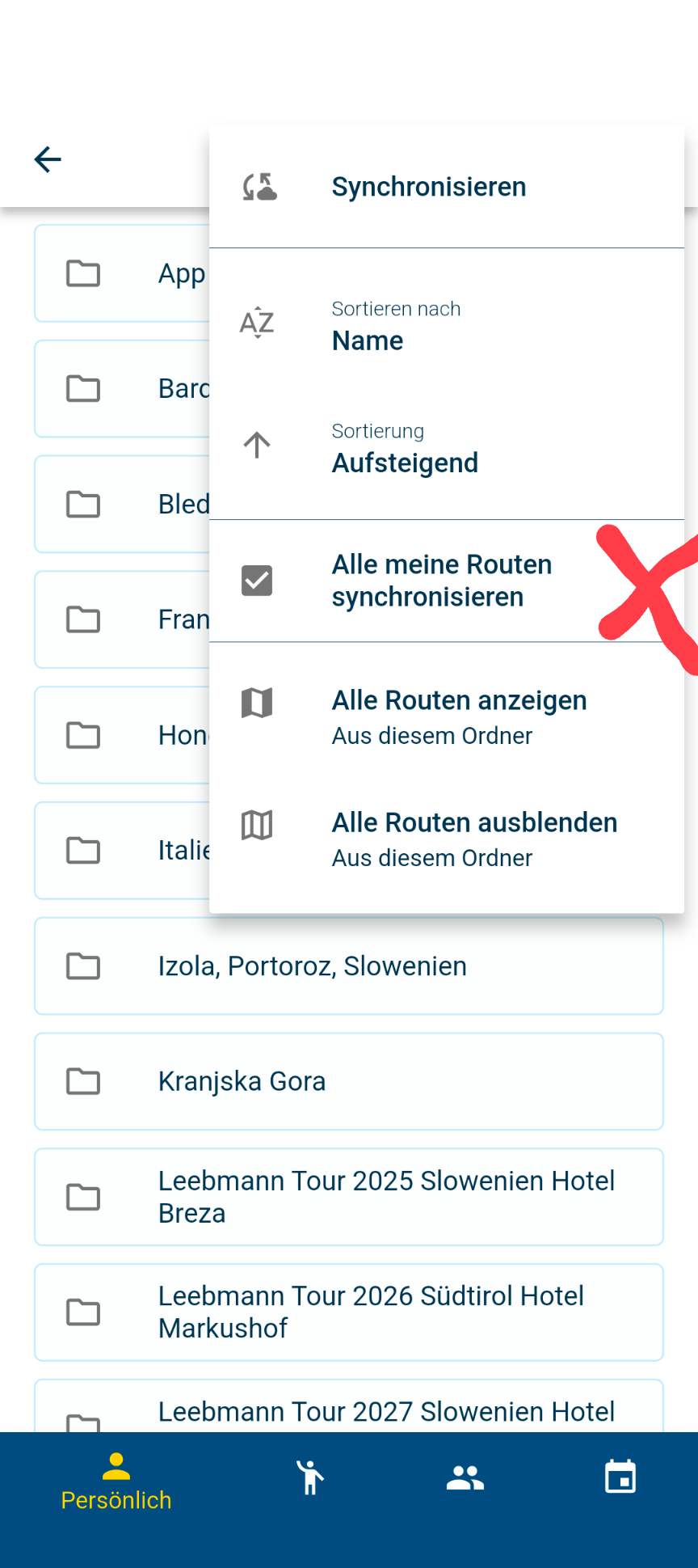

          @Peter-Zehentreiter
          1. I did download the route for a couple of days the day before, is that the same as downloading the map? However, when I tried to access the route the next day MRA would not open as I had no internet access, even though I had opened it earlier using the hotel wifi.
          • Alan Purcell 4 Alan Purcell 4
            @Peter-Zehentreiter
            wrote last edited by Peter Zehentreiter
            @Alan-Purcell-4 No, those are two different processes.
            Actually, it’s not even necessary to download the route... unless you want to transfer the GPX file to another app or to your Garmin.
            28829.png It’s enough to just sync all your routes.
            Downloading offline maps is a completely different process.
            Go to your avatar and select “Offline Maps”; there, you can choose which countries you want to download for offline navigation.28827.png

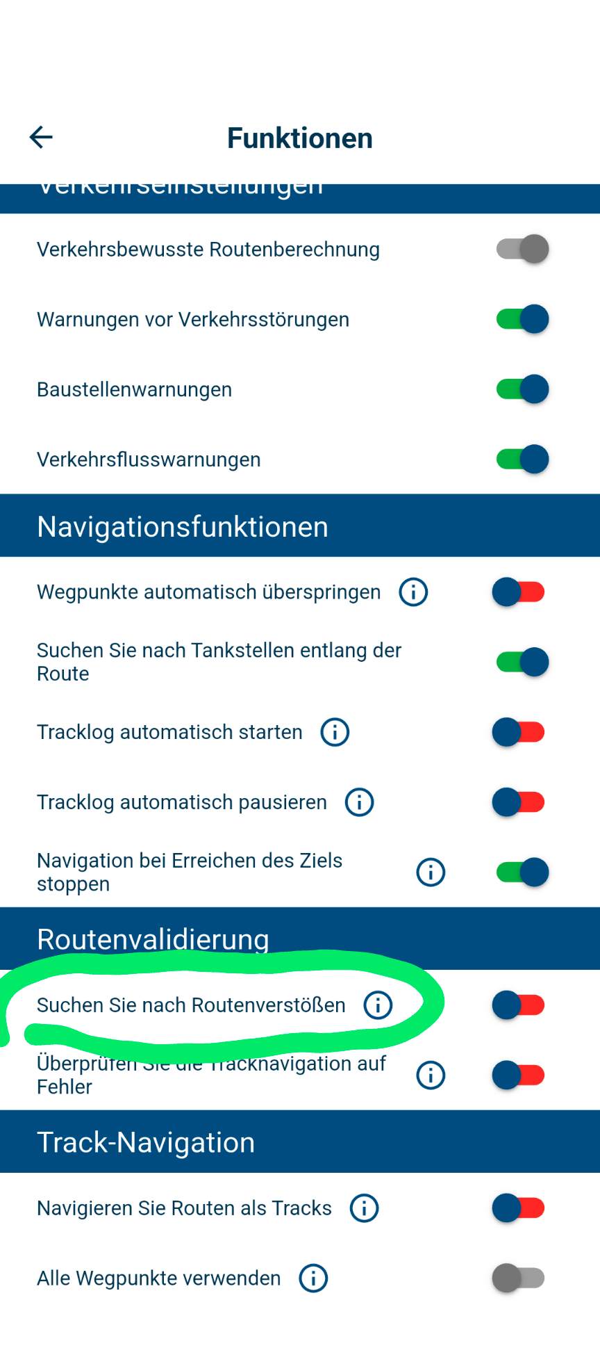

              @Peter-Zehentreiter
              I think it was a danger warning, e.g. something like dangerous road segment and accompanied by a red banner on the lower part of screen plus a loud bell like noise
                @Peter-Zehentreiter
                @Alan-Purcell-4 The app probably warned you that you were on a road that’s closed for the season.
                You can disable route violation alerts in the navigation settings.
                There’s a great support page with lots of useful tips and instructions 😉
                https://www.myrouteapp.com/support
