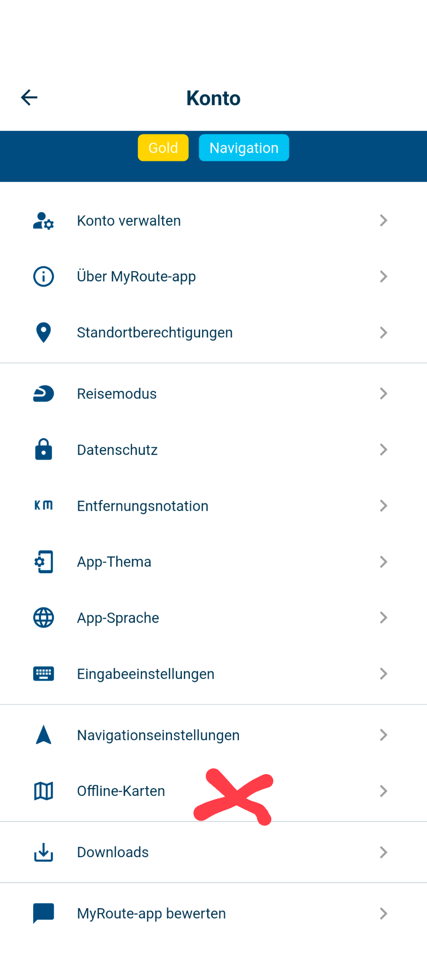

            @Alan-Purcell-4 No, those are two different processes.
            Actually, it’s not even necessary to download the route... unless you want to transfer the GPX file to another app or to your Garmin.
            28829.png It’s enough to just sync all your routes.
            Downloading offline maps is a completely different process.
            Go to your avatar and select “Offline Maps”; there, you can choose which countries you want to download for offline navigation.28827.png
