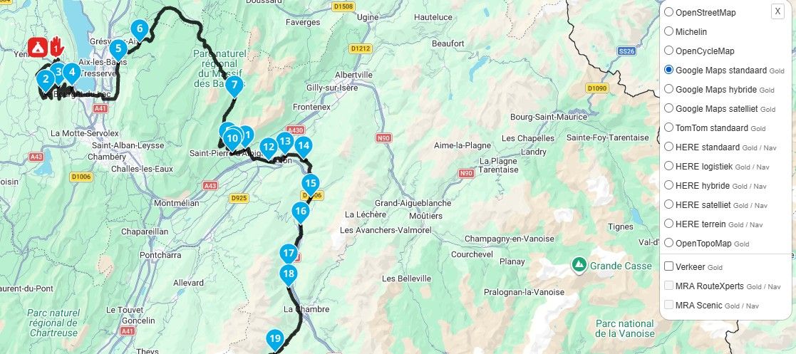

    Is there a possibility to always show my favorites on my map?
    When I was working with Mapsource in the past I just copied all the favorite points of view, campsites and hotels on the map so I could start making my trip. Also when I quickly made a trip in google maps in the past I could route it along all the points I had saved in the past and wanted to visit. Is this possible in MRA? Or is it possible to load my own (logged in) google maps overlay instead of an empty one?

      No, that is not possible in this version, but it is on the wishlist voor de overhaul of the planner. So we have to be patient what's coming up in the future.
        What is possible, is to save them all as POI's in a GPX file. And then import them as POI-file.
        Just a temporary work around!

                        @Pim-van-Dongen Selecting the profile icon makes that category of POIs from your POI library visible in ALL routes including when using the navigation app.
                        Make your favourites into POIs and then upload them to your POI library to achieve this.

                          @Pim-van-Dongen Open a new route and give it the name favourites. Now select your first favourite, now open the POI section and select the manage tab. Click Add and then click on the map where your favourite location is to add a POI at that location.
                          Do this for all of your favourites, when you have finished click Save as and choose .csv (POI) as the option. This saves your POIs to your computer. Now go to the Library tab of the POI section and select Add, this opens an upload box where you can then choose the .csv (POI) file from your computer.

                              Again, this is not what I said, the process of adding POIs at your favourite locations and then saving the .csv file is so that you can upload the file to your POI library. This is a one off operation, once the .csv file is uploaded to your POI library you can then select it for individual routes or by ticking the profile icon your new POI (favourites) will be visible in all routes.
                              I can't be any clearer than that!

                                  @Pim-van-Dongen Unfortunately, at this moment in time this is your only option. If you save the route that you created a titled Favourites you can add new POIs to it and update your library file. If there was an easier way to do it I would have explained it to you. Favourites in MRA are like bookmarks, a quick way to find a favourite location. Hopefully, we will be able to organise and put favourites into folders soon but that is not possible now.
