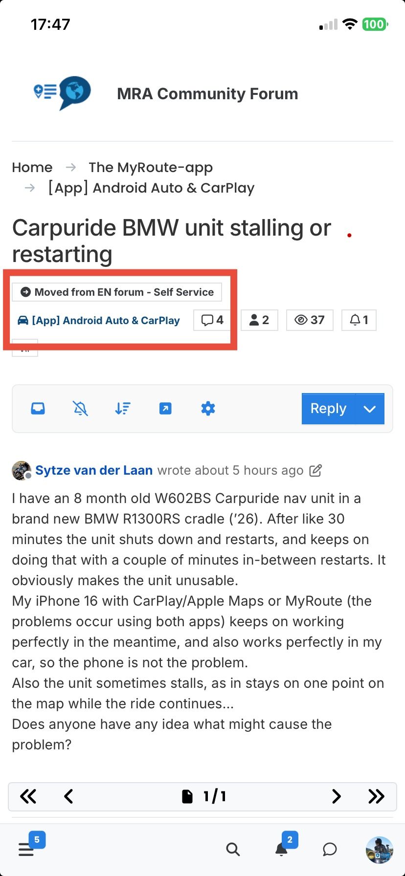

    I have an 8 month old W602BS Carpuride nav unit in a brand new BMW R1300RS cradle (’26). After like 30 minutes the unit shuts down and restarts, and keeps on doing that with a couple of minutes in-between restarts. It obviously makes the unit unusable.
    My iPhone 16 with CarPlay/Apple Maps or MyRoute (the problems occur using both apps) keeps on working perfectly in the meantime, and also works perfectly in my car, so the phone is not the problem.
    Also the unit sometimes stalls, as in stays on one point on the map while the ride continues...
    Does anyone have any idea what might cause the problem?

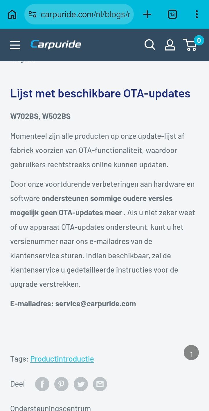

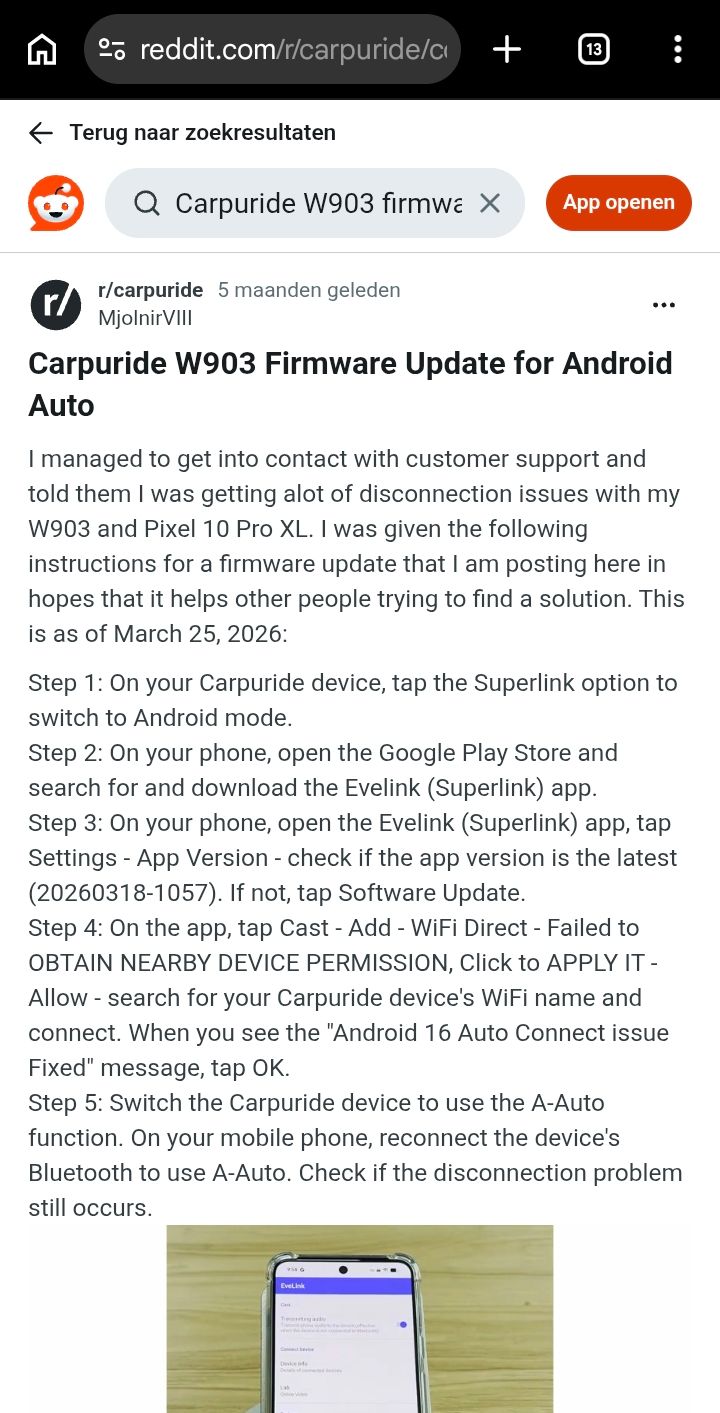

                                There is an update for the Carpureride. Solve an bug in Carpureride info on there website.
                                  #16
                                  @siebo-vd-berg Please share the link for I can not find any message about a bug and an update!
                                  • siebo vd berg
                                    siebo vd berg
                                    siebo vd berg
                                    wrote on last edited by siebo vd berg
                                    #17
                                    ![alt text](image url5772.jpg )
                                    Also the 702
