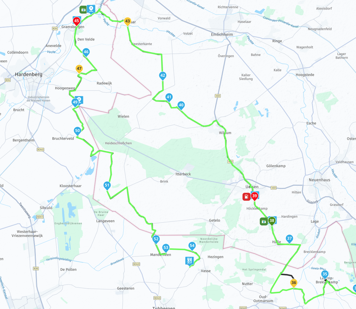

              This is the route i'm talking about:
              https://www.myrouteapp.com/nl/social/route/14017569?mode=share
              And a screenshot were I combined the recorded tracklog and the route

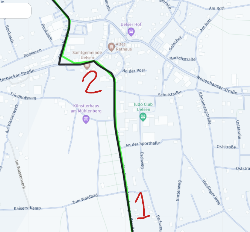

              I was heading towards waypoint 40, around a quarter between 39 and 40, when i heared a beep for the autoskipped waypoint. At that moment i saw waypoint 53 as my next waypoint. I stopped and switched on the screen of my phone (i use Android Auto). That was the moment i saw the orange message for switching from online to offline. I went in the menu and manually selected waypoint 40 as my next waypoint. And start driving again.
              Around halfway waypoint 39 and 40 i heared the beep again and saw i was skipped to 53 again. Again switched on screen of the phone and again i saw the message switching from offline back to online.
              Again selected waypoint 40 as my next waypoint and from that moment on, it went well. Also i didn't see any lost cell coverage anymore.
              When i look at the route. The first time it happend, waypoint 53 was one of the closest waypoints. This could explain something. But the second time waypoint 53 was definitely not one of the closest waypoints. But still it was choosen by MRA
              (I use MRA Next only on Android Auto. Every comment, suggestion, etc will be based on my usage with Android Auto)

                @M.-Schrijver It's a beautifully made Route! I do not see anything strange about it.
                The only little thing I see under full magnification is that at the point 40 the black line brakes.
                I don't think it would cause this issue... or....
                While having nothing to offer in the way of the solution, I am very interested to learn what caused it...
                Following this closely.
                Positive emotions are worth every penny ;)

                    @lennyo i recognise what you mean. When i make a route myself and i see this kind of things. I correct them. But i don't think they effect the navigation. I think it is more a kind of a screen error than a real opening in the routeline. This time the route came from the Route Expert library.
                    @hans-van-de-ven-mr.mra Skipping one waypoint without any signs why, is something i see more often. Maybe the same deeper underlaying cause. I don't know.
