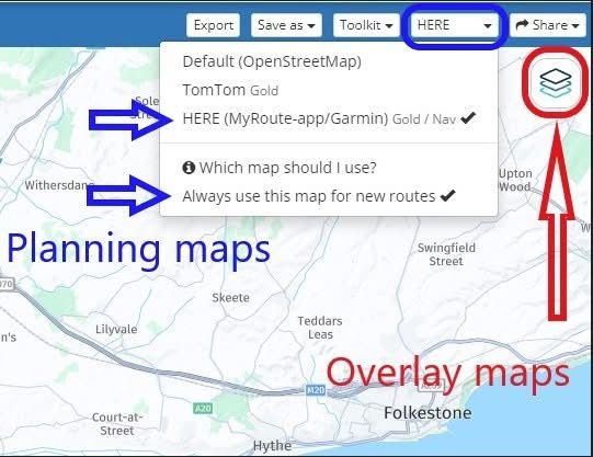

        My screenshot below shows the planning map from HERE is selected and also the option to Always use this map for new routes.
        The overlay maps are separate to the planning maps and have no effect on route calculations.
        Think of them as clear sheets with extra information that you place over the top of the planning map.
        The planning map underneath does all of the route calculations.
        So with the planning map selected you can then use any of the overlay maps.
        If you do not see the same blue menu bar with the planning maps that is shown in my screenshot, click Page menu first and then all of the same options will be available to you.
