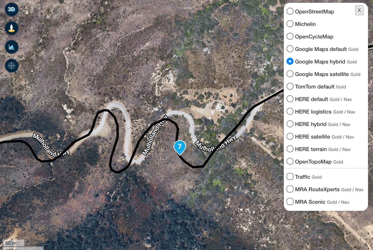

        @RetiredWingMan Interesting. Indeed, it seems to be showing reference to waypoint #7. The problem is that #7 is on the same road (Mulholland Hwy) as #8, and I 100% passed it just a few minutes before. It's a rural area, and even if Dementia due to advanced age is kicking in 😊 there is no other road option where #7 could have been missed, which again, I'm positive didn't happen.
        The only thing I can speculate is that the terrain for #7 is very twisty/technical, so maybe HERE didn't calculate it correctly. But the waypoint is square on the road, so I don't know what I could have done different. I guess I could delete waypoint#7 and re-ride that segment to verify.....

          Update: I went back out today to see if I could repeat the behavior related to waypoint#7. I fired up the route and followed it without deviation. Just like I did the first time around.
          And I got the exact same result. It's repeatable! MRA/HERE thought I had missed waypoint #7 (I didn't) and I was directed to turn around at Calamigos Rd to return.
          In preparation for this expected outcome, I copied the route and moved #7 further up the road (closer to #8) to see if it would change HERE calculation behavior.
          https://www.myrouteapp.com/route/open/13885843
          I re-ran the modified route, the new #7 calculated correctly, and I reached #8 without incident.
          This isn't the first time I've encountered this kind of behavior in MRA -- Both with the Routeplanner (using HERE as the base) and the phone app. I love MRA Routeplanner and will continue to use it with OSM as the base map. It's very stable. Since I mostly use Garmin GPS units for route execution, no problems. As far as the app, I'm out. I can't have this strange HERE behavior mess a route up. Especially when I'm leading a larger group ride. Hopefully, it can be dealt with at some future point.

            The cause is the discrepancy between the road layout on the HERE map and the actual situation. There is an error in the road layout on the map. See screenshot. If you switch on the OSM or Google Maps overlay, you can see this. The waypoint #7 is in the middle of nowhere and cannot be reached by car or motorcycle.

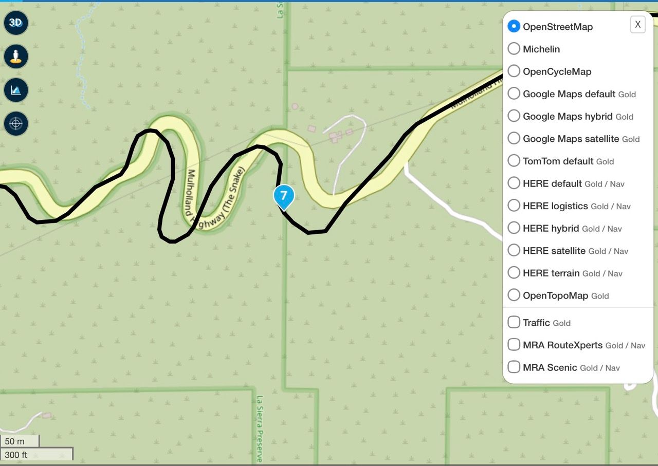

              @reinhard-32 Yes, I suspected it had something to do with the placement of waypoint #7 in the curvy/technical section of Mulholland Highway. I didn't take the rigorous investigative step you presented to compare against the other map overlays or use the Compare option in Toolkit. It confirms why moving #7 to a section where HERE is in sync with the actual road fixes the problem. Thanks.
              It's ironic that all the maps except HERE are in sync with the actual road layout. Should I be surprised?
              I'm not an expert in the internal workings of MRA or HERE. But intuitively, it seems that if HERE in Routeplanner thinks the placement of #7 is OK, that HERE at calculation time in the App would also be OK with the placement. That's obviously not the case. My belief as a user is that I should not have to be concerned with inner workings at this level, but....
              Moving forward, one option (during route development) is to always compare to the other overlays and never place a HERE waypoint where there is a map discrepancy. That could work in the majority of cases, but what if it doesn't? There may be situations where a waypoint is needed, but I don't have the option of simply relocating it further up the road. Since I have to use HERE for any route executed within the App, what then?
              This is my dilemma and frustration. Some might say "I never have this problem", which might be true. However, many of the rural areas of the mountainous western US present unique challenges. My solution in MRA Routeplanner has been to develop using the OSM base map, and then load the GPX into my Garmin XT for route execution. Over the past year, that process has worked without issue.

                In my opinion: The point is on the (HERE) road so if the cursor while driving was on the (HERE) road too, then the point (7) should have been registered. Of course I dont know if this is possible to implement.

                      @John-S-Parry my tip would be not to place points on twisty sections of road because this is where the map data from the different map providers will differ the most
                      if you compare the maps from TomTom, OpenStreetMap & Here you will see that straight sections of road tend to be much more similar & accurate
                      plus having a point on the navigation device mid-corner is a distraction you don't need

                                          the fact that points are sometimes missed by nav systems is just one of those things & is why remote controllers for phones running MRA are probably so popular, it is a quick lift of a finger & press of a button to manually skip a point
                                          I loved my Tomtom because it could only navigate tracks so no Via or shaping points to miss but that sort of track navigation also has its limits
                                        3. "Automatic recalculations" is for when you deviate from a route/track, it will try & recalculate a path back to the route/track, it should not really be relevant here but its worth experimenting, maybe point #7 is far enough off route that its considered a deviation if you stay on the road
                                        Interesting the app has recognised something is amiss, odd the way it has tried to resolve it
                                        wrote on last edited by John S Parry
                                        @Brian-McG Well, I just ran the route again, running the XT3 and MRA Next app on my phone in parallel. Success! I suspect (it's just my best guess) that skipping WP#7 manually instead waiting for "Skip Waypoints automatically" to kick in was the difference. The first time around, it really did take (in my mind) too long for the skip to trigger, which created problems around WP#8 that doomed the route. I agree that the "Offline Navigation" probably didn't affect what happened with WP#7, but I needed it any way for the second half of the route, where cell coverage was spotty and sometimes non-excitant returning back over the mountains.
                                        As for the XT3, instead of just letting the route 'sleep' until auto rejoining further up the road, I instead selected off-route recalculate just to see the result. On the XT's I almost never issue a recalculate (that's another discussion), so it was an additional learning experience too. Like MRA, it recalculated back to the route as originally intended.
                                        I'm sure we could have a spirited discussion on the pros-and-cons of a dedicated Garmin GPS vs. the MRA phone app. They both have relative advantages/disadvantages, and a lot depends on where and how you ride. For me, the XT3 will mostly be my first choice. But you're correct -- that's better left to a separate dedicated thread.
                                        Anyway, thanks for your time on this. I've learned a lot about the app going through this process. Not all scenarios can be documented, and learning by doing is the only solution. At least I'm comfortable enough now to use either the XT3 or the app based on the situation.
                                        Brian McG 1 Reply Last reply
                                        • John S Parry John S Parry
                                          @John-S-Parry yes the issues with garmins are all around the "recalculate" function, it destroyed multiple days touring for me, thats why the XT2 got ditched
                                          As far as I am aware the XT3 uses the same route calculation algorithm so it may be newer & have some additional features but it is still the same flawed device, recalculate has to be off
                                          As for your route being "doomed" around waypiont #8 that would surprise me, given time to sort itself out I would expect MRA to recover, at worst case MRA might need a manual skip or 2 to catch up
                                          This is my third season using MRA & I have to say MRA is far more consistent & reliable than my XT 2
                                          MRA is far from perfect, it does glitch & fail occasionally but if you have the original track/path displayed (white line) then you can normally recover pretty easily
                                          when my XT 2 failed to route, as it did a lot, it was often very difficult or impossible to recover
                                          a garmin with the "recalculate" function enabled is frankly useless, my XT2 messed up 2 whole seasons worth of touring hence it sits at the bottom of a drawer
                                          John S Parry 1 Reply Last reply
