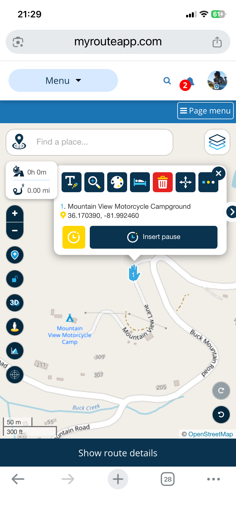

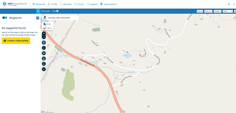

    I am trying to use the map search function to find some POI's to add them quickly to the route. For this specific example it is a great place called Mountain View Motorcycle Campground. In the screenshot you can see it right there on the map, but when I search, it won't find it. I have tried this across OSM, Here and Google. It has to be me. What am I doing wrong? TIA!

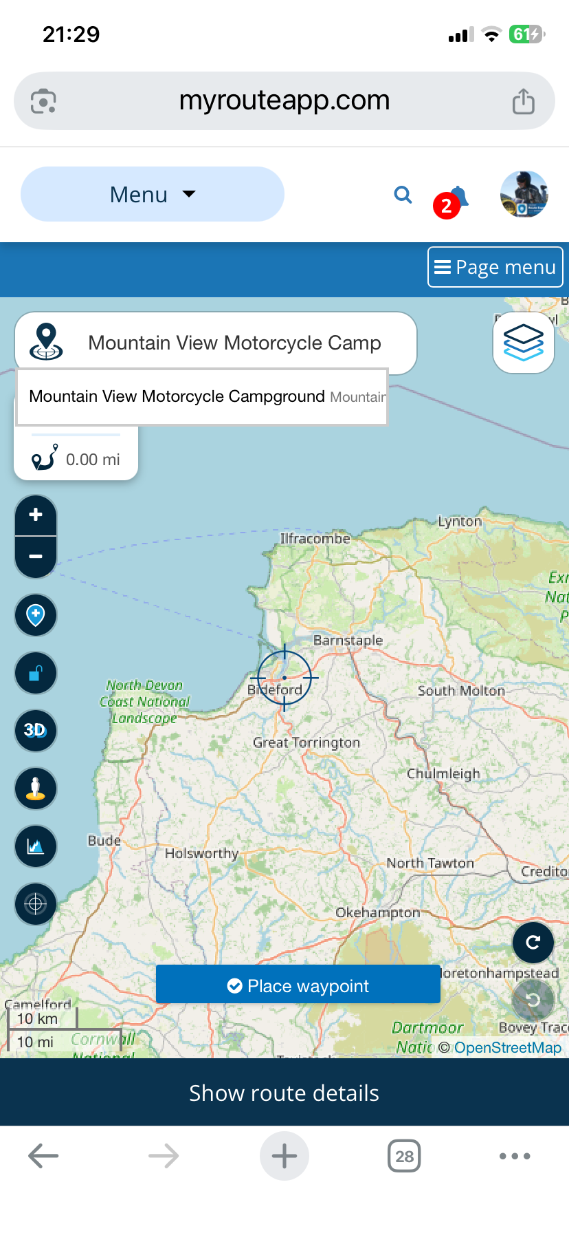

      I’m using the HERE Planning map the same as you and when I type in “Mountain View Motorcycle Camp” I get offered Mountain View Motorcycle Campground, Mountair. I accept it and it takes me there.

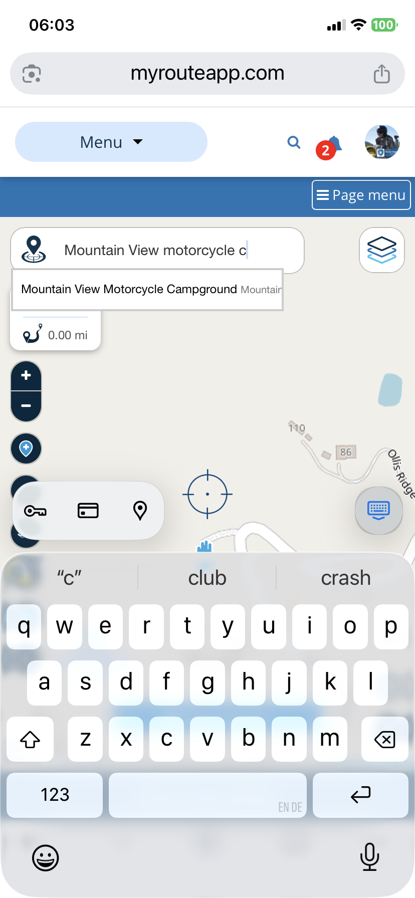

          @Kerry-Lebel If you had typed in one more letter, the ‘c’ from campground you would have gotten the same results as I did.

            OK I understand that. But why was that necessary? Shouldn't the search function have returned all results that start with the letters you put in the search field?

              @Kerry-Lebel I’ll be honest and say I have no idea, but the search box is a world search so I guess that with general names like Mountain, View and Motorcycle it needed the additional c to tie them altogether and complete the search.
