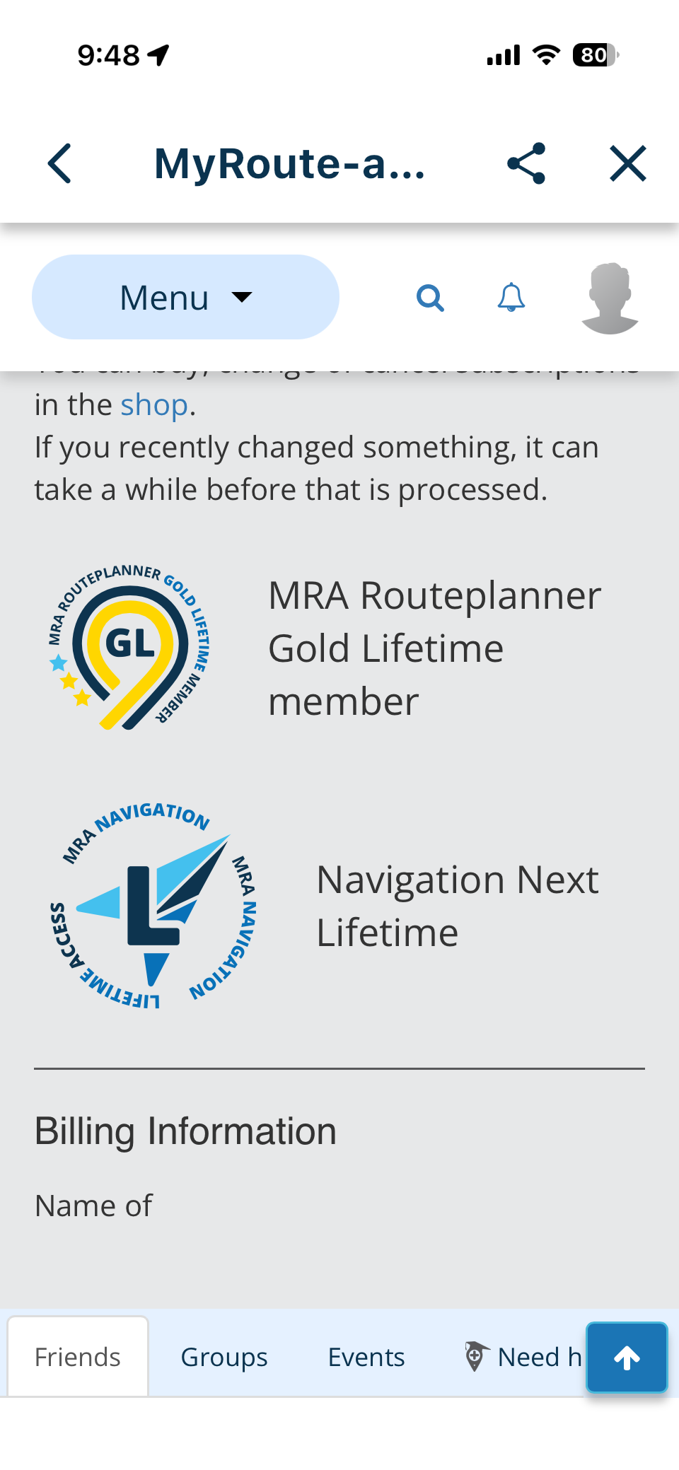

    Iphone 17 - MyRoute-app on the phone shows MRA RoutePlanner GOLD Lifetime member and Navigation Next Lifetime
    How do I get CarPlay to recognize my "Lifetime membership" of Navigation Next?

      Never saw this before. Can you place a screenshot of the menu page, after when you click the profile icon on the mainpage on the top right? It shows the available licenses for you account. I think you need MRA support to sort this.
