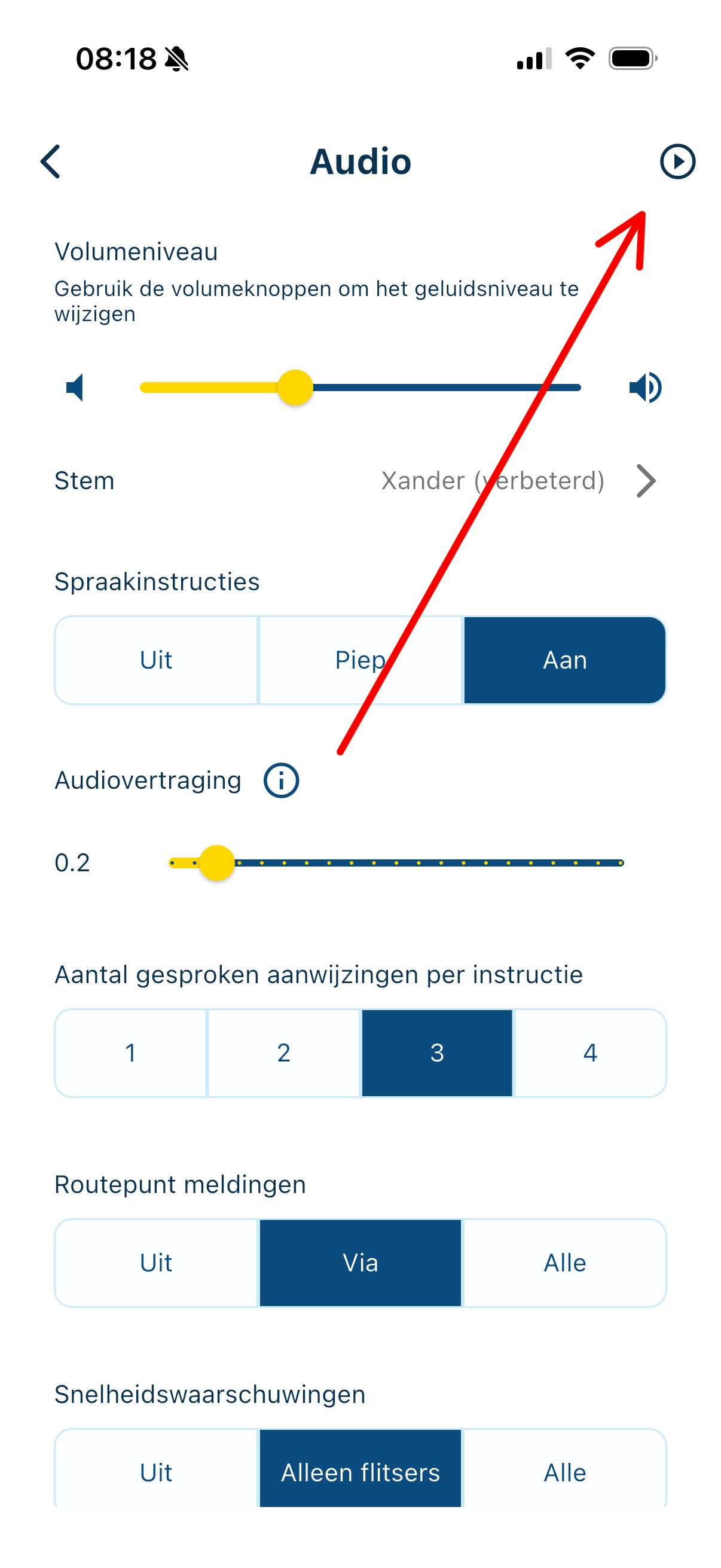

      If audio works through Google Maps but not through MRA, it sounds like a setting in the MRA app may not be configured correctly. Do you hear sound through your headset when you press this?

        Nothing heard when I press that. Works fine when not connected to the SC1
        Not sure how I can alter the App

          It now appears to be working ok. The only change I made was the “input settings” from off to normal.

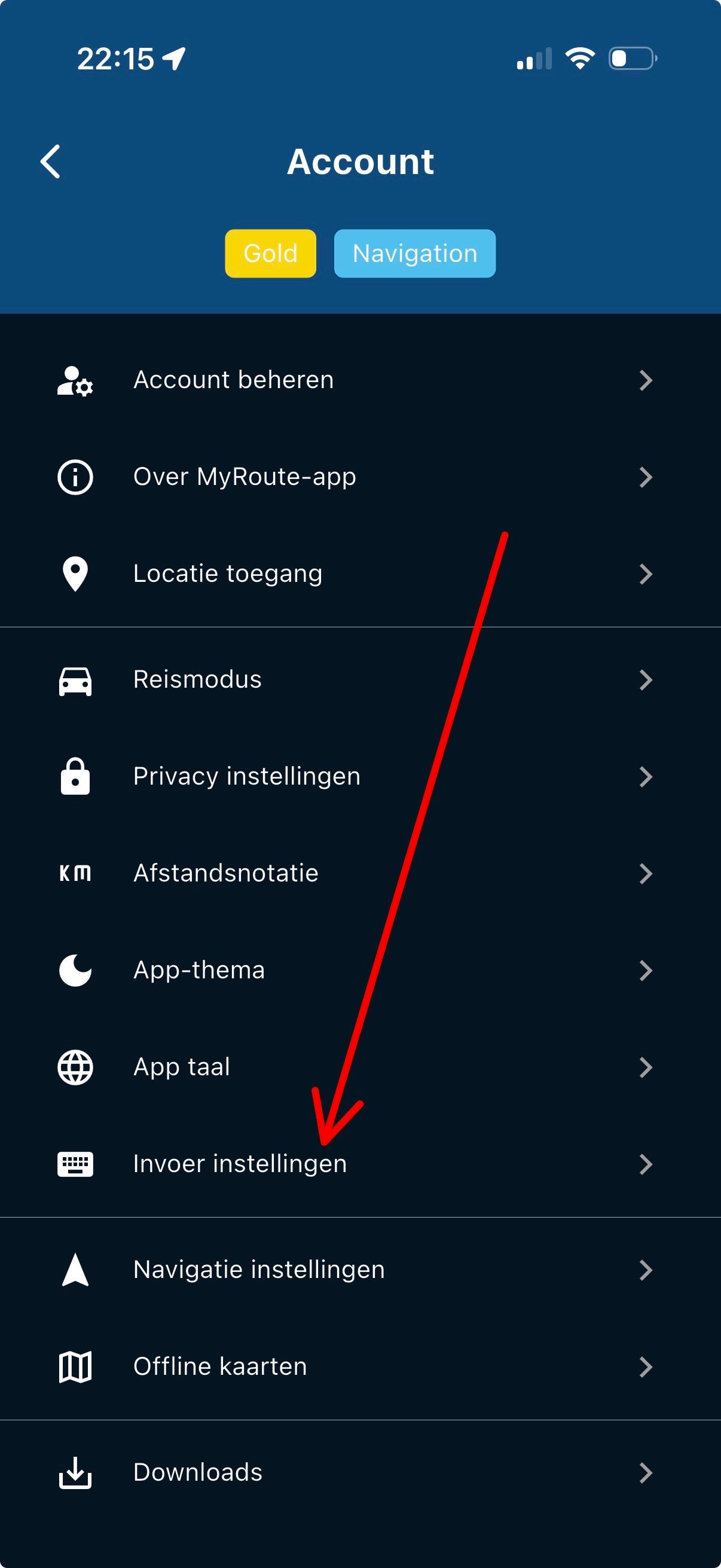

              @Graham-Fairhurst
              Waar zit die instelling? In de MRTA app of in de Schubert SC1 app?

                  Yes, input settings in the MRA app

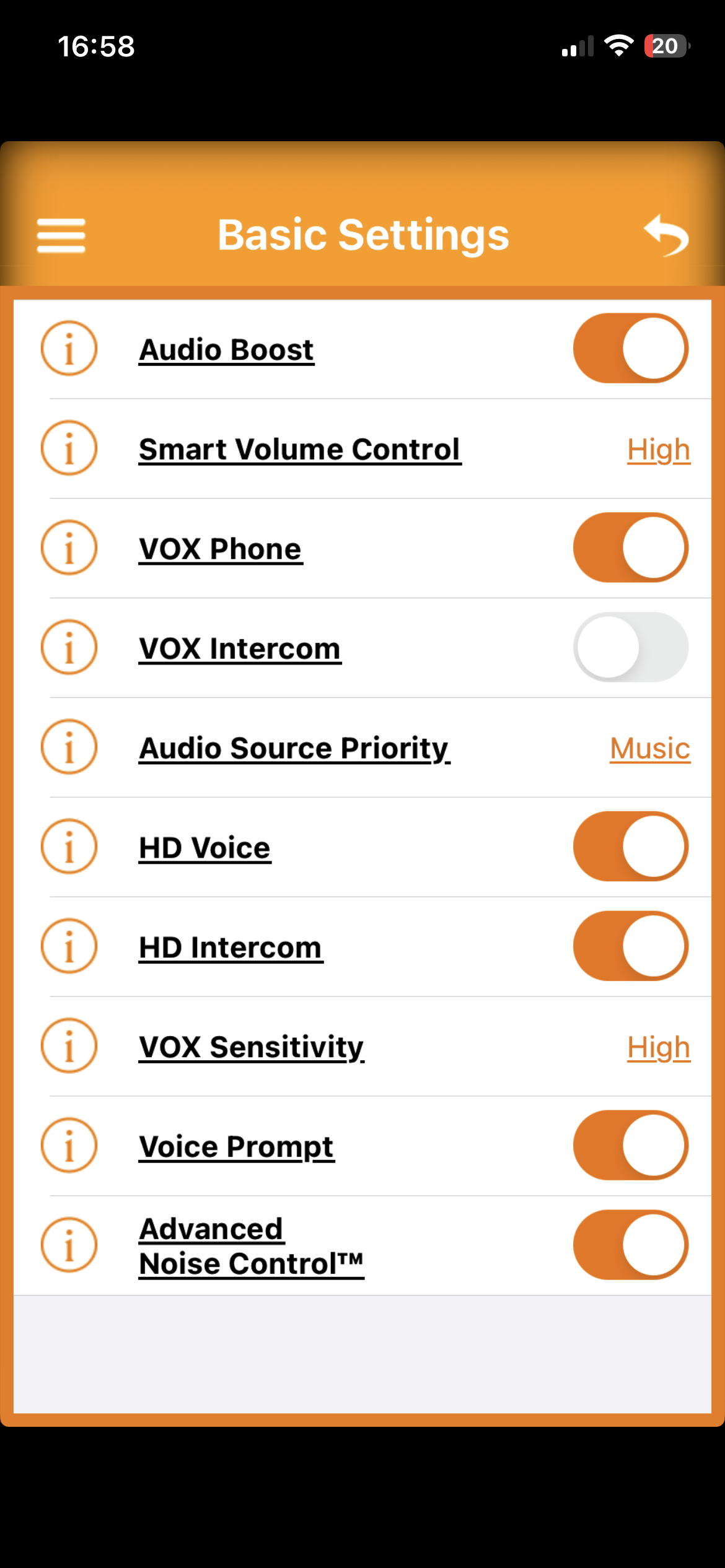

                            @white.mouse I’m not exactly sure which setting it is (possibly Audio Multitasking?), but you can solve this by configuring the headset through the Schuberth app. I have the same headset myself. By the way, this setting is also available on most Sena headsets.

                              Sounds like you have the same problem? I have emailed Schuberth and waiting for a response. I thought I would look at the Schuberth app and see what the options are. I seem to remember there is a priority option? I’ll keep you updated. I would like to sort it out as if I use my TomTom 400 that disconnects the intercom and I have to then reset it, which quite often takes a few attempts

                                I have changed the priority on the Schuberth app from “intercom” to “music” and that appears to have worked. Not yet tried it out on the bike but fingers crossed

                                  Where in the app you can do this? In the Schuberth SC2 app I do not see this option!
                                  • Graham Fairhurst Offline
                                    Graham Fairhurst
                                    #17
                                    On the SC1 settings page “audio source priority”
