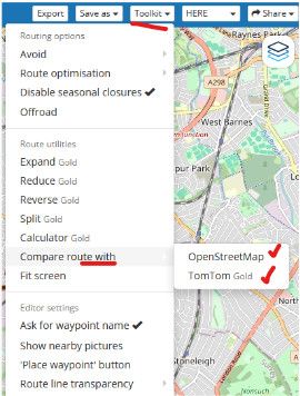

                            @Mike-wiruth as @guzzist suggests use lots of points to constrain the route to the path that you want to take
                            on the web planner you definitely want to be using "Compare" tool to ensure that OpenStreetMap & TomTom also follow the same path that Here is calculating in the MRA web planner
                            if TomTom or OpenStreetMap can find an alternative path you can bet that your XT will also find a different path to what you had planned
                            the XT is using a different path calculator profile to MRA even though they are both using Here maps
                            so any calculation done by the XT is possibly going to be different unless you force (constrain) it to the same path with as many points as it takes
                            & again as @guzzist says you have to make sure the settings you have on the MRA planner match the settings on your XT as closely as you can
                            a rough guide that paths are closely matching is to make sure the mileage for the path in MRA is similar to the path on the XT
                            it is not a perfect check but if the variation is small, chances are more likely the paths are more similar
                            it is a lot of work trying to coral an XT to stick on a path you want to go & ultimately the XT will defeat you
                            you will be taken off your chosen path, I know from bitter experience
