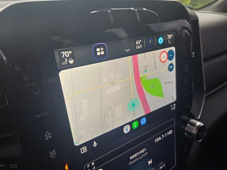

    Hello all, did the upgrade, re logged back in and started driving. First thing I notices is I lost the speed indicator up in the corner of the screen. Still there, just displays "0" all the time! Android phone, Galaxy S26.....20260523_190817.jpg

        what do you mean my pic is crashing app?
          @D-Griffin is I try to open it, my app stands still

            @D-Griffin but now it does 't
            It seems like your device is not receiving any gps data

              OK so being a route expert can you help me? MY GPS on my phone is working properly. All the other map programs work, myrouteapp works fine other than there is no speed indicator anymore. I post this as feed back so if other are having issues they can chime in. I don't even understand what you replied above, sorry but it doesn't make sense to me. The APP never crashes, there is just no speed displayed.
