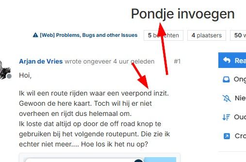

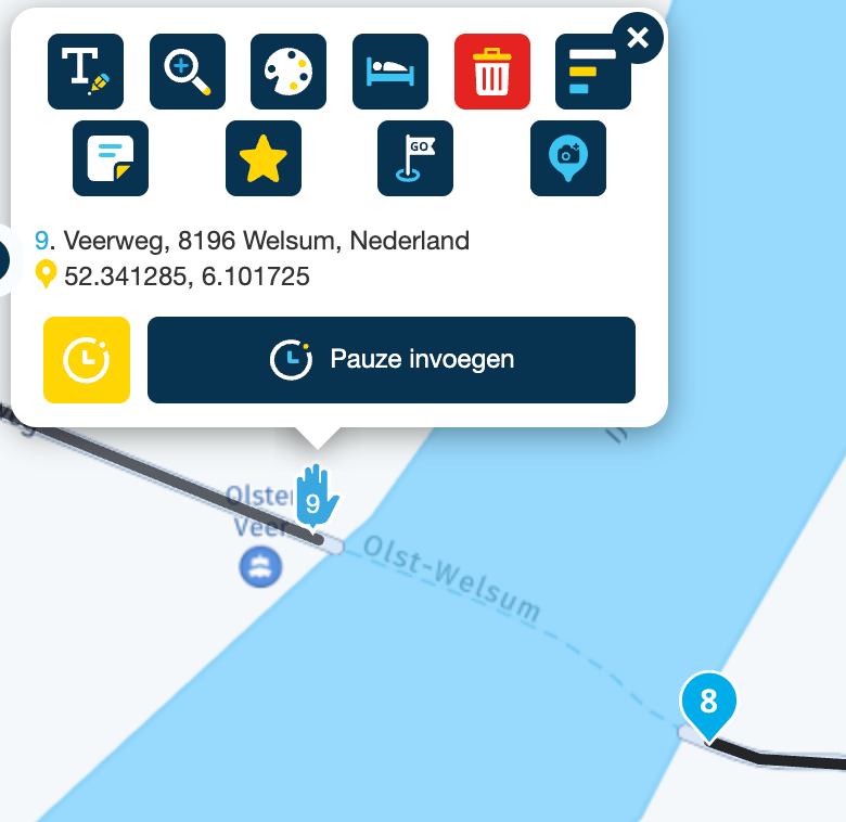

    Hoi,
    Ik wil een route rijden waar een veerpond inzit. Gewoon de here kaart. Toch wil hij er niet overheen en rijdt dus helemaal om.
    Ik loste dat altijd op door de off road knop te gebruiken bij het volgende routepunt. Die zie ik echter niet meer.... Hoe los ik het nu op?Scherm­afbeelding 2026-05-20 om 06.55.30.png

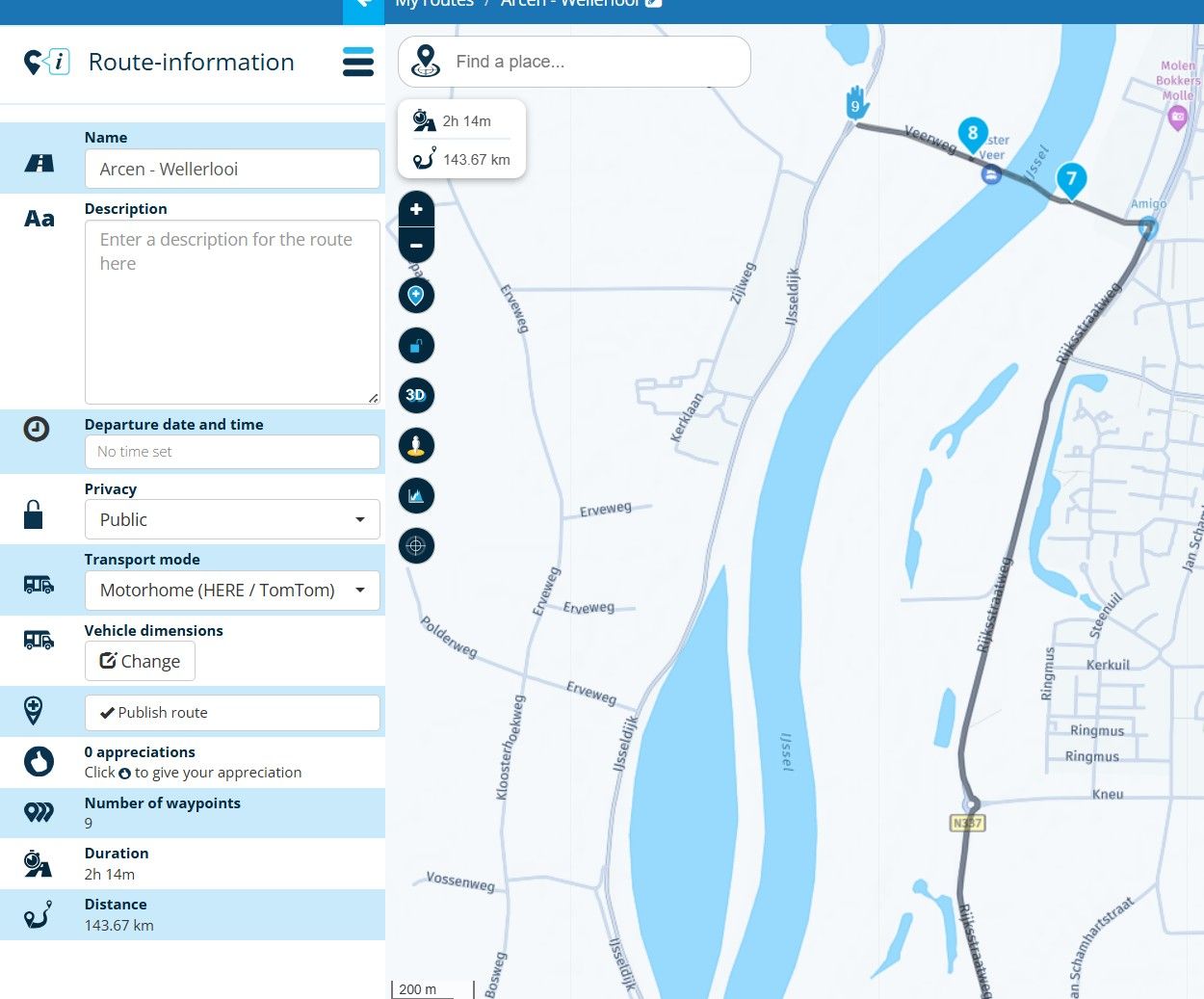

                Change point 9 to a ShapingPoint

                  @Marinus-van-Deudekom @rob-verhoeff @nomko That's not why. It's because he's marked point 9 as a viapoint. To finish, you place point 10, one meter ahead as a viapoint, and that's solved.. Regards.
                    @b0hd1 Nope that's not correct. The Here map will see the crossing taking half an hour and that's why you have to use shortest route, not fastest. The fact that it's a Viapoint is not relevant

                      @Marinus-van-Deudekom But the point is that he wants to use the Ferry. If you set it as a shapingpoint, it will let you use the icon that the teammate mentioned.
                          And when you arrive to the last stop after taking the ferry, you start a new route to follow your travel?
                          OffRoad button is the solution, but this can't be applied on LAST route point (which always is a viaPoint). If your stop is just on destination harbour, add a shapingpoint before it to convert it in NOT the last one, so OffRoad button could be activated and cross water as ferry does.

                              @Arjan-de-Vries, Een VIA punt kan zéker WEL als offroad punt gebruikt worden!
                              Alléén NIET als het het laatste punt is:
                                When using the HERE map, selecting the fastest route optimisation option, the HERE map will calculate the fastest route from point A to point B. If the route from A to B using a bridge takes 40 minutes and it takes 60 minutes using a ferry to get from A to B then HERE will use the fastest option: 40 minutes via roads/bridges while this detoure takes also much more milages.
                                If you set route optimisation to Shortest, the HERE map will calculate the shortest route and not the fastest route. This means that getting from A to B using the ferry has lesser milages than taking the detoure over roads/bridges which takes lesser time than by ferry.
                                So, setting the optimisation option to Shortest will get you cross the river using the ferry.
                                Switching between soft waypoints (waypoint 8 in screenshot of Arjen) or hard waypoint (waypoint 9 in screenshot of Arjen) does not make any difference. Hard waypoints are waypoints you must pass to continue your route.

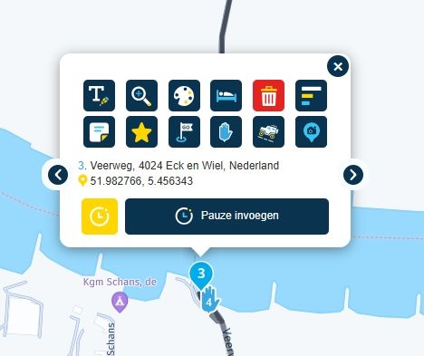

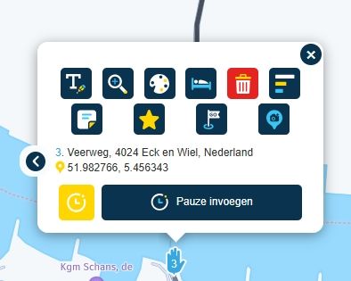

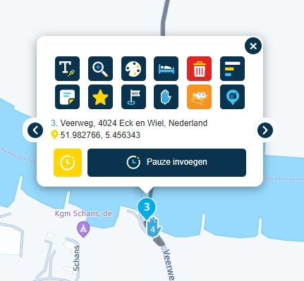

                                  I tried something just for fun;
                                  A route with three points, with the ferry between points 2 and 3. In this case, point 3 is also the endpoint.
                                  Ik heb even iets geprobeerd;
                                  Een route van drie punten met tussen 2 en 3 de veerpont. In dit geval is punt 3 ook het eindpunt.
                                  The route will then take you over the nearest bridge, back to the end point, point 3!
                                  When you select point 3, you'll see that there is no off-road option.
                                  De route wordt dan over de dichtstbijzijnde brug geleid, terug naar het eindpunt, punt 3!
                                  Als je punt 3 oproept, zie je dat je geen Offroad mogelijkheid hebt.
                                  If you insert a new endpoint (point 4) right next to point 3, you’ll have that option again.
                                  Door nu vlak bij punt 3 nog een punt 4 als nieuw eindpunt in te voegen krijg je deze mogelijkheid wel weer.
                                  So if you select "off-road" for point 3, you'll see that the route follows the point perfectly.
                                  En als je nu dus voor punt 3 offroad kiest, dan zie je dat de route netjes over de punt loopt.
                                  Problem solved!
                                  Probleem opgelost!
