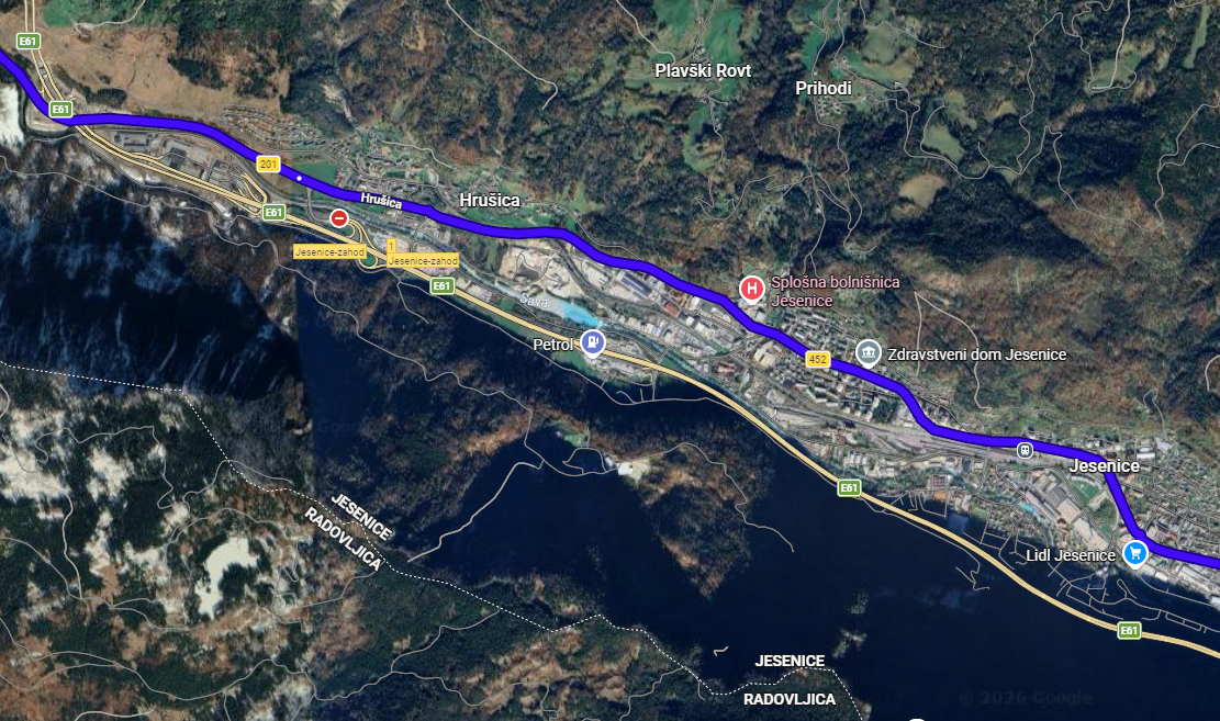

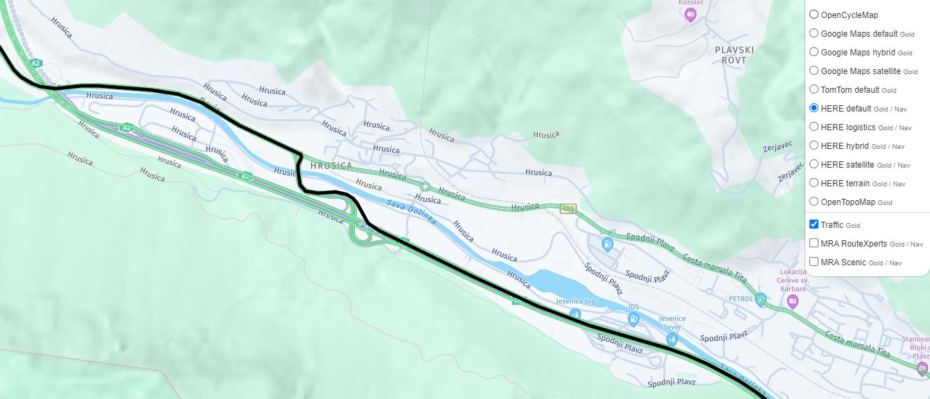

    Hello. I am just wondering if this is an error or something, that is so by-design. I was creating a route with MRA Gold membership, HERE maps and traffic info, and I know for fact, that this highway exit is closed due some constructions work. But MRA doesn't show this. Google maps knows that the exit is closed and put my route on some other exit.
    Does MRA only know traffic when navigating with NEXT?
    Because I am pretty sure that last year the MRA knew that one of the passes in Italy was closed due some work and it didn't let me plan my route there.
    MRA:
    Google maps:

        @Boštjan-Kreutz unfortunately MRA is only as good as the data it is given to work with
        In this case Google & TomTom know & show the closure
        Here does not seem to know about the closure on either HereWeGo or HereMapCreator
        You could report the closure to Here maps at HereMapCreator but whether the map update would make it into MRA before the bridge is reopened I do not know
        Accessing Here's live traffic updates is I believe a paid for service, it is not something that is readily available to the public, so I can't say why the closed bridge is not showing on Here's traffic data

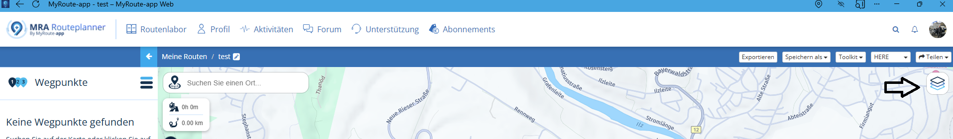

              That’s fine. You can carry on with the route you’ve started, but first you should set the Here map as your default map, if you haven’t already done so.
              The MRA navigation app uses only Here Maps for navigation, so it is important that the map used for planning matches the one used for navigation.Screenshot 2026-04-20 090205.png

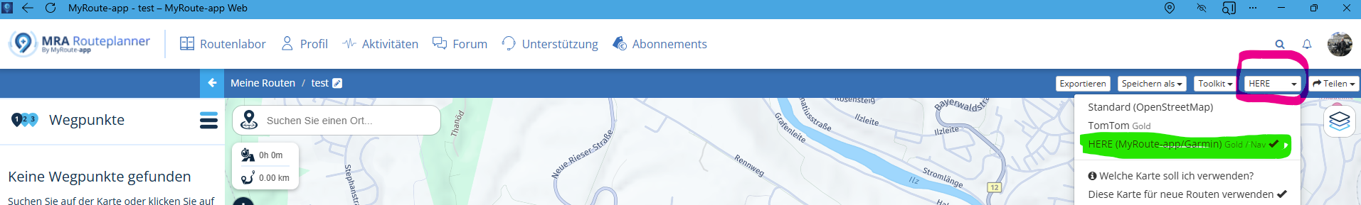

              As not all map providers use exactly the same map data, please note the following!
              If you select a different map here in the layer, you must switch back to the Here map at the end of your planning and place all your waypoints precisely on the road.Screenshot 2026-04-20 091541.png
