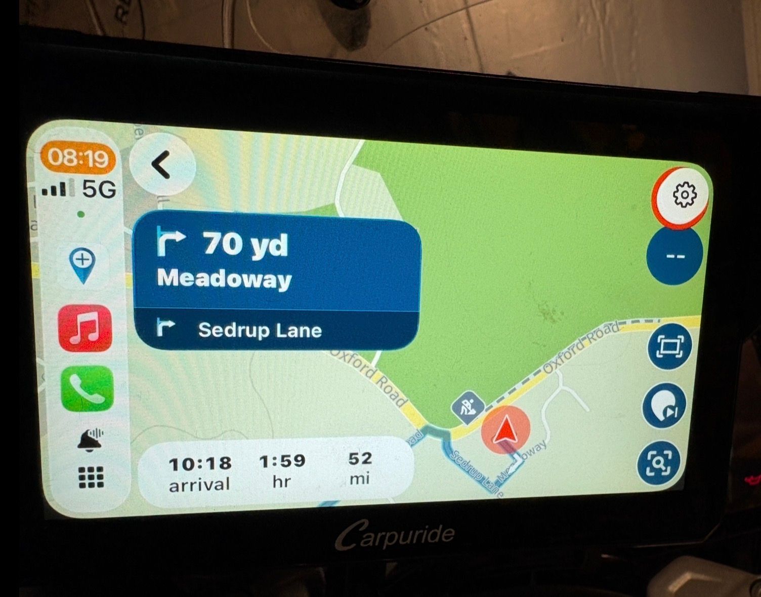

    Hello
    I'm using a carpuride carplay display with MRA Next app, it would be great if you could route to a searched item while on an active route, currently I have to launch google maps and search from there and then allow the re-calculation when I go off route. Example for petrol, food or toilet.

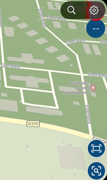

                  @Corjan-Meijerink just tried it, when your on an active route the search button does not exist.
                  • Corjan Meijerink
                    You don't see this while navigating?
                    Then you are navigating a track which indeed does not support adding a stop. This is the same on CP / AA / Phone 🙂

                      @Corjan-Meijerink no, I only see the settings icon, I'm navigating a route.

                        • Corjan Meijerink
                          Then for sure you have "Navigate routes as tracks" enabled or you are driving a route created in OSM / TomTom.
                          Try navigating to a favorite / search result or something like that. Then I am confident a search icon will show.
                          • Alliston
                            Alliston
                            Alliston
                            That fixed it, thanks Corjan
