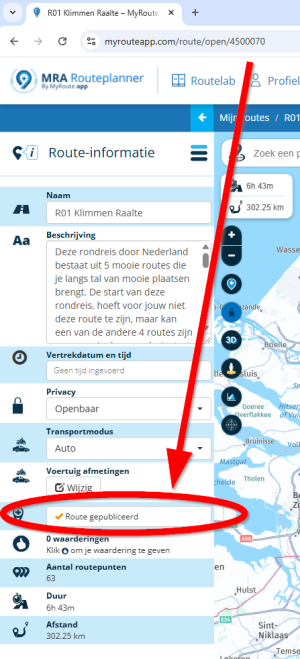

                      @Tony-Edwards-0, Check the routes that don't appear in your embedded library for this parameter!

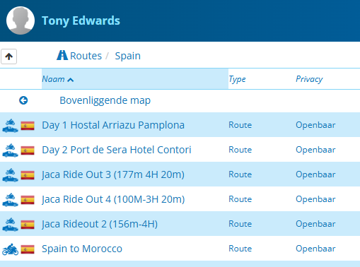

                        #16
                        Hi Con,
                        Yes I have checked this and they are all ticked orange as displayed. I did try adding an addition route this afternoon and that did not show.???? I then embedded routes from my Library for Norway and Sweden which I do not normally do until I have completed them (June 2026 adventure).
                        When doing this I noticed that some routes I have set the mode of travel for motorbike (which did not show) and other the mode was set to car (which do show) I then amended all the routes mode to car, and TA-DAH they now appear πŸ˜€ I am hoping this is now fixed πŸ˜€πŸ‘

                              #19
                              @Tony-Edwards-0, Ues, I can indeed confirm that Motorcycle routes are not published correctly.

                                #20
                                @Con-Hennekens said in Embedded Routes:
                                It a bug already logged last year and known by the MRA team: routes with motorcycle profile are not visible when setting to public.

                                    #22
                                    Devs are aware indeed. I doubt this will be fixed in the current web planner, but who knows.
                                    I believe Corjan mentioned along the way it will not be updated in this version.
                                    Just do not use the motor profile as it does not differ from the Auto profile when calculation I am told.
