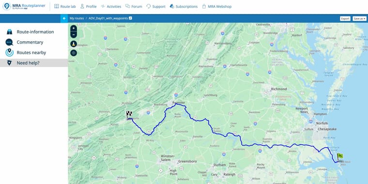

                @Brian-McG this is great thanks Brian. I removed all the NSO attributes from the tags (editor tool issue) and that cleared up the waypoints naming and description issues for me as well (thanks to you), but when I click to see tracklogs (I assume this is where it would be?) the track did not get imported.
                Based on what I understand of MRA workflow, what I am trying to achieve now is uploading the file with the track and waypoints into one route. Convert the track into a route. That gives me the shapoing points I need plus the primary waypoints for stops and photo opportunities. I would be fine uploading them as two separate files but I can't upload the waypoints into an existing route correct?

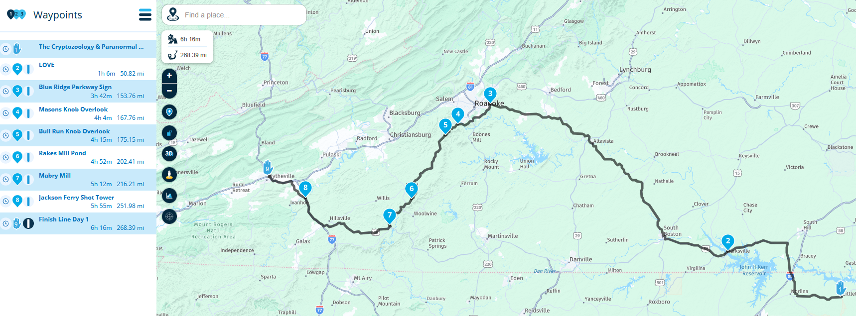

                If I try to import the file as a Route-Track, then the waypoints don't appear importing that way. I'm not sure why there are two different import methods. I do have some gpx files that have waypoints, routes and tracks all in the same file.

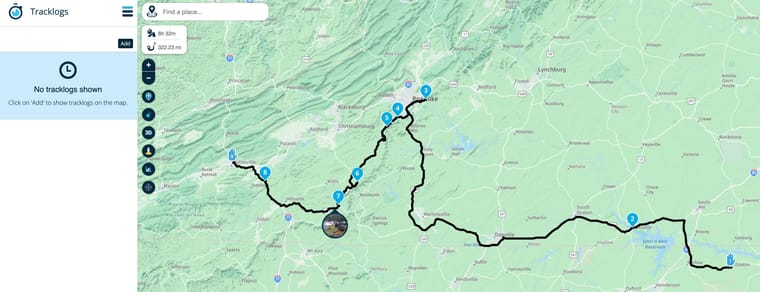

                Next I tried to just import the tracks by itself, convert it to a route and see if I could find a way to import those Primary 9 waypoints into this new route created from the track. No deal. It looks like you can only do an import into a new route and you can't select the location where the imported file will go to (subfolder).
