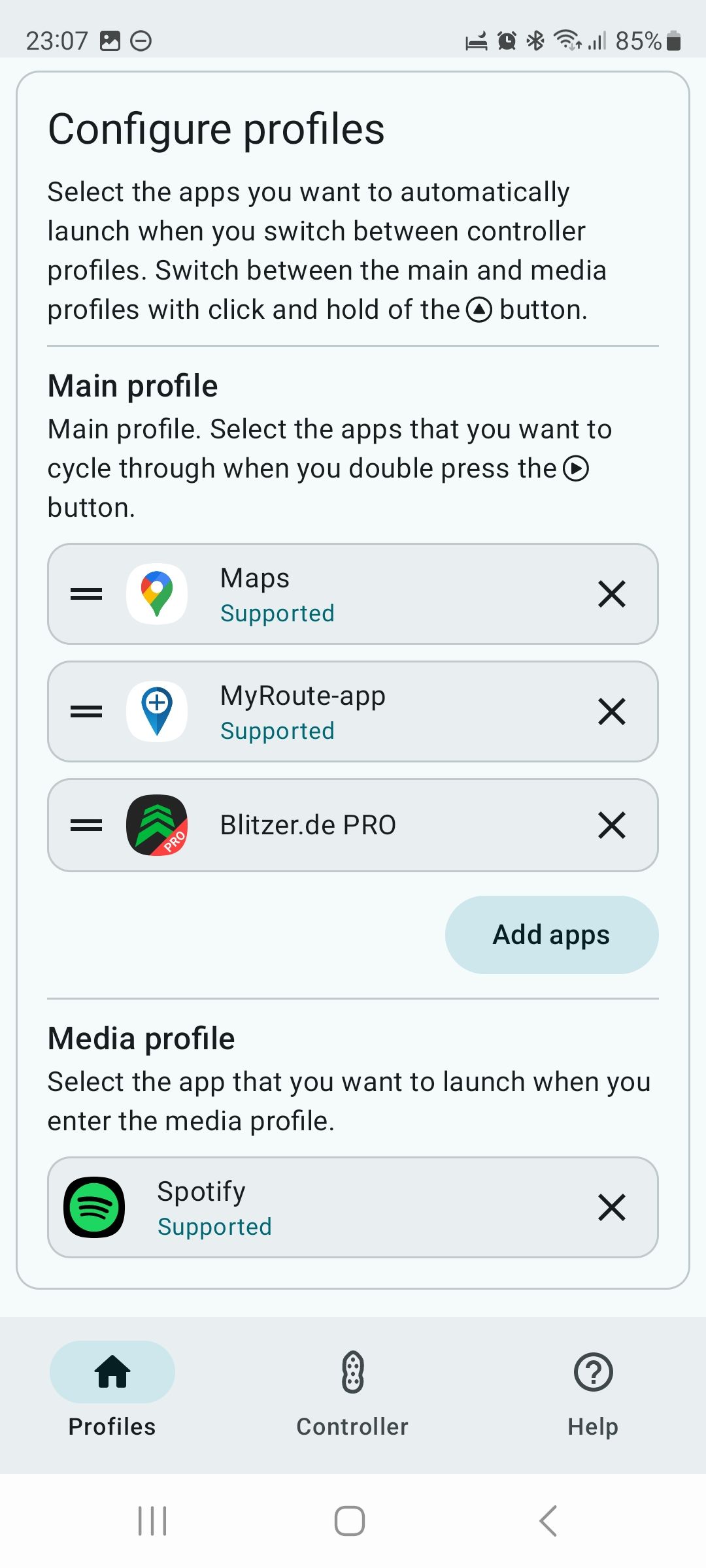

          Here you can see.
          DC right you can switch to maps, Blitzer app

            What if you remove those other apps on the DC right? Will it then send the skip command to MRA as it should?

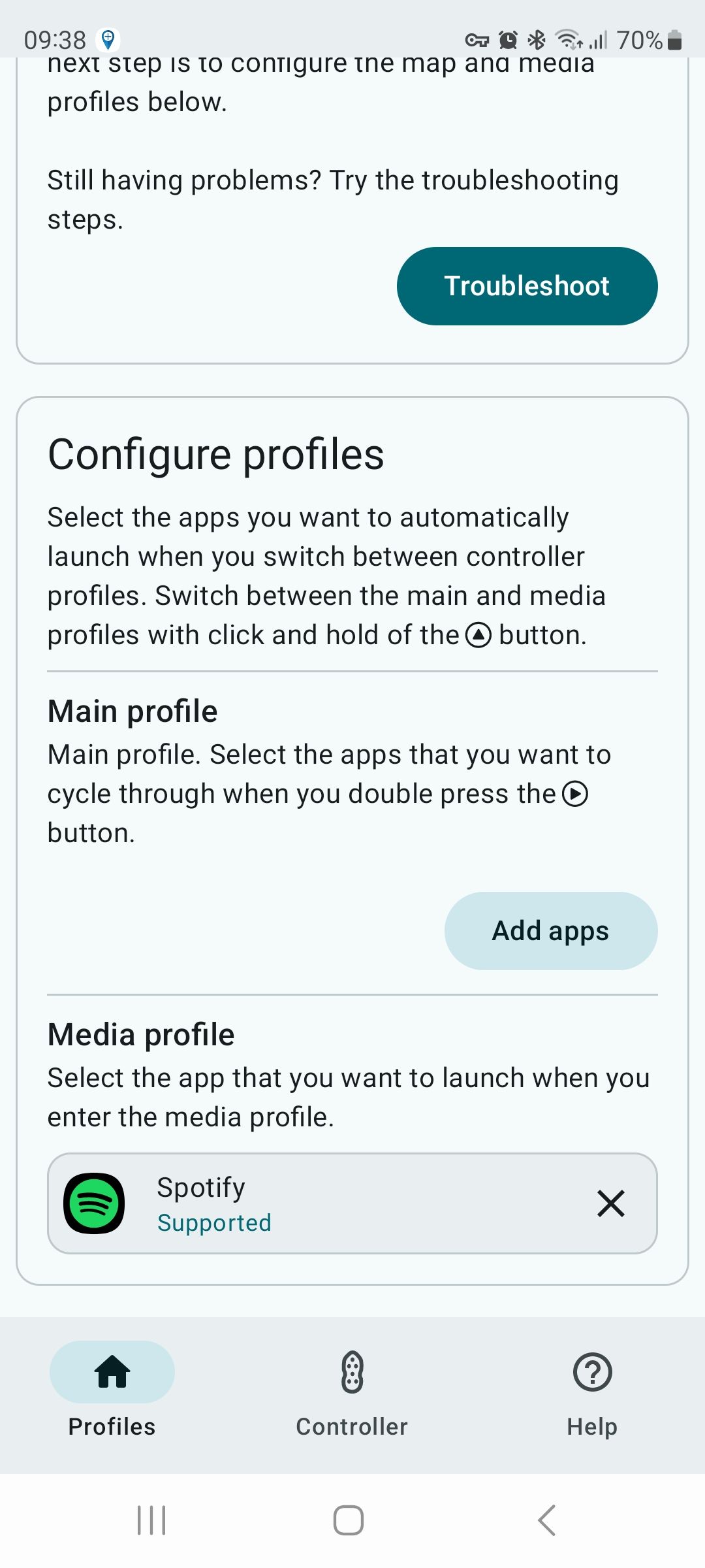

              Hello Corjan,
              I tested it. And YES I am now able to skip the waypoints.
              So there has no app to be in the main profile of remotek app. The Media Profile is not affected. I am able zu switch and controlling spotify app.
              If you selected MRA app it would not be able to skip waypoint
