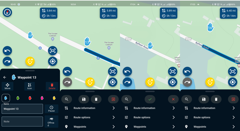

    There are hundreds of comments in the forum about how points MUST be placed accurately on the road
    I don't 100% agree with this but............ when I place a point I want it to be where I place it
    With the new app planner there seems to be some offset when a point is placed, it is particularly obvious when the "Move" point tool is used in the app
    I have tried zoomed in the error/offset is still present just the scale of the error changes,
    the same happens on multiple device types
    The first pictures are where I have positioned the point, the second after I have pressed the green or yellow accept button. Point 13 was done at maximum zoom, point 14 zoomed out a bit

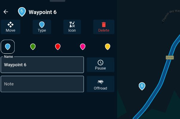

    Point 6 on a different device was placed above the road with the Move function & when accepted via the yellow place button
    BlackView BV7100, Android 12

            @Corjan-Meijerink I have always agreed minor offsets with the positioning of points has never been a problem & fully get it that the route line is what is important
            However I would not catagorise the offsets that I am seeing in the new App Planner at some zoom levels as "minor"
            At some zoom levels the points end up 10's & 10's of meters from the road but that is not the problem,
            the issue is the points are not being placed where they are intended
            so now each time when placing a point, I have to select a very high zoom level want to minimise the offset,
            it just makes using the App Planner a lot more work to use

                @Brian-McG said in Waypoint Position Offset:
                Yes indeed, but that's what Corjan meant as well. There is an offset on placing waypoints in the app-planner, mainly when held in landscape orientation, and dependent on the resolution of the device. It is being investigated.
