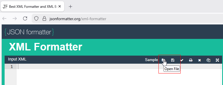

            You can see the contents of a GPX file without having to load it into MRA. This will also allow you to understand the internal structure of the file and perhaps, why things work they way they do. The internal format of a GPX file is basically XML so you can use an XML formatter to easily see what's inside. I use https://jsonformatter.org/xml-formatter which is one of the options from the https://codebeautify.org/ site.

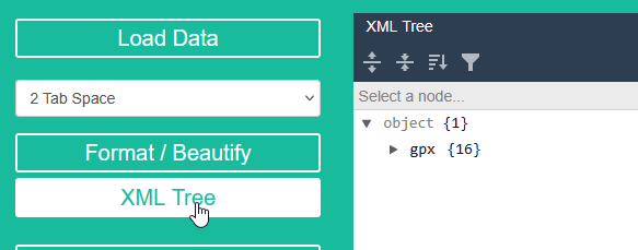

            On the formatter, use the Open File option, then navigate to and select your GPX file:
            The input XML is shown on the left side panel and a formatted view is on the right. You can scroll up and down that if you wish but it can help further if you use the XML Tree function which will give you a collapsed view of the file:
            You can then use the expand/collapse arrows to gradually expand the elements to see what is there.

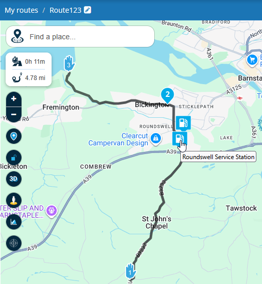

            I created a small sample route that has three route points, 2 via points (hand symbols) at the start and end of the route and one shaping point (number 2) part way along. I have also added two POI fuel stations and given them names which can been seen when you hover a mouse pointer over them.

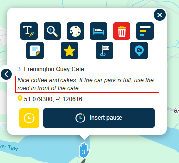

            I added a note to the final point (number 3) which can be seen on when you click on that point:

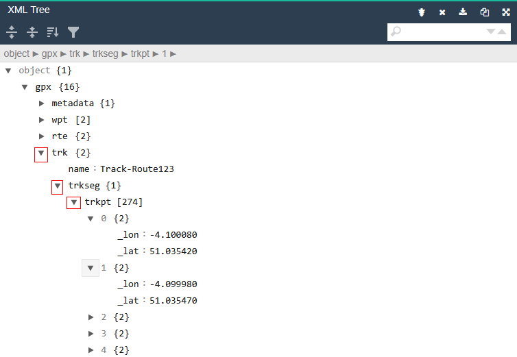

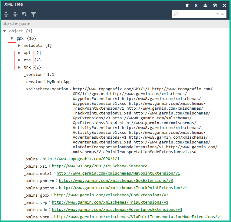

            Going back to the XML tree, we can see that in this example there are 16 items under gpx. If we click the arrow to expand it, we see:
            The metadata element contains the date and time the route was saved (not shown here) but probably the most interesting elements are the next three which are wpt, rte and trk.

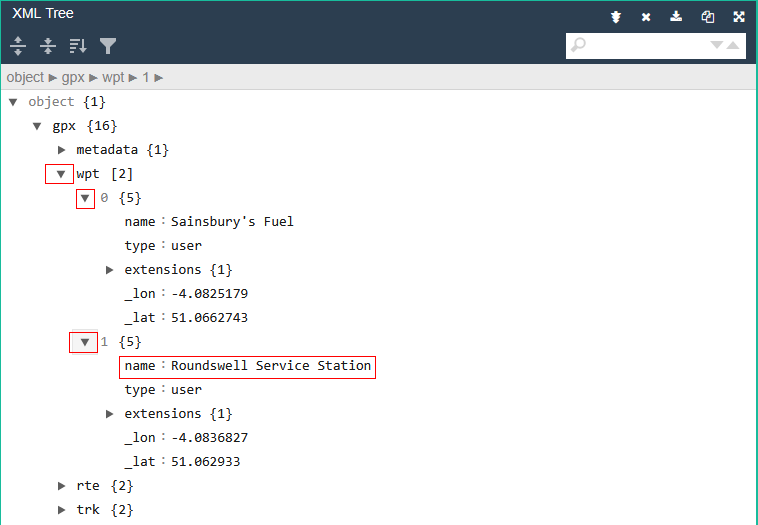

            The wpt elements contain the POI details that were added to the route including the lat & long coordinates and the names given to those points:

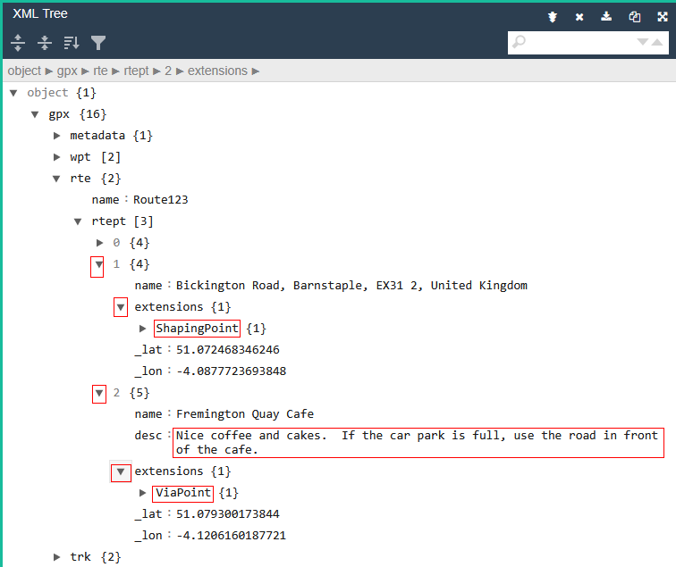

            The rte element contains the route name plus a rtept (Route Point) element for each point on the route. In this case there are 3, and they are numbered 0, 1 and 2.

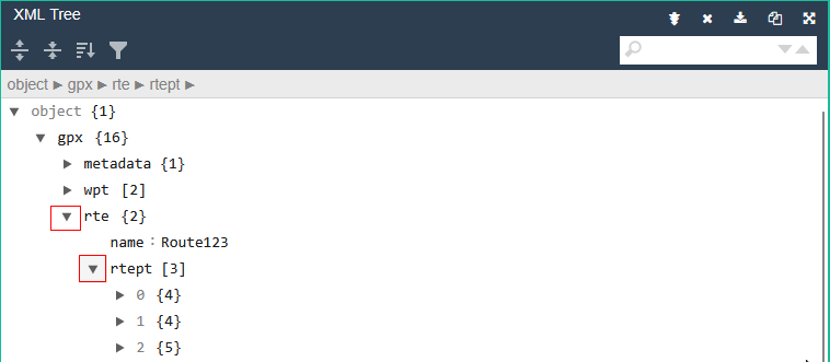

            The following image shows expanded route points 1 and 2 plus the extensions element within each of those. We can see the name plus lat & long coordinates for each point. We can also see if the point is defined as a ShapingPoint or ViaPoint. The note that was added to the final point is also shown and MRA Navigation can read that out to you as you approach it (other navigation devices also have this capability).
            The trk element contains the track name and the track segment of the file. Expanding the trkseg element shows that there are 274 track points in this example route that is less than 5 miles long. Each trkpt is a lat & long coordinate from a point on the line shown on the map when you view your route.
            The distance between each trkpt can be measured in tens of metres/yards so for a long route, there can be thousands of them.
