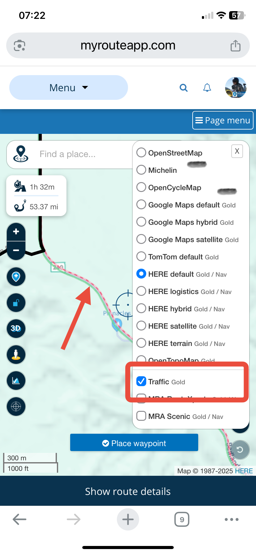

      @Jeff-Molldrem By using the traffic overlay map I can see that the HERE planning map has marked the Badlands Loop Scenic Highway as being closed (red/white line). If you turn on Disable Seasonal Closures in the toolkit you can continue planning your route.

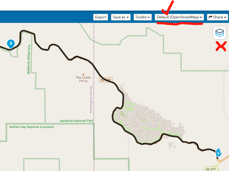

        @Jeff-Molldrem your main issue is as @Nick-Carthew says the Here routing is being prevented by the Here map data showing the road as closed/under construction
        However I think you may be have a small missunderstanding of how the routing is calculated within MRA
        I have changed the route to other formats (Openstreet, Opencycle, TomTom, Google and Here) and they all do the same. I normally use HERE Default (Gold).
        Changing the "format" as you have described is what people refer to as changing the "map overlay"
        The "map overlay" is just a pretty picture of where the roads are, the "map overlay" has no effect on the route that the system calculates

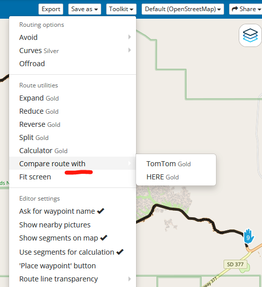

        If you want to compare the different routing algorithms from Here, TomTom or Openstreetmap you need to change the routing calculator
        as you can see when the routing calculator is set to OpenStreetMap it routes through the Badlands with no problems, its the same for TomTom
        You could also use the Toolkit "Compare" function to show the different paths each routing algorithm will take

          Thanks for the response. I will have to Keep that Display traffic option in mind. I usually look at google maps or the state road construction project websites as I am making routes. I did click it but it wasn't showing anything even when I zoomed in. I just tried it again and it took a little for the info to appear but as I was scrolling around the map more and more of the road was showing under construction/closed.
