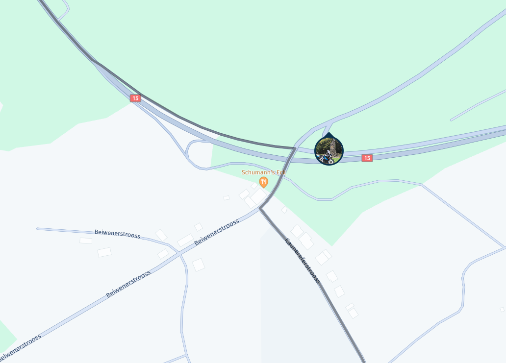

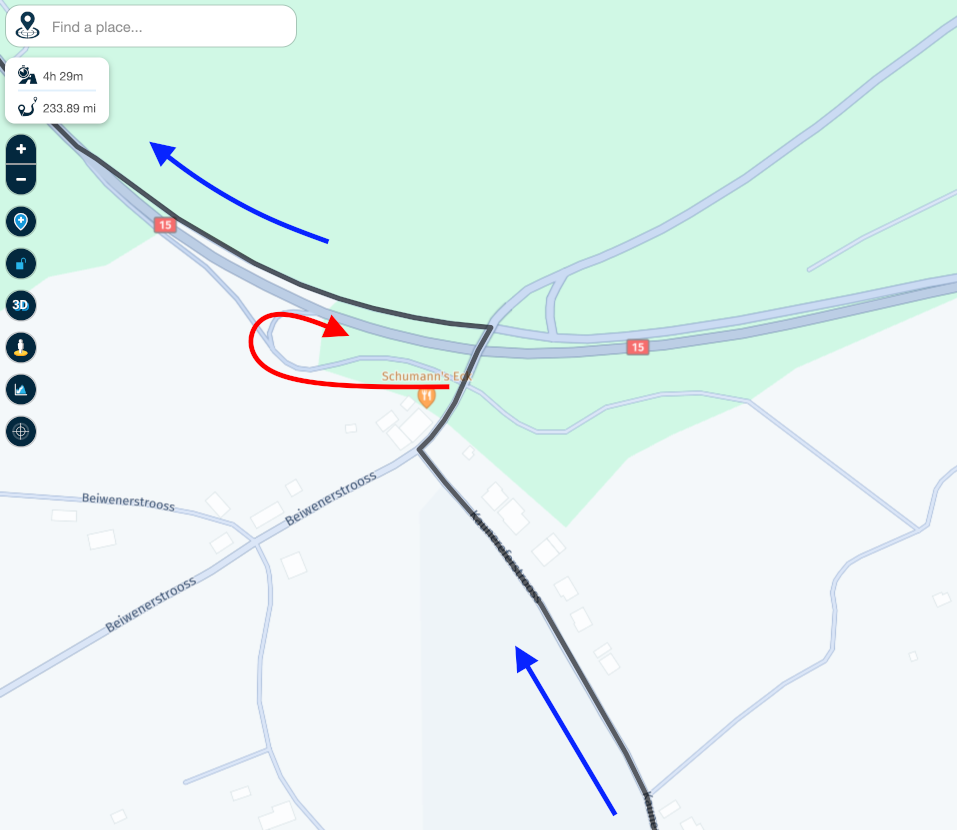

    I was using MRA today and received what I believe was an incorrect instruction.
    Is there a way to recreate the route instructions so I can check if it was human error or a data/machine error?
    If it is an error who do I report it to? MRA or HERE?
    For interest it was just north of Nothum, Luxembourg. The instruction was:
    • turn right and then take the first left
    The instruction should have been take second left, (follow the top blue arrow), but I went first left as instructed (red arrow). Not a disaster, but quite irritating at the time since it is a dual carrageway at that point.

                  hi @richtea999 When I simulate your route & get to the junction where you have the issue, I think the voice instructions can easily lead to a bit of confusion
                  I have the app set to repeat the voice instructions 3 times
                  For the first 2 sets of voice instructions it says "Turn right on to Baywener street & then turn left", it does not say first or second
                  The third repetion of the instructions says "Turn right onto Baywener street & then turn left towards Bastonge"
                  So the only way to know which way to really go is to look at the app map or if you heard the third instruction follow the sign for Bastonge

                    @Brian-McG Ah, good work, Brian!
                    I only use 2 voice prompts (to minimise distractions) so that may well be the problem.
                    I have changed to 3 prompts.
