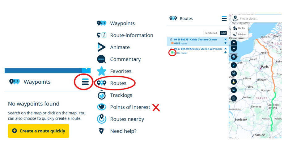

      Hi @Steve-25 if you mean something like this, then yes but it is limited to 20 routes
      so it is useful to show a whole trip but not your complete library of rides ever done

          Hi @Steve-25 this is just a way to display multiple routes OR tracks in one map view
          I use it to show old routes as I am creating a new route so I can wee where I have been in the past & stitch together a new improved route
          You need to start a new route then go the the 3 bar menu next to Waypoints
          You can then select either Routes or Tracklogs, navigate to a folder on MRA where you have stored the route/tracklog you want to add
          You can then change the colours using the colour picker
          It is necessary to add at least 1 waypoint or Point of Interest to the map to give the database somewhere to locate/fix/save the route. I tend to add multiple POI's such as the hotels at the end of each day
          BlackView BV7100, Android 12

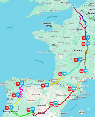

              A concrete example of the final result
