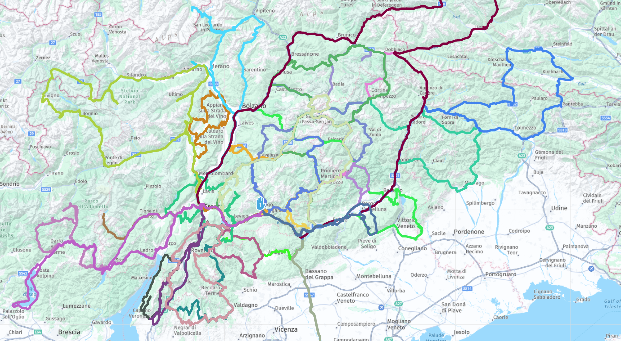

    Hi all, I've recently learned through this helpful forum that I can save a route as a GPX file and upload it as a track so I can see a large route without the waypoints blocking the view - excellent. Is it possible to overlay multiple routes (using different colours would be ideal) onto a single saveable map in the same way (no waypoints) - would like to be able to see all trips I've done consolidated onto one map. Do I repeat the same process for all routes?

      Hi @Steve-25 if you mean something like this, then yes but it is limited to 20 routes
      so it is useful to show a whole trip but not your complete library of rides ever done

          Hi @Steve-25 this is just a way to display multiple routes OR tracks in one map view
          I use it to show old routes as I am creating a new route so I can wee where I have been in the past & stitch together a new improved route
          You need to start a new route then go the the 3 bar menu next to Waypoints
          You can then select either Routes or Tracklogs, navigate to a folder on MRA where you have stored the route/tracklog you want to add
          You can then change the colours using the colour picker
          It is necessary to add at least 1 waypoint or Point of Interest to the map to give the database somewhere to locate/fix/save the route. I tend to add multiple POI's such as the hotels at the end of each day

            @Steve-25 said in Overlay Multiple Routes:
            ...is the final solution restricetd to a number of waypoints?
            Not sure, what you mean as "waypoint"?
            As far I know a route can contain up to 200 routepoints. (points which are used to calculate the route)
            I don't know about limitations for way points (points of interest - only an icon on map, not necessarily used in route calculation)
            If you use the method, @Brian-McG has explained, only the routepoints of the first route will be populated in this view. The other added routes (or tracks) will be populated simply as line; without routepoints.
            Nothing is impossible ;-)

              A concrete example of the final result

                Apologies for the tardy response. Thanks to all of you for your input. This thread has given me exactly what I needed. Steve
