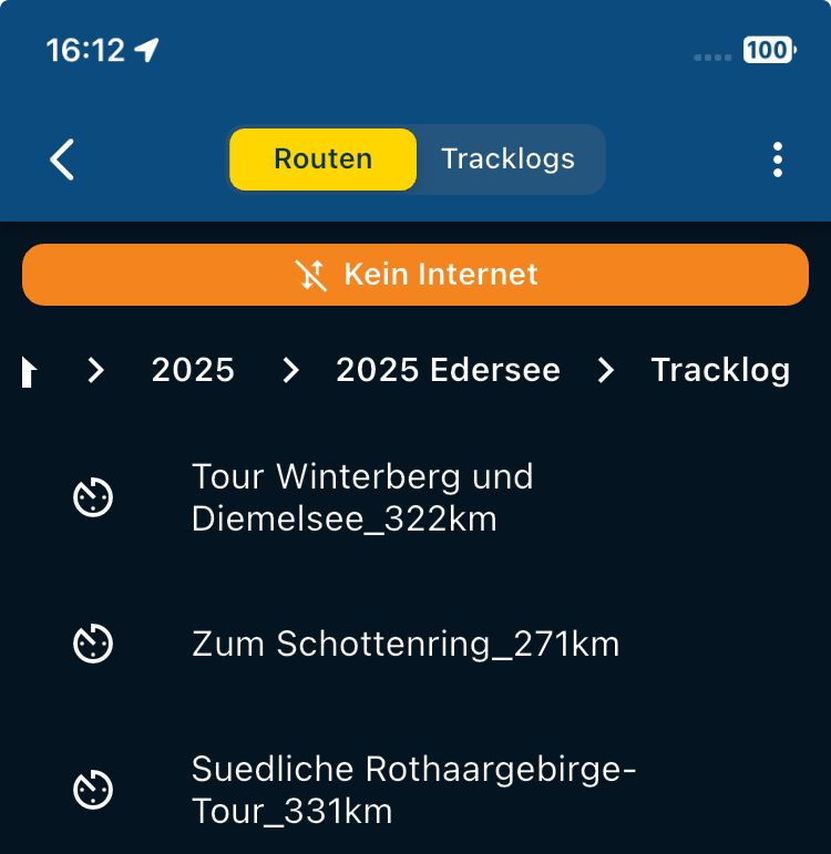

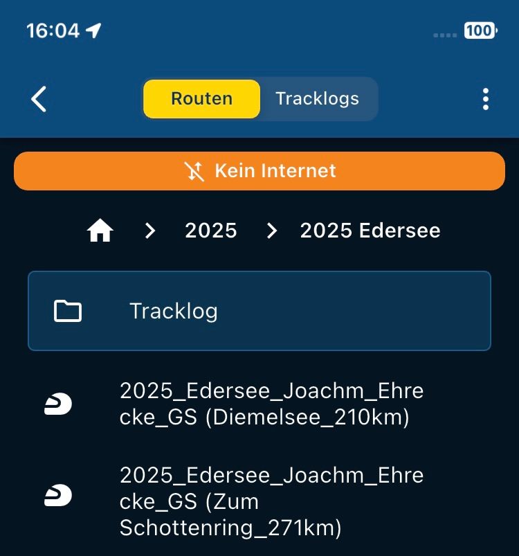

        There's a good workaround, as the tracklog folder isn't displayed when offline.
        Simply copy the important tracklogs into a subfolder under Routes, then you can use them offline as well.
        See 2025 Edersee / Routes and the subfolders there.
        • Helmet symbol = Motorcycle mode
        • Circular pointer symbol = Track
        Mann kann sich gut helfen da der Tracklog Ordner bei Offline nicht angezeigt wird.
        Einfach die wichtigen Tracklogs unter Routen in einen Unterordner kopieren dann kann man diese auch Offline nutzen.
        s. 2025 Edersee / Routen und dort Unterordner .
        • Symbol Helm = Motorrad Modus
        • Symbol KreisZeiger = Track
        One folder deeper / Ein Ordner tiefer /

                  @Guzzist, tracks you get for navigation purposes are usually routetracks, not tracklogs. The difference is in how they were created. A routetrack is generated from a pre-planned route, a tracklog is recorded during riding, and therefore has all kind of quirks you don't want while navigating it.
                  @Con-Hennekens thank our for explanation. But "tracklog" or "routetrack" are only a naming conventions inside MRA. In the gpx file there is clearly differentiated between a route "<rte>" or a track "<trk>".
                  Outside MRA, tracks can be record (with all kind of quirks you don't want, while navigating it) or created directly as track by several tools (without quirks).
                  The best answer to my question would be: if receiving a gpx file with only a track <trk> in - and you want to use it by MyRoute-App to drive along in offline modus - upload into MRA as "routetrack" in section "Routes" and let it synch.
                  By this and just then, it will be synched as track to mobile phone - as long as you are online. Just afterwards you can see and open it also offline (pre download necessary offline maps is contition too).
                  The trick is to know, to upload such a track not as tracklog into section "Tracklogs" - but as routetrack into section "Routes".
