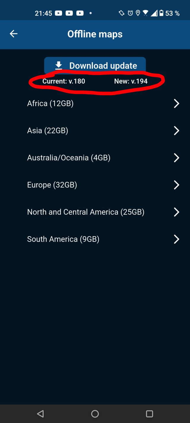

      I don't feel comfortable on long journeys either. Of course, I prepare everything in advance – including downloading relevant offline maps.
      But how am I supposed to know if updates are available for some maps during the trip?
      See screenshot: it shows that an update is available. But when you tap on it, a complete download starts! I don't want that when I'm abroad (possibly using mobile data)!
      It would be enough to just update the necessary map. But how am I supposed to know if this is the one that needs to be updated is in the update bunch?
      An icon for this would be really helpful!

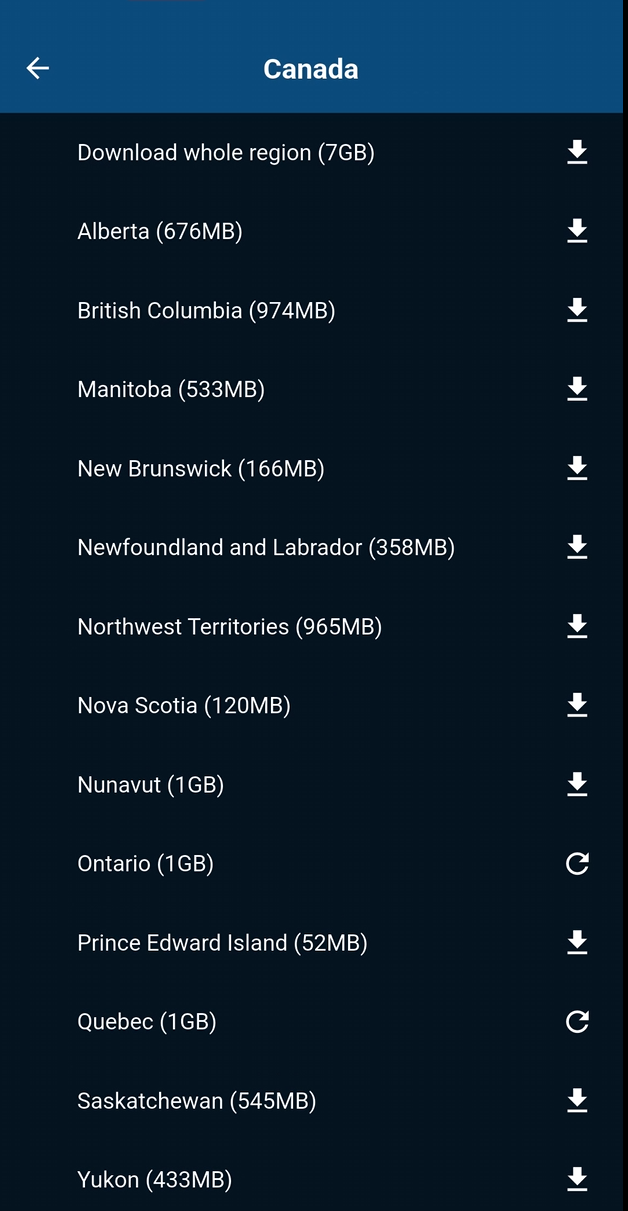

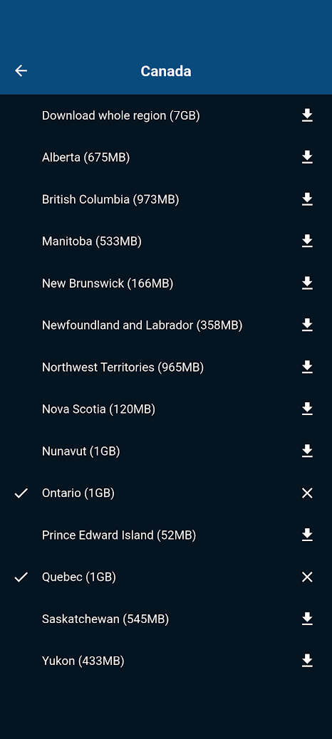

                So just an update on this thread to anyone following.
                It appears that there was/is an odd glitch in the offline map download and update for MRA.
                I had downloaded the correct regions (for me that was Ontario and Quebec Canada) and had used the update map button at the top of the offline maps page which said it would auto-update any downloaded regions. Looking closer, both regions that had been downloaded had the circle reload icon beside them (see screenshot). In this state, offline navigation does not work.
                I clicked the reload button for both regions and they now have a checkmark to the left of the region name. NOW offline navigation works. Today maps version 195 came out and I updated both maps using the same button that appears at the top of the offline maps page. Today it correctly updated the maps (checkmarks beside the region name).
                So it looks like the issue isn't an incorrect version of the offline maps, it's that the update tool showed the regions being updated but actually put them in a state where MRA would not use them.
                Not sure if this glitch has been fixed permanently but it's best to confirm your offline maps have that checkmark next to the region before leaving on a trip. ...and have your Google Map region downloaded for safety.

                    @Paul-Steinberg, yes, the reload circle indicates your previous map-update was interrupted. Therefore I always check my offline maps after a map update. I found myself having this situation when my phone drops to standby while downloading maps. If you press the reload button it will resume the download where it left off. This situation is known by devs, but given the very little messages about it in this forum, it was thought to be exemplary. Maybe that will change now 😉
                      Well, today I had the same problem!
                      Yesterday, I updated the offline maps to version 194, which went smoothly and completely automatically after clicking the update button.
                      Today, after reading the above, I tried again to update to version 195, and it turned out that when the screen saver kicks in, the automatic update stops. If you then try to open the screen again, you get a map projected across the entire screen, with the update information still visible at the bottom of the screen if you look closely.
                      You can even scroll up and down the list. Unfortunately, I was unable to get rid of the map other than by stopping MRA!
                      If you look afterwards, you will see that the download of the maps has stopped and you will have to re-restart it manually.
