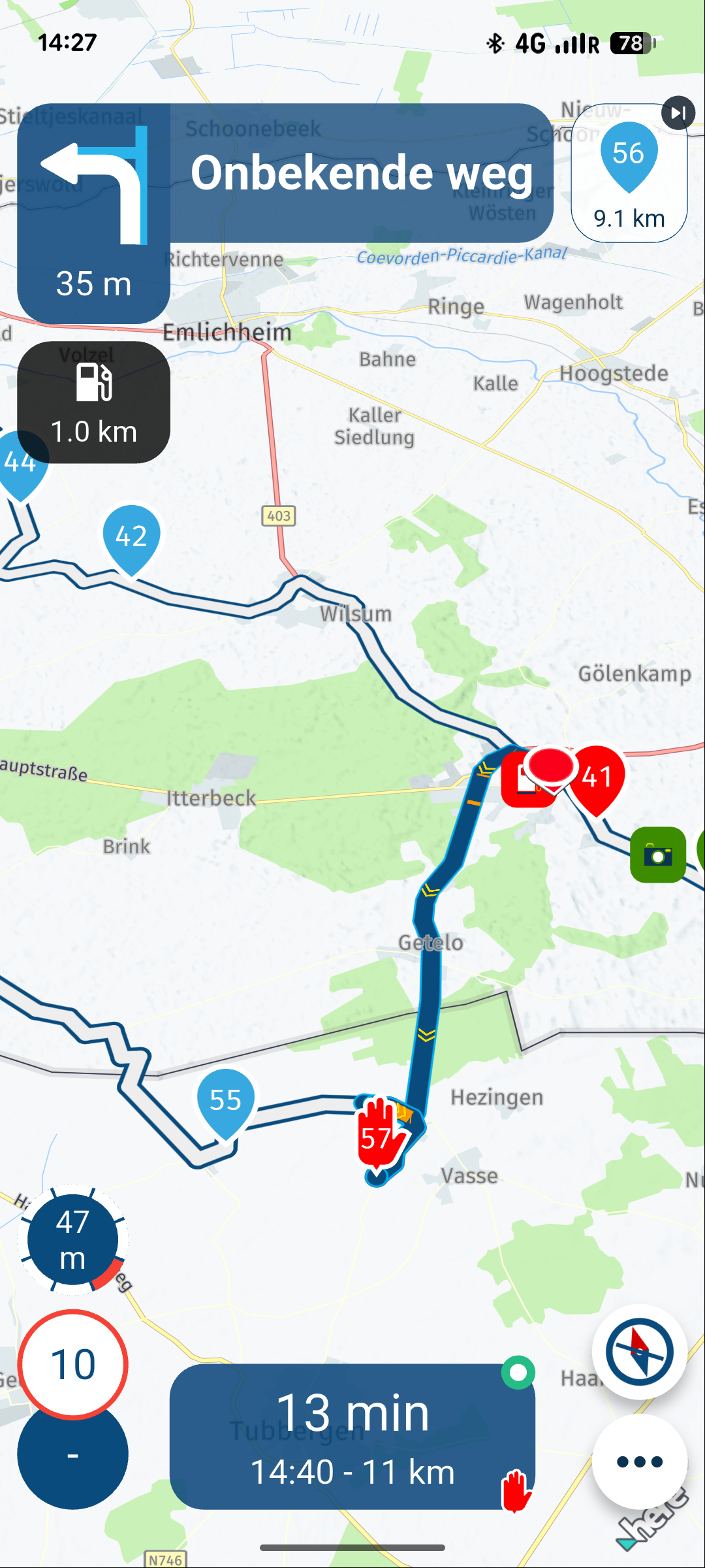

                      Today i rode the route again. Just to see if the same problem happens again. And it did. Same place same result.
                      I lost cell coverage and approx 500 meters later, point 42 was skipped to point 56.
                      See the result in the screenshot below
                            Approx. at point 1 i lost my cell coverage.
                            At point 2 I heard and saw the auto skipping to point 56
                            This was in the town center of Uelsen

                                @M.-Schrijver My suspicion is that at that moment, point 56 was closer than point 42 and the app wanted to go there. What I always try to do myself is place a point after the turn at every change of street/direction. If I see that there are no points on a long stretch, I add a few (after a fork or turn). Then, if something happens, I can skip the points more easily, or, as in your case, prevent the app from wanting to go to a closer point. Personally, I have automatic point skipping turned off (so this doesn't happen) and recalculate enabled.

                                  I agree that point 56 pretty close 42 is. And from certain point of view it is not that strange that MRA skipped to point 56. But....
                                  1.
                                  There was no reason recalculate. No roadworks, no deviation from my side. Me, the blue and white line were all still on the same road.
                                  2.
                                  The issue is reproducable. This means something is wrong. But what?
                                  3.
                                  When MRA is forced to recalculate (whatever the reason is). Why not recalculate to point 43. This is more obvious for the user.
