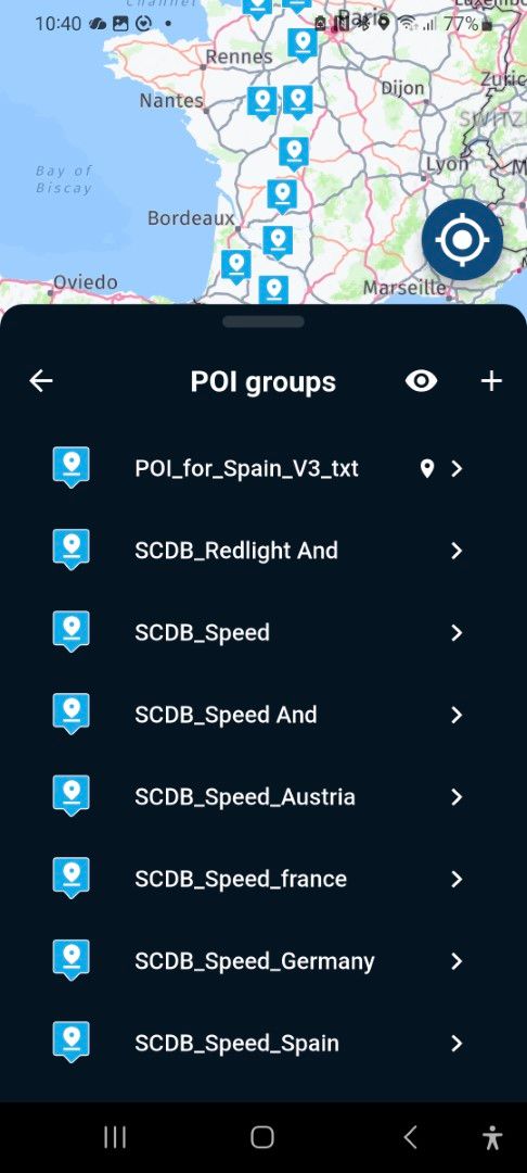

    1. Activated the POI file I wanted
      two screen shots below

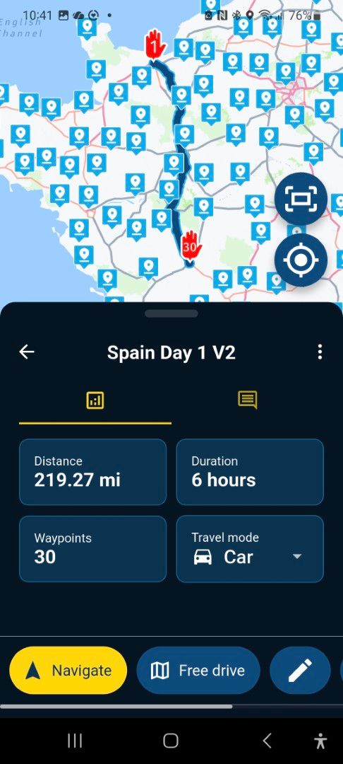

    2. when I then open the route i want to navigate, MRA appears to be trying to show every POI in my files. Screen shot below. I can't get it to show, but I also get the message "Too many POI's, only the first 2,000 will be shown"

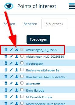

      @tony-13, You probably have multiple POI files selected to be shown? And if not, you might also still have selected some POI files to be shown from the web-planner. This work independently, and would better be deselected if you start using the in-app POI function.

        But looking in the web planner there was another, very large, POI file that was selected. Deselecting this then gave me the POI display i was expecting.

          No, those are 2 separate mechanisms unfortunately, which will very likely be merged in the new web-planner when it arrives.
