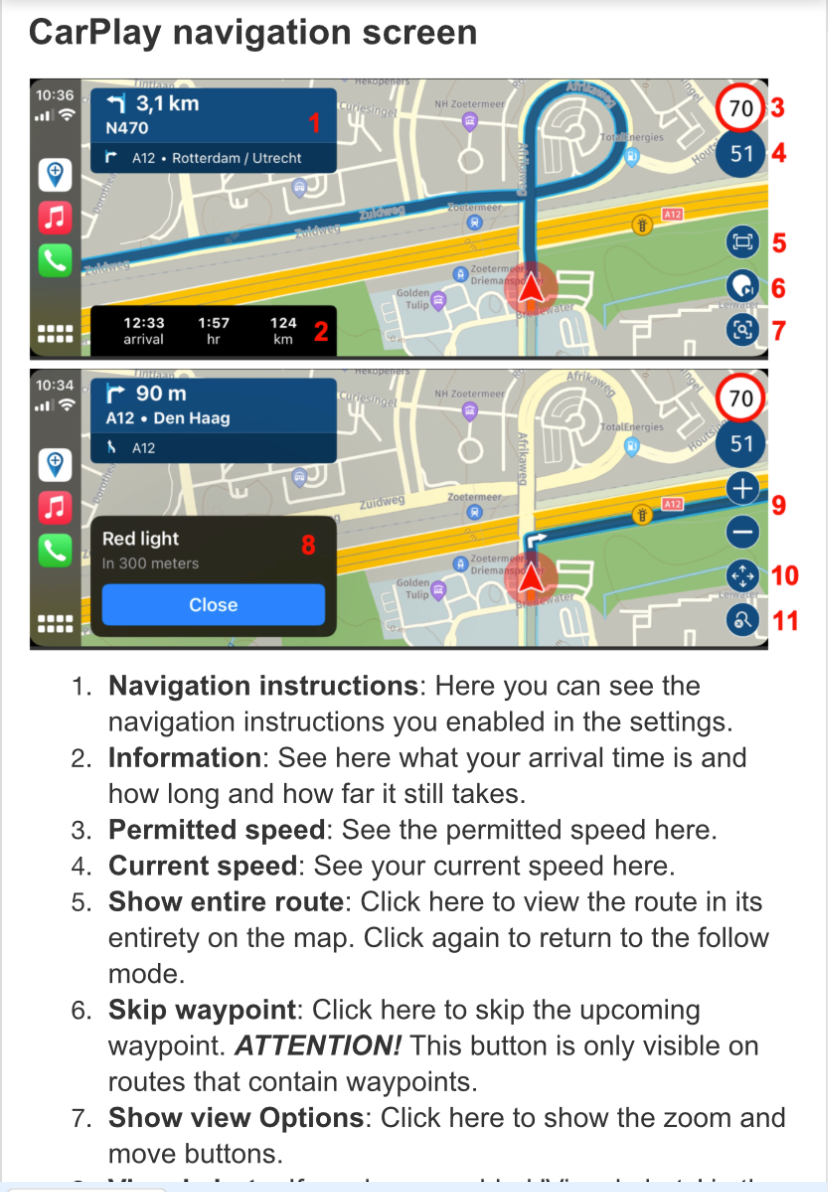

          Are you sure about this?
          I don’t have a CarPlay device to check, but I was under the impression that going into the settings gives you the option to skip.
          Hopefully someone with CP device can answer.
          Number 6.

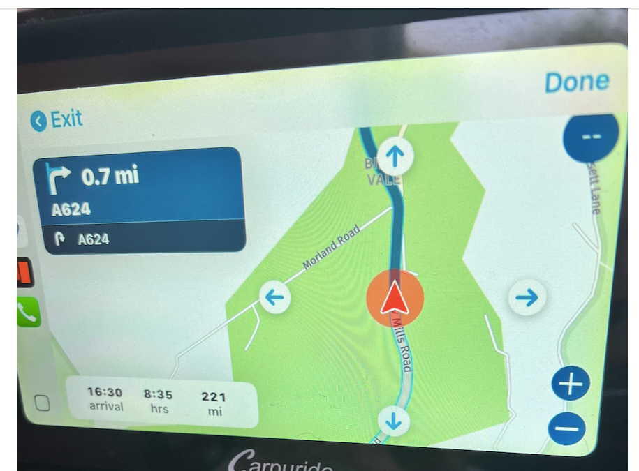

                  hi,
                  @Nick-Carthew
                  apologies, I stand corrected, I was not aware of this icon, (I ask why myself why am I not aware DOH)
                  the icon that appears in the top right corner when using the next app directly is not viewable in CP on my particular device.
                  I am not sure how to add that icon, #6, can someone enlighten me please.
                  unable to skip waypoints on screen below,

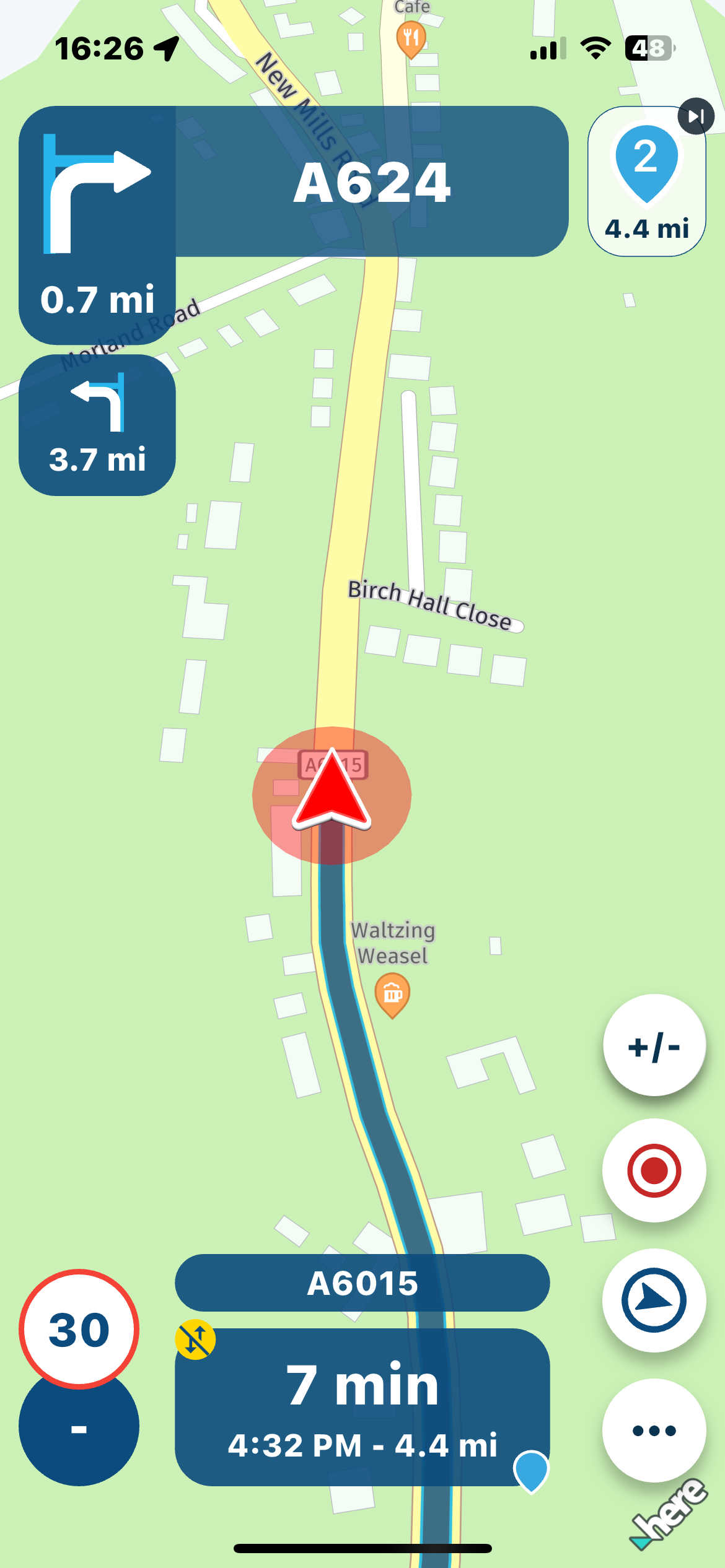

                    for clarity, below is a view of the screen when using NEXT directly on the phone,
                    notice the waypoint icon top right, recording icon bottom right, settings icon and compass icon, non of which can be seen on CP screen

                      @paul69 in the CP and AA devices the skin waypoint button is not available. To ski a waypoint on those devices you must hit the menu button on the lower right and then you can buy the skip waypoint button

                        @paul69 For various reasons, the upcoming waypoint icon that you refer to is not available for AA or CP.

                                #15
                                @paul69
                                icon #6 is not available in CarPlay when you are in 'manual zoom', because in 'Manual Zoom' the + and - icons are displayed instead.
                                Once you go back to automatic zoom, then icon #6 is available on your Carplay screen
