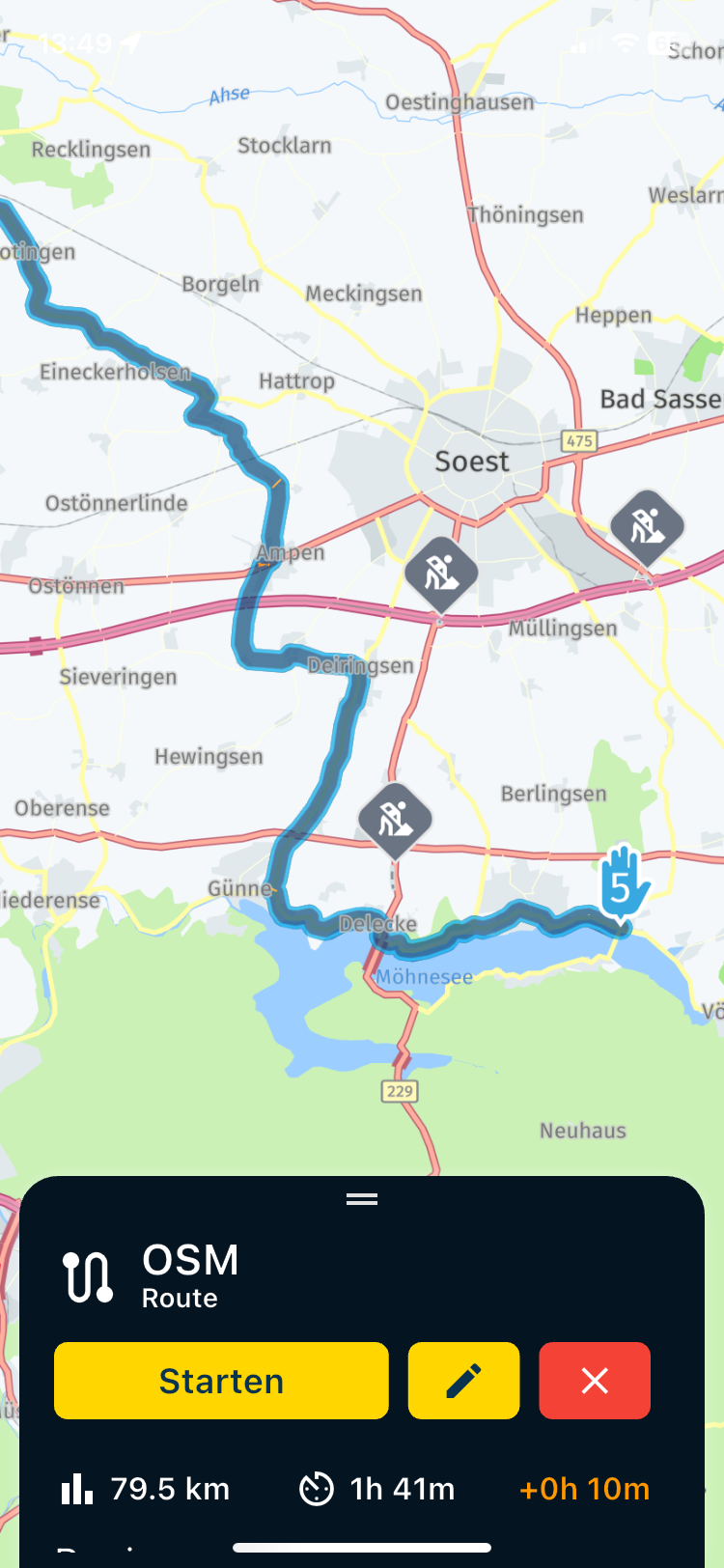

    I'm just wondering what the point of route planning with OSM map and curvy segments is?
    I can create great routes with nice curves, but I can't use them at all.
    If you add waypoints automatically, you get a completely different route.
    If you start adding WP manually, the route also changes.
    I can't save the route as GPX to use it as an overlay.
    I can't find any way to use the winding route created by the system.
    So what is the use of OSM and segments?
    Have I overlooked something?

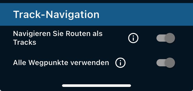

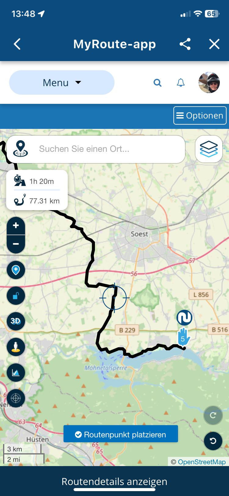

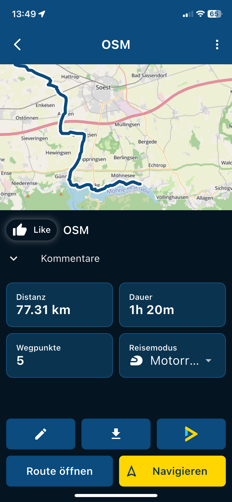

      @Jörgen :
      Planning as a route in OSM map and displaying it as an OSM engine, goes well once you recognize how to go. 😉✅ see settings ... "Navigate route as track" fits from my point of view.
      Als Route in OSM Karte planen und als OSM Engine anzeigen lassen, geht gut wenn man es einmal erkennt wie gehen kann. 😉✅ siehe Einstellungen … „Route als Track navigieren“ passt aus meiner Sicht.

          In case you open a route, that was created AND stored with OSM-Routing active, in Navigation the track Navigation will be advised or automatically switched ON.
