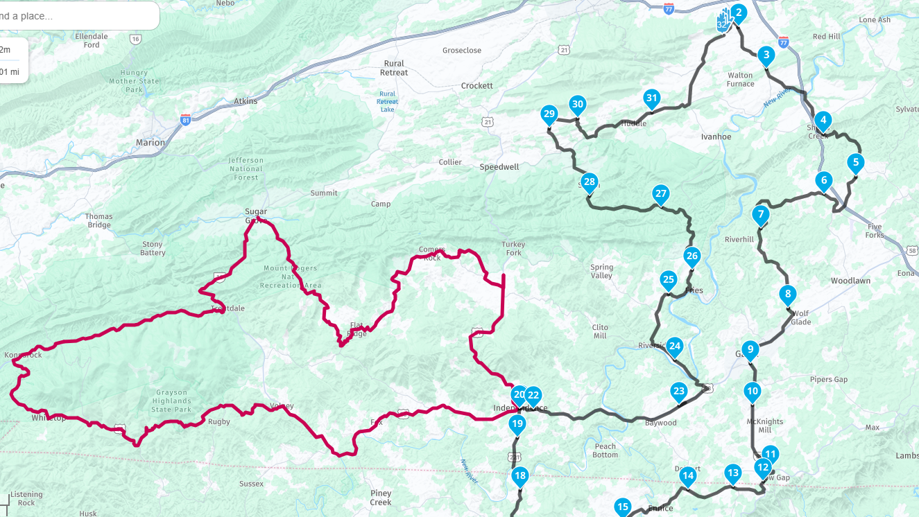

    I have 2 routes I am trying to "merge" But the merge point is #20 (see pic) The idea is to make a figure eight with the two routes (left and right) so that I cover both of them completely.
    Starting point #1 has already been moved to the end of a previous route. Because I can't merge two routes except at the beginning or end of one of a current routes (HUGE ISSUE FOR MRA TO FIX) I can't get it to follow the path of the (Left hand route on the picture)
    If I try to just drag points #20-#30 for example the entire route gets destroyed (Left and Right)
    Any idea how I can mid route merge these two routes?

      @Greenham I would make a copy of the first route and work on the copy. Split the copy of the first route at #20 so that becomes two routes, then merge the red route to the first part, then merge the second part of the first route to the end of the red route.

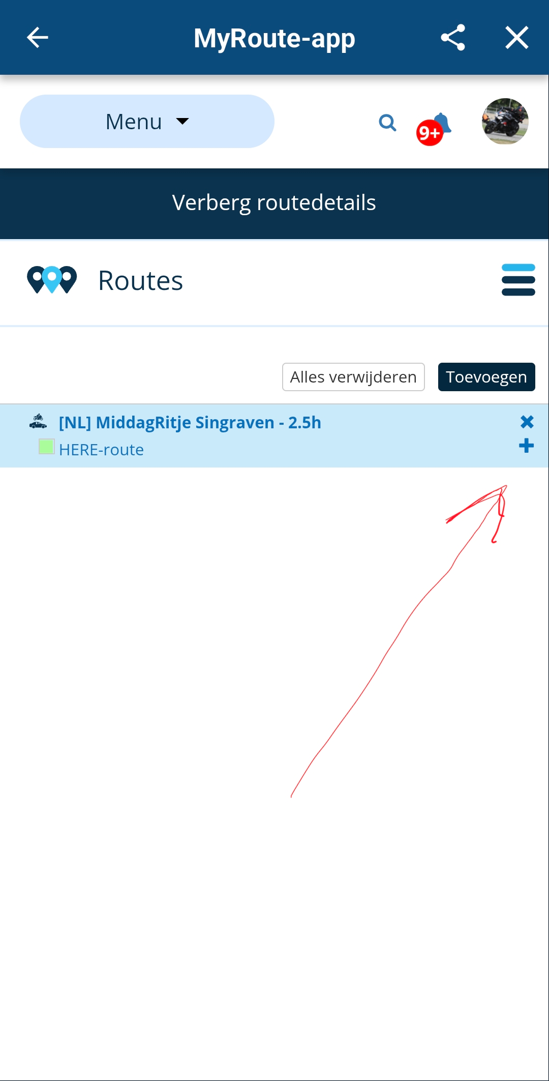

                @Greenham said in Merging two routes from mid route of one..... Is it even possible?:
                When I added the second route (Left) There was no option to Merge/Combine
                A route is added to your existing route through the + button that is shown in your "added routes" menu in the left hand side bar. I explicitly like to emphasize this since your wording seems to indicate you're expecting a toolkit option to merge just like it is an toolkit option to split, but unfortunately the merge is located in the spot I mentioned above and shown below in the in-app Routelab:
                Try the following steps:
                Split red route in 2 routes, resulting in first half and second half, from now on referred to as route 1 and 2.
                1. Open route 1 (first half of red), add the Blue route through the menu option I have shown above.
                2. Merge the added blue route into the currently open "route 1" by clicking the + button.
                3. Succesively add route 2(second half of red) to the open route ( route 1 + blue route) through the menu option I have shown above.
                4. Merge the added route 2 (second half of red) into the currently open route by clicking the + button.
                5. Enjoy your figure 8. 😉
                Hope this makes it a bit more clear.
                    on new numbers that made no sense....
                    I think what may have happened is that the black route's waypoint nr 1 is not at the point where you've split the red route. I forgot that!
                    Before merging the black route onto the first half of the red route, in your black route change the waypoint closest to your "merging point" (that'll be wp20 I guess), to become the start waypoint (wp1) of the black route. 😉
                    Unfortunately I have no time at the moment to create a screenshot or graphical illustration for it, hope the text above makes sense. 🙂
                    This all assumes that you want to start the route at the start point of red route. Obviously the process is the same if you'd like to start with the black route, and add on the red one. In that case just interchange the red and black routes in my longwinding posts. XD
