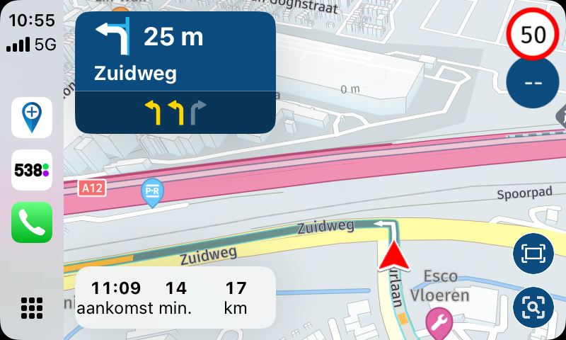

                  said in Show lanes or do strong zooming:
                  The lane-insert only appears in the app, not on CarPlay (due to restrictions on the CP side I guess).
                  @silberfuchs67 CarPlay sometimes does show lane guidance. See picture below.

                    Thanks - this is exact the way I realized this morning trying a short route. Sometimes very helpful!
