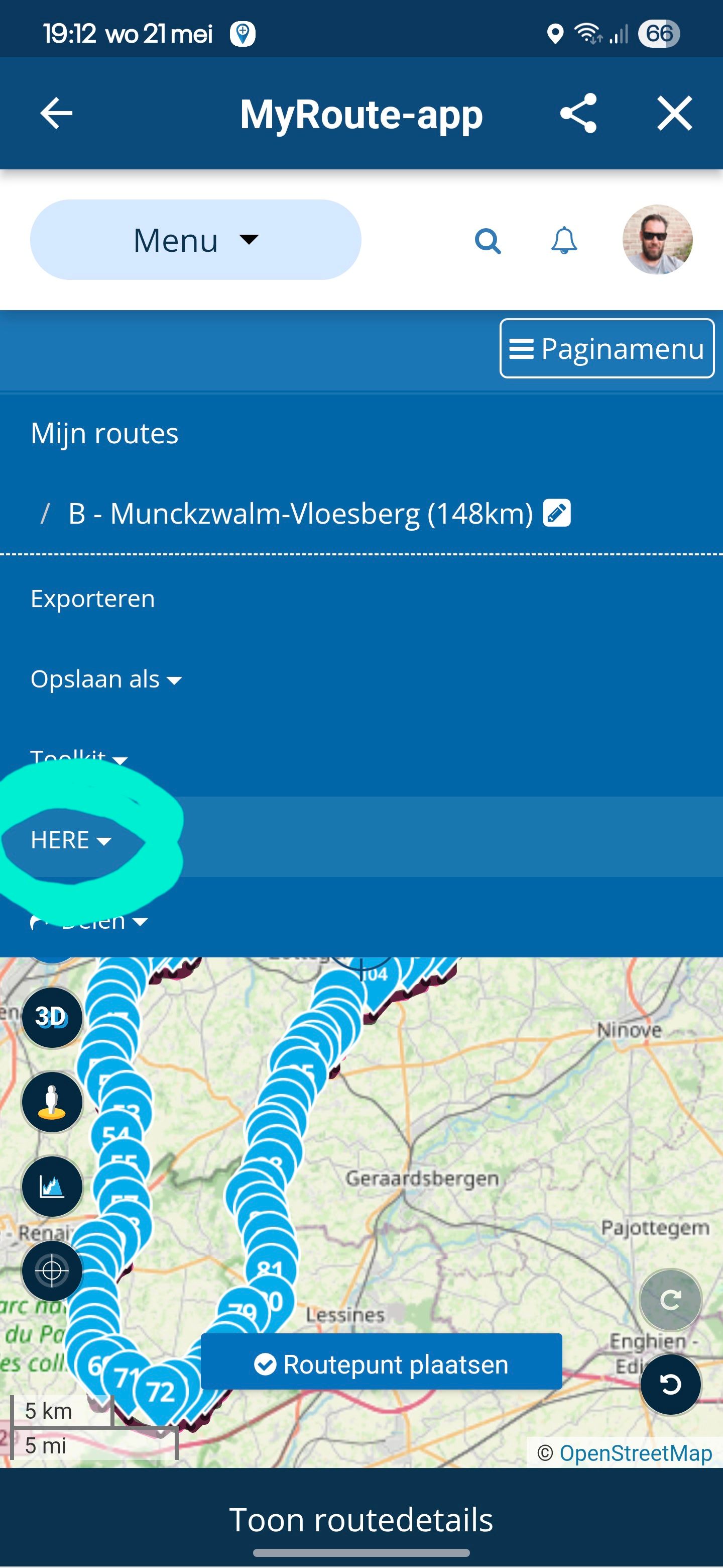

      If you navigate with MRA, make your routes with the "Here" map service (pic 1).

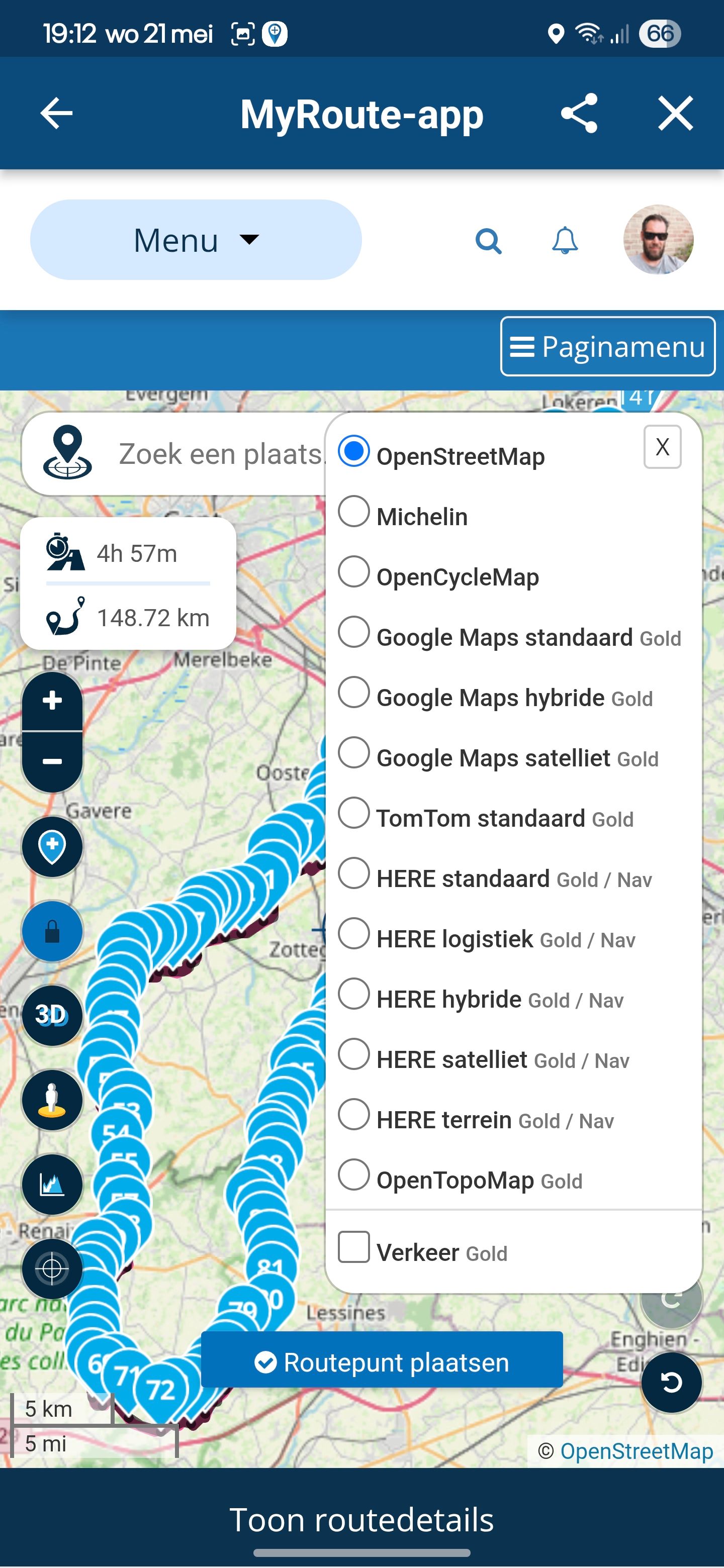

      It doesn't matter which map layer you want to use, personal preference (pic 2).

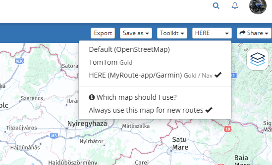

          @Joce-Doubs For the pure planning excercise on the web you can use any map you want. You just need to keep in mind, that MRA Next (The Nav APP) is always using the Here-maps and the related routing algorithem. If you plan with any "non-Here" map on the web, you should finish your planning and use the compare feature to see, if the route takes the same shape, when you will use a Here map.
          If you find any differences, then you should change the route to fit to your originally planned layout.

              @Joce-Doubs then you will have to plan your routes using the Here map.
