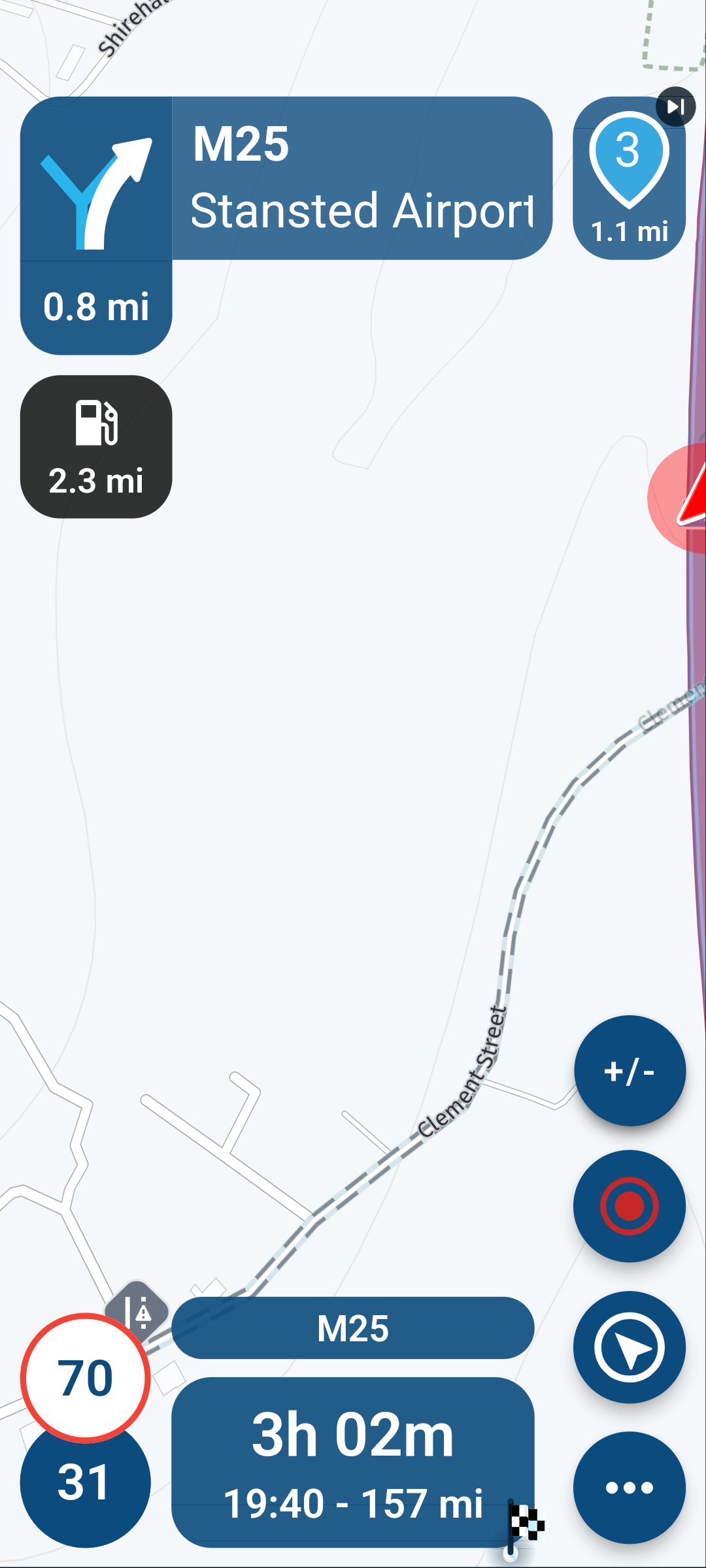

    I've just got back from a brilliant week in Holland, Belgium and France. I'm wondering what I've done wrong here on my planning. I did a few routes, that are listed here. I've made them all public in the hope that someone might point out the error of my ways. The problem on all of the routes was that MyRouteApp had a meltdown on all of them, so much so that I had to switch to Google Maps. On all of the routes listed here the arrow would depart on its on merry way ploughing through houses, and telling me I was on the opposite side of the road.

    On the last day, I didn't use my pre planed route, but just put in Calais from the hotel in Bayeux. Sadly this didn't fair much better, at on stage the app was telling me to do a U turn on the motorway, and the arrow was going everywhere else rather than on the road. One last thing this is a screen shot of what the app was displaying on more than one occasion. Screenshot_20250502-163854.png

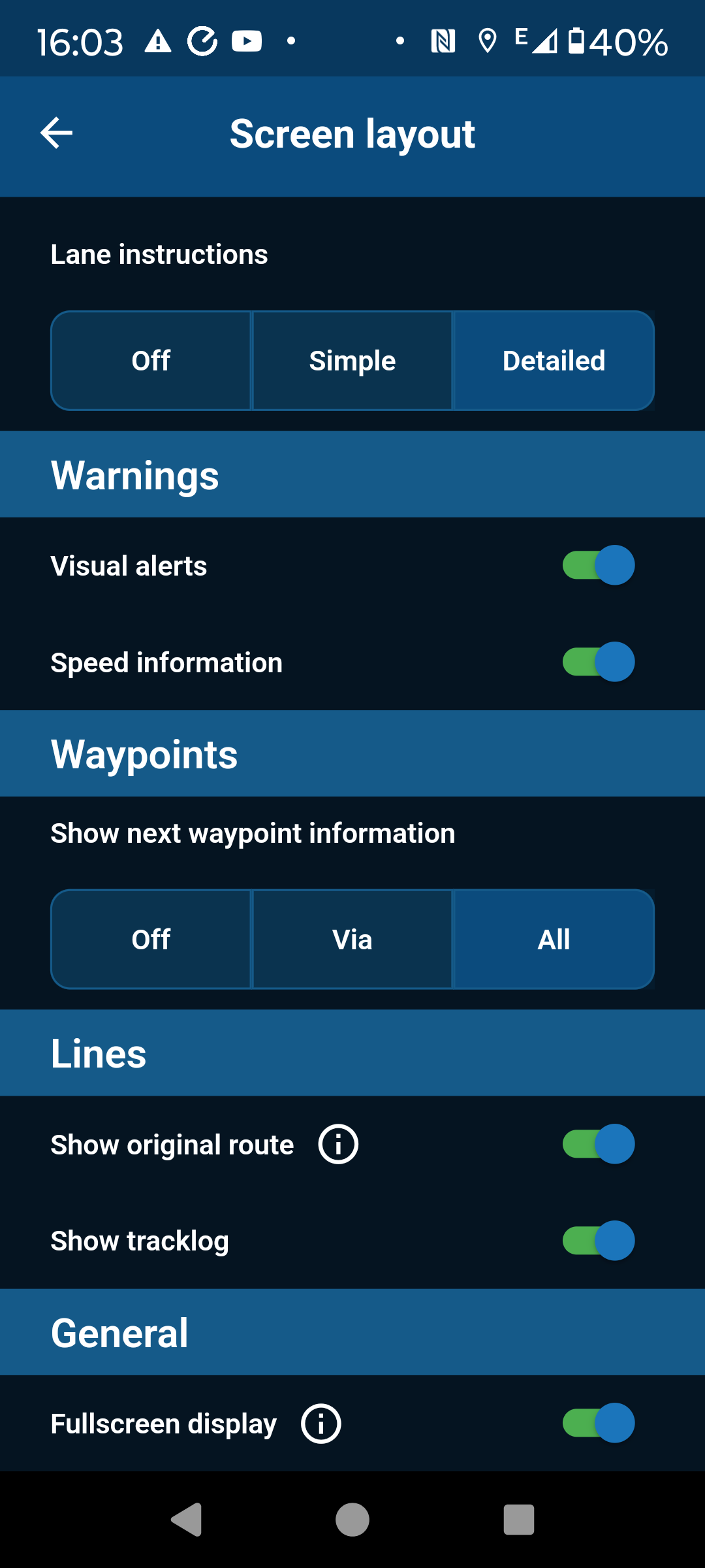

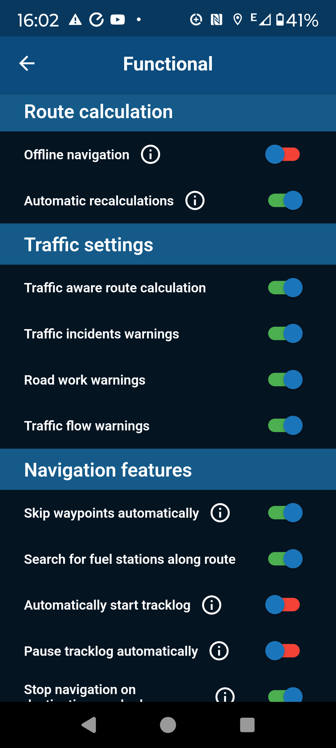

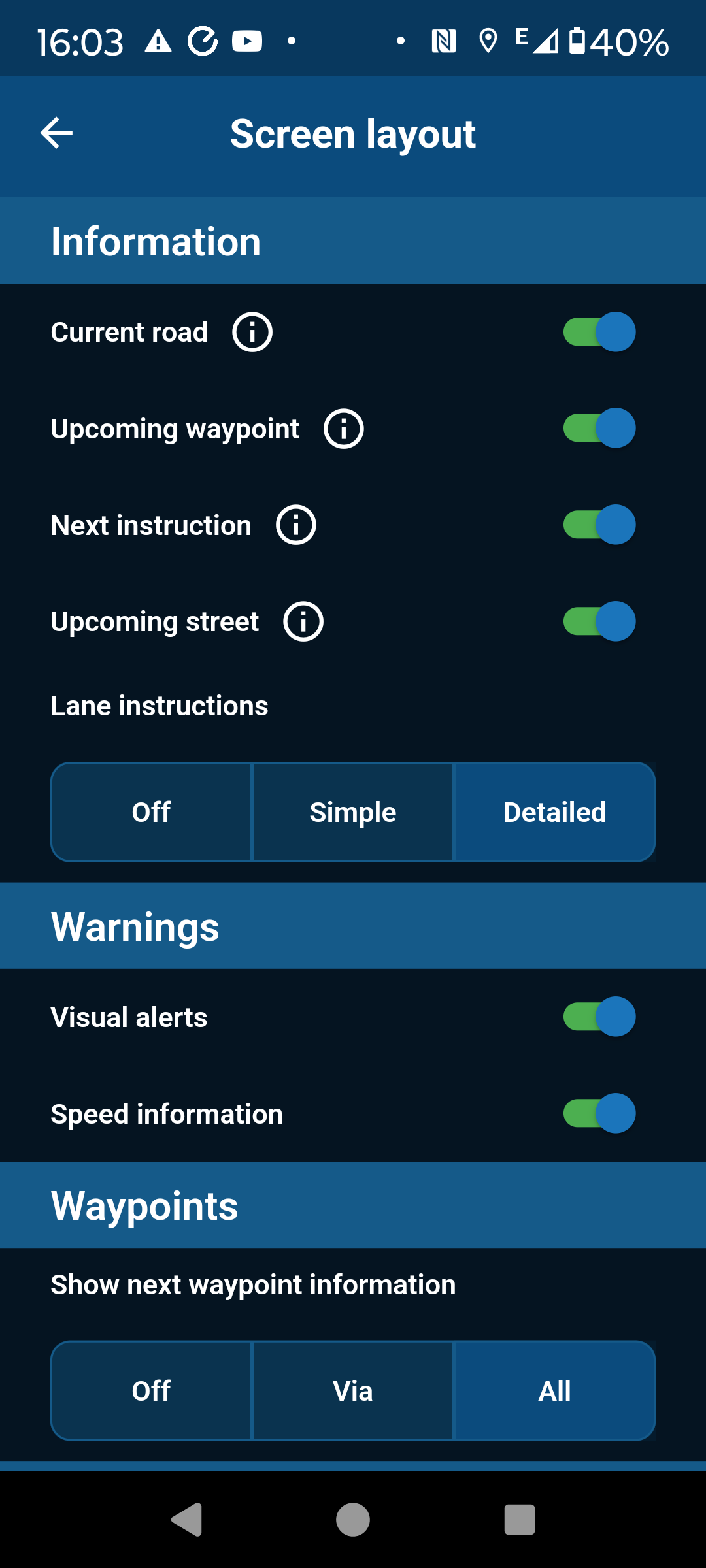

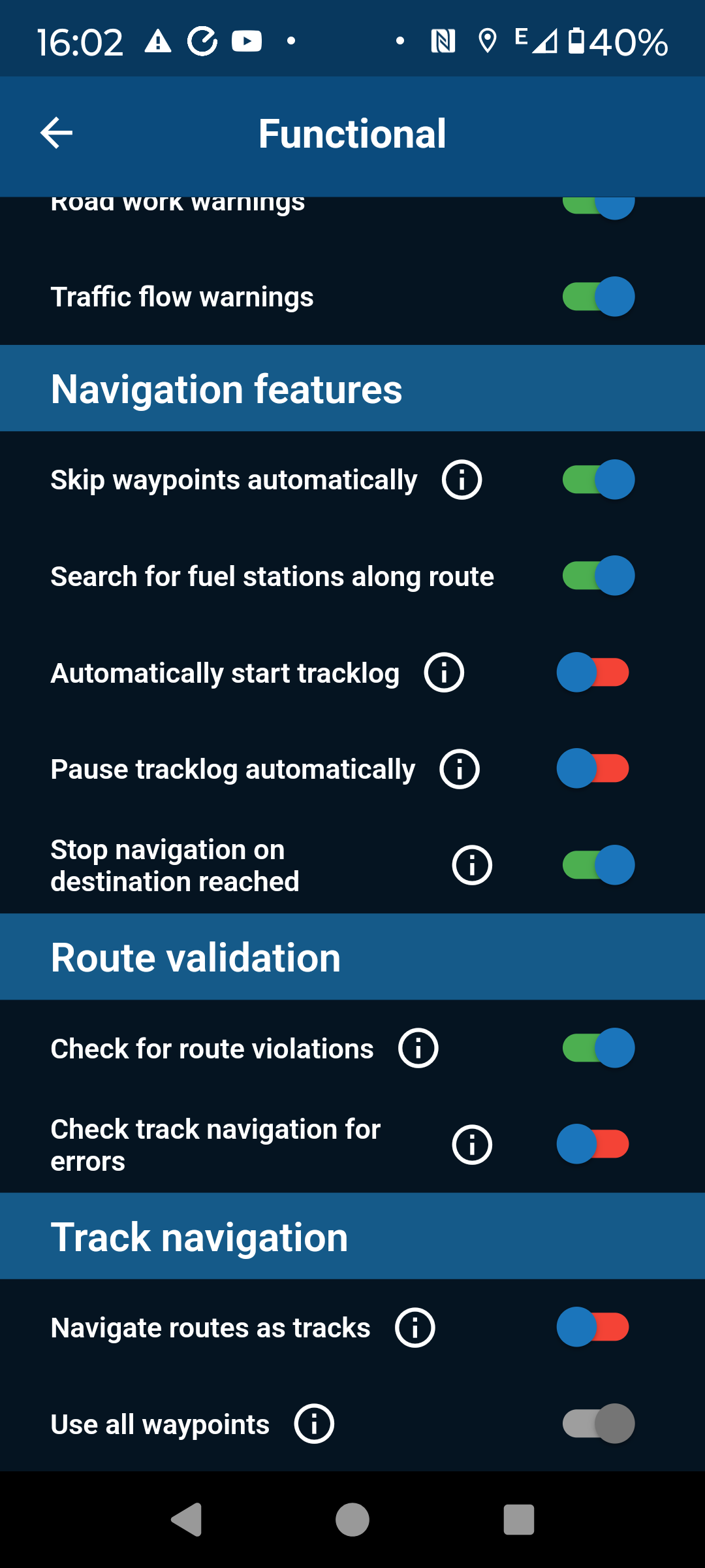

          @Garry-Davis
          Ignore the comment above, I was having a senior moment.
          Screenshot_20250503-160314.png Screenshot_20250503-160308.png Screenshot_20250503-160241.png Screenshot_20250503-160233.png
          • Garry Davis Garry Davis
            @Garry-Davis
            @Garry-Davis I'm sorry. My question wasn't clear enough. I was wondering about your hardware settings. My conclusion of your screenshots is that you're using. MRA next kon a mobile device/phone. That looks alright so I haven't got a fu.. clue what have might caused your experience.

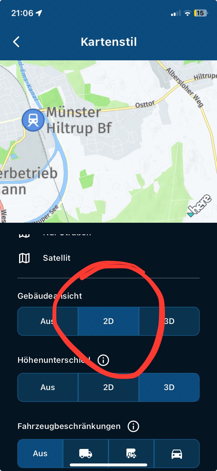

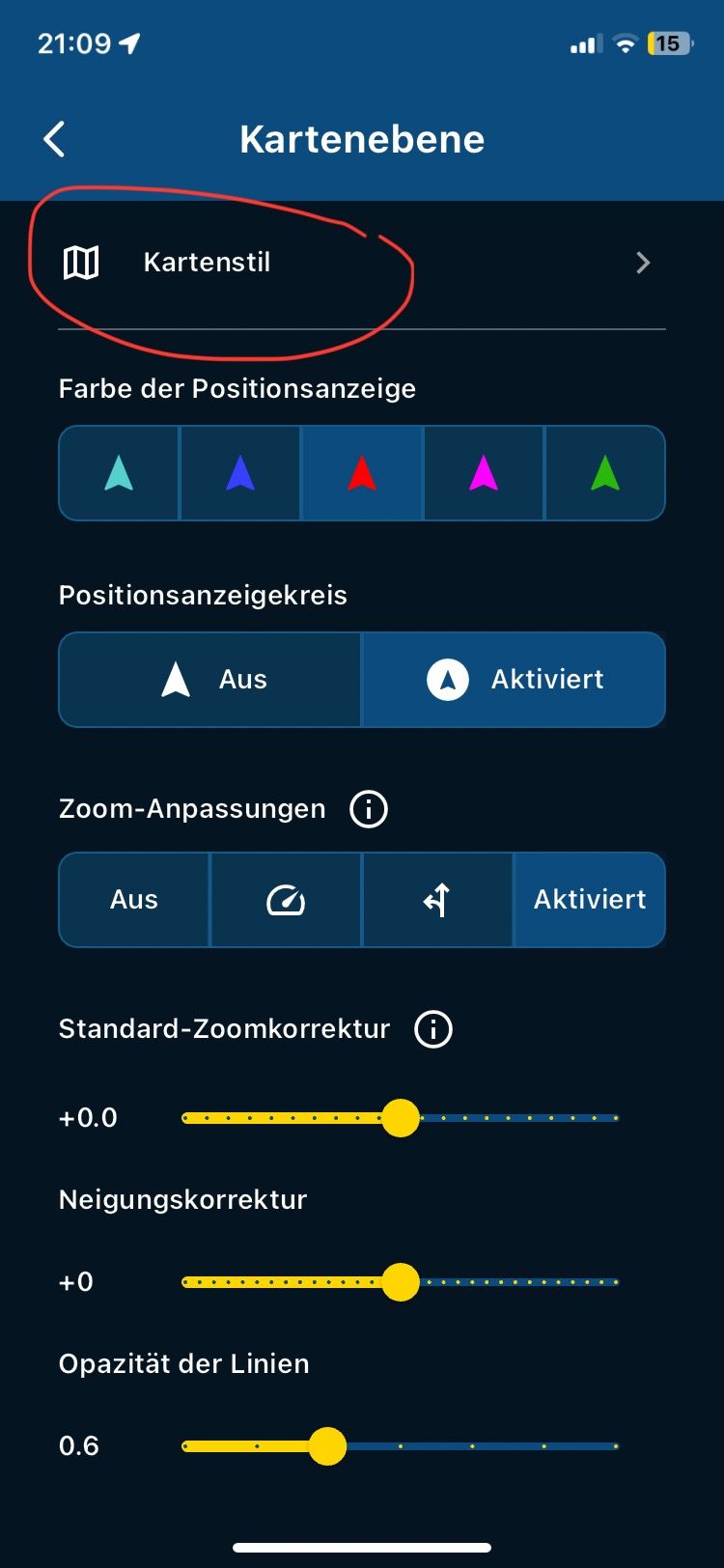

              @Marinus-van-Deudekom
              @Garry-Davis
              Please set to 2D or Stop and restart route, had the problem in the past with 3D.
              Only drive in 2D view.

                @Hubert-Thoring
                Just checked my settings, and it's on 2D already.
                The next time I'm out with it, I'll give it another go and see how I get on.
