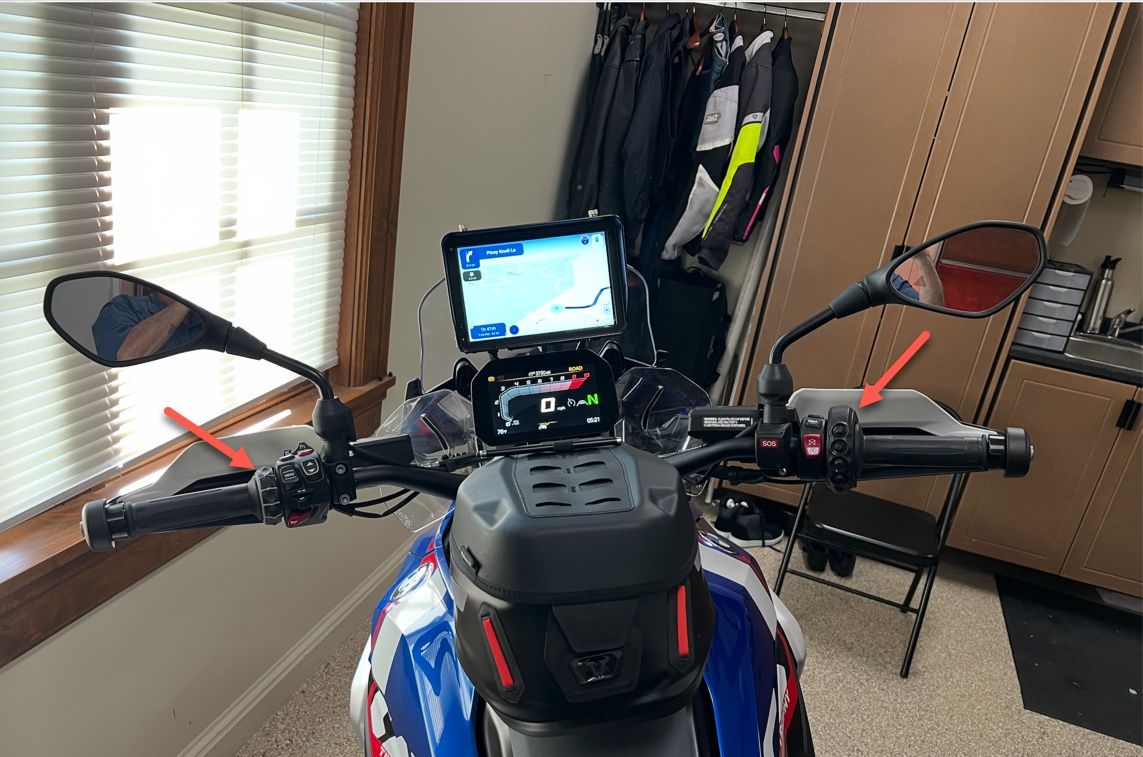

          Here's a link to a post by @corjan-meijerink regarding the integration. My previous post also explains what the Wonder Wheel and the buttons do on my bike.
          Here's a picture of mine.

          • Steve Jarrellundefined Steve Jarrell
            @Chudy Both.
