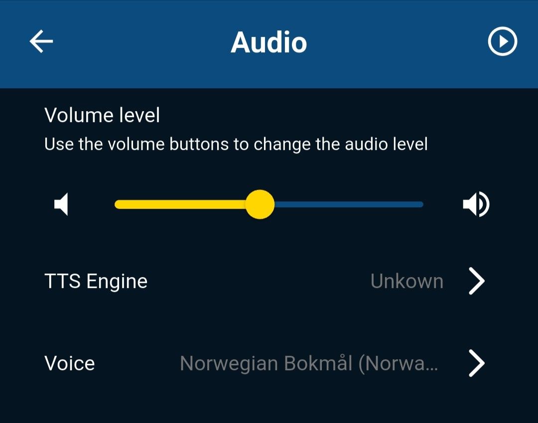

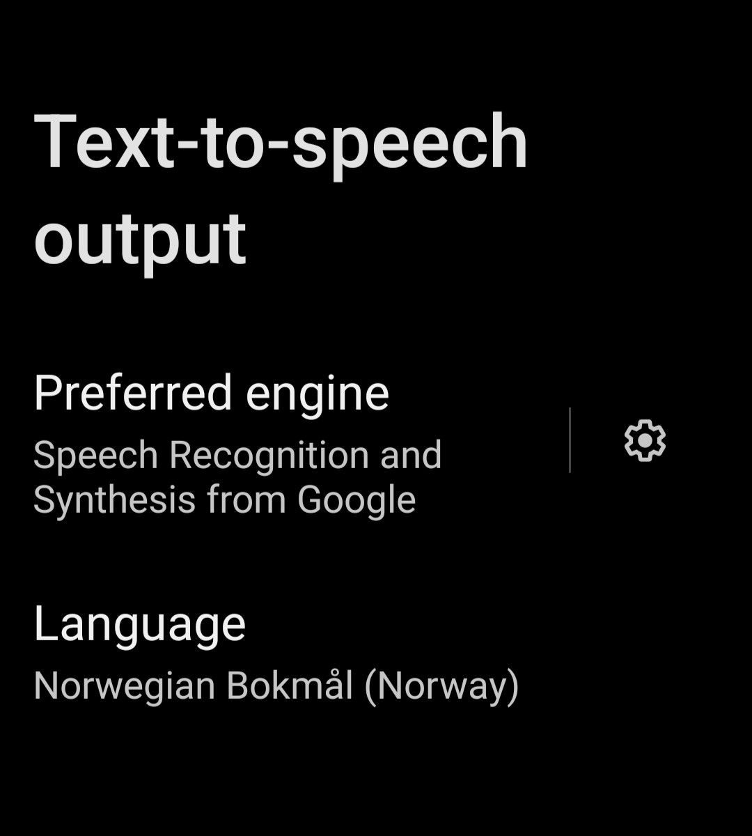

                On Android there is the setting "Text to Speech". I'v set it to Norwegian (a language the app doesn't support at the moment). But with this, street names, waypoint names and waypoint numbers are spoken in Norwegian, something I am very happy about.
                Instructions like "Now join the motorway" are still in English but with a funny Norwegian accent. I assume that this text is coming from HERE? There is a setting in the App to set the language but that does not help.
                Would this be fixed if Norwegian was added as a supported language to the app?
