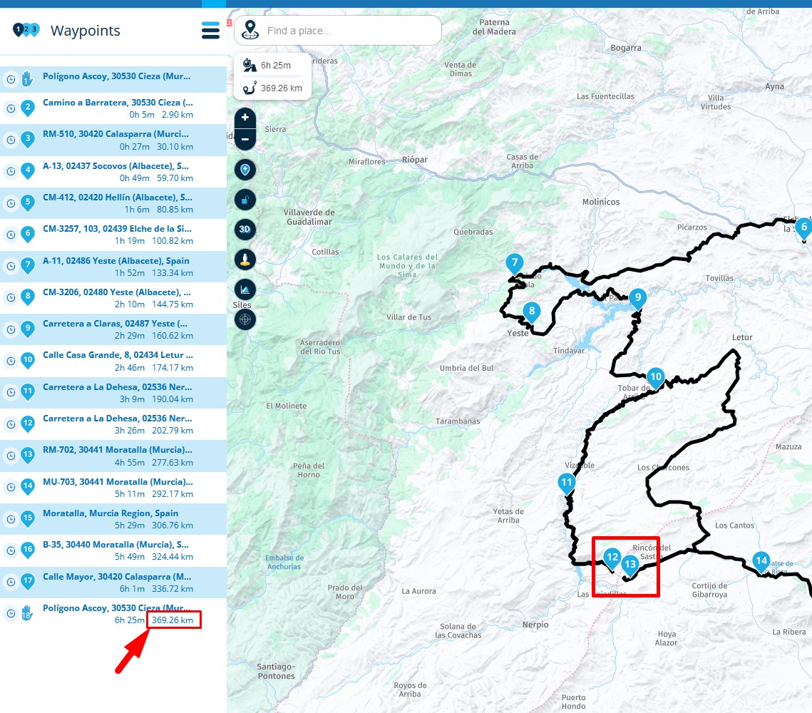

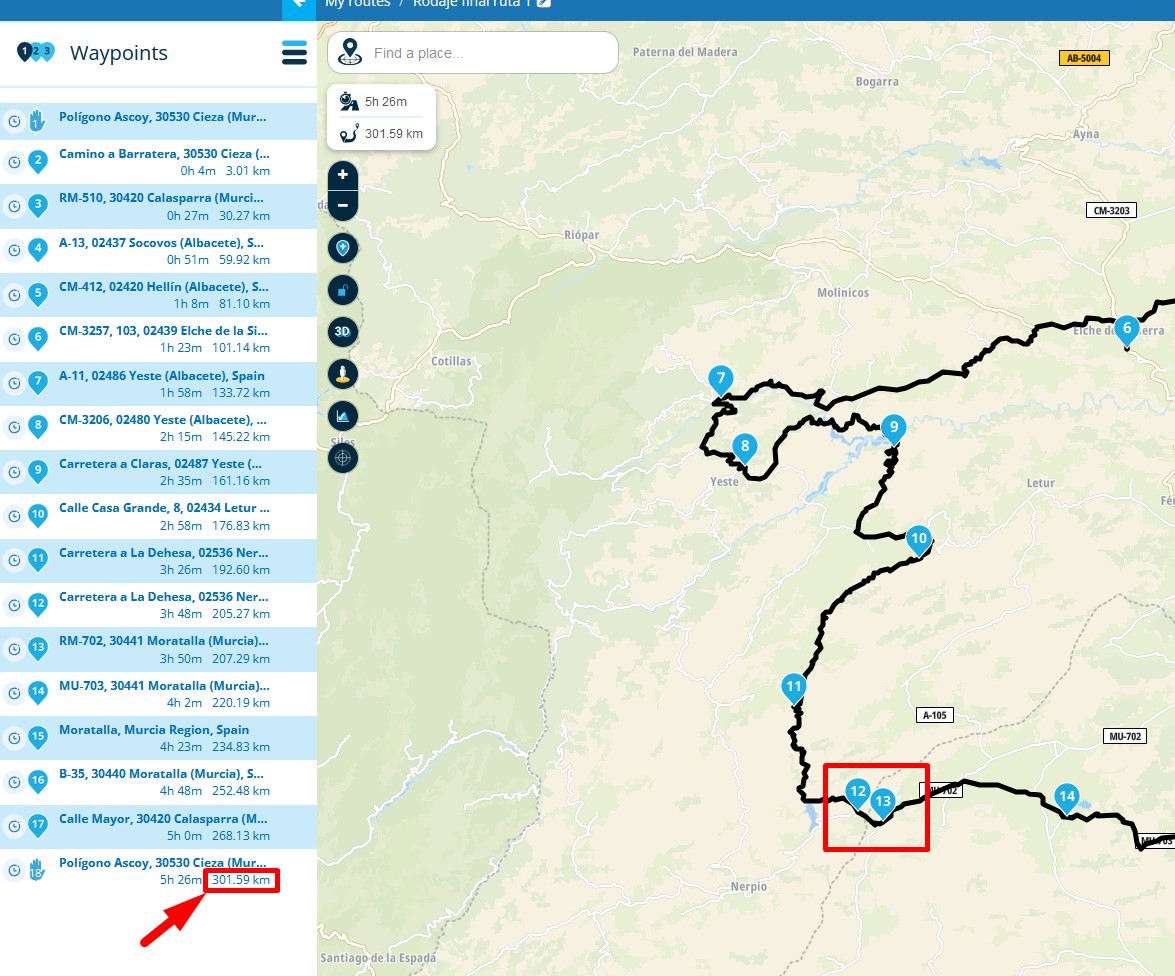

    Hello,
    I have just purchased a new motorbike and I am preparing some winding routes for the running-in. To my surprise, I am finding a lot of "disconnections" in roads which forces the Here navigation engine to design INSANE deviations. I had experienced this problem in the past, but this time I am completely shocked to find that:
    a) I am experiencing such disconnection in 3 out 3 of the routes I have planned.
    b) In the most extreme example, there is a detour of almost 100 km.
    The problem is exclusive of Here maps, as the routes are planned as expected with the TomTom engine.
    Here you have the links to the routes shown in the screenshots below:

    I personally use two strategies when I find this problem:
    a) Mark the point where the disconnection begins as a mandatory stop, so that I know that I need to stop navigating because "something is going on". I then ignore the navigation directions along the faulty connection, which usually means just some metres, and then go on as planned.
    b) Create separate routes for each of the sections where disconnection begins and ends.
    I find both strategies quite annoying; but better that than riding dozens of extra miles.

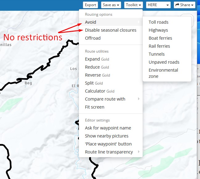

        @Ramon-Cutanda-Lopez Could it be you have 'saesonal closings' active on the toolkit? If you plan routes over mountains in early spring, they could well be closed due to snow.
        • Ramon Cutanda Lopez Offline
          Ramon Cutanda Lopez
          wrote on last edited by Ramon Cutanda Lopez
          Thank you for your interest, Marinus and Gerard:
          1. No restrictions whatsoever.
          2. No traffic enabled.
          alt text
          alt text
          1. I created the routes using Here maps. However, I switched to TomTom just to take the screenshots so that you could compare the crazy route planned by Here vs the "logical" route that I expected and that TomTom indicates correctly.

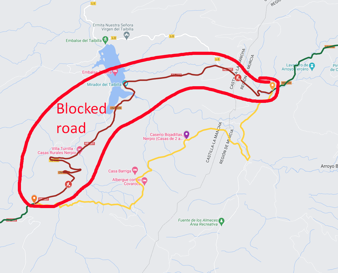

            @Ramon-Cutanda-Lopez in ruta 2 there’s a road closed Between 14 and 17
            If You activate the trafic layer it’s quite clear

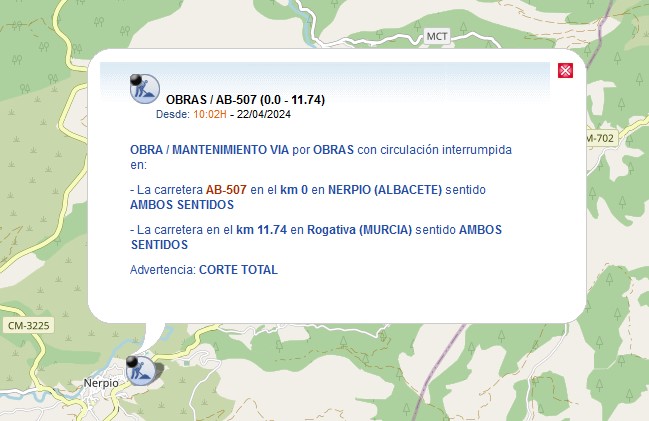

                @Marinus-van-Deudekom, bingo!
                I had problems with two of the routes because the road is officially closed:
                https://infocar.dgt.es/etraffic/
                https://www.google.com/maps/d/u/1/viewer?mid=1YnK1nWlT0fxWYoDF8GpF6lHi3CvpYg8&ll=38.19435257766315%2C-2.253235930796811&z=13
                alt text
                alt text
                That explains why the route breaks after point 14:
                alt text

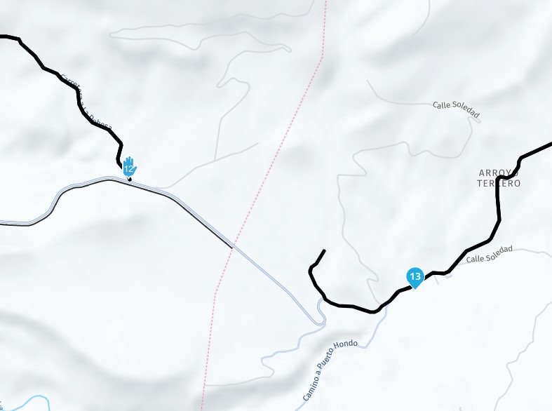

                And also why I cannot connect waypoints 12 and 13 in my other route:
                alt text

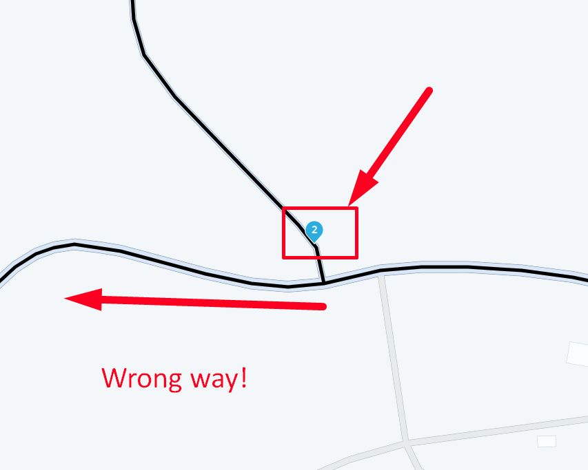

                I still have no explanation, however, to this extrange turn here:
                alt text
                I make the left turn at waypoint 2 once or twice a week. There is absolutely no problem whatsoever there.

                  @MTC-Zeilberg Thank you for the tip. However, even if I place the waypoint as precisely as possible, Here still plans a wrong turn.
                  alt text

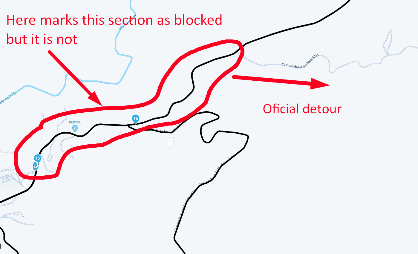

                    After checking the official detour, it turns out that one section of the road marked as blocked by Here is ACTUALLY NOT BLOCKED and I need to use it to access one of the officials detours. Is there any way to force the planner to ignore blocked sections?
                    Thank you once again.
