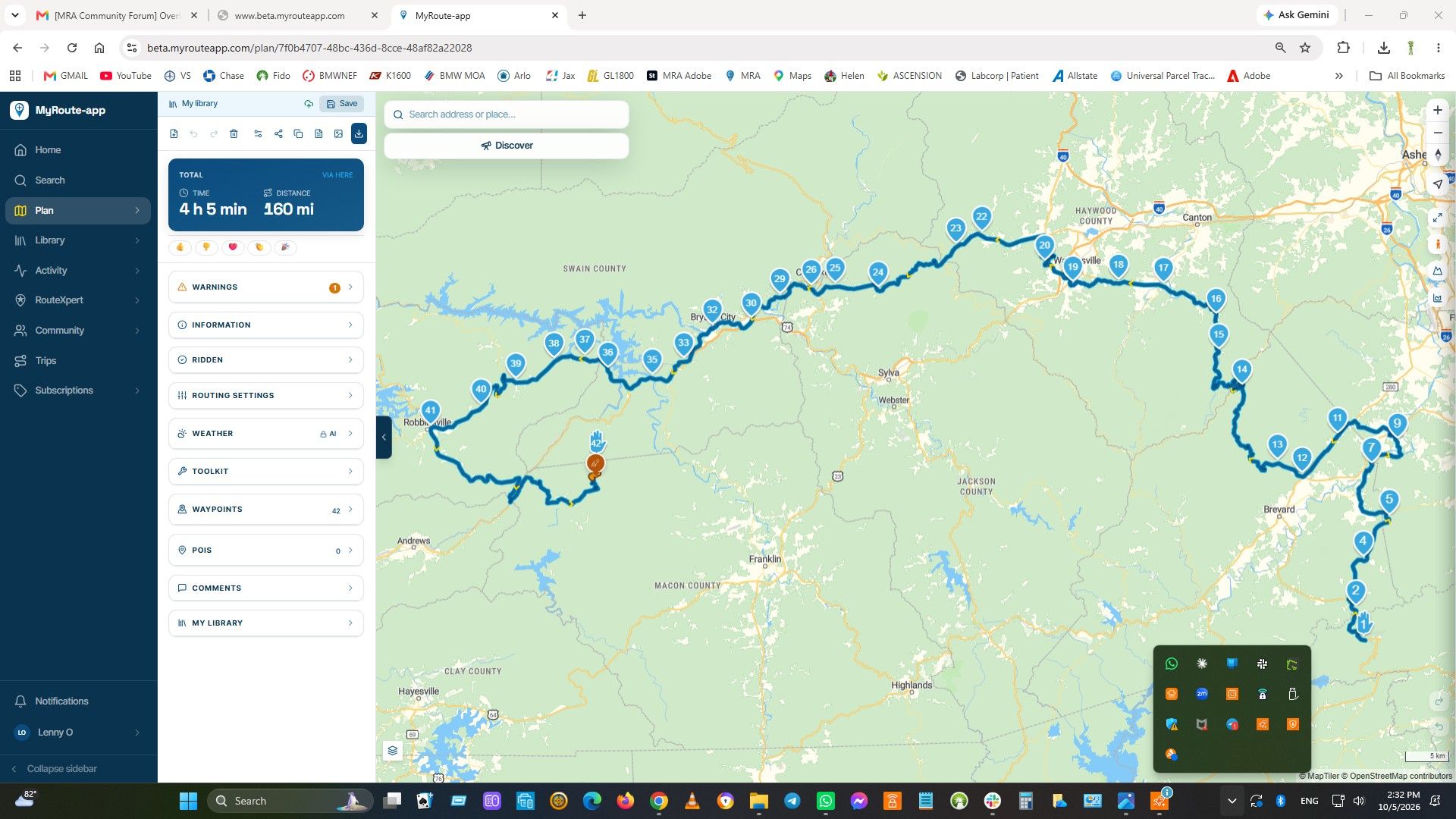

          One more thing.... 😊
          I went back to look at the version of the route that prematurely finished as previously described. I see a red dot (circled in blue):
          I don't remember seeing this earlier, but maybe I didn't have the right zoom level. I did a search on this but came up empty -- that's why I'm asking here.
          BTW, this shaping point (#13) location was a mistake in the route that I didn't catch. I meant it to be on the highway directly above. Here is the route with public viewing:
          https://www.myrouteapp.com/route/open/9582564
          MotoCon Nick Carthew 2 Replies Last reply
          • John S Parry John S Parry

                #19
                @John-S-Parry said in Destination Waypoint Missing in Zumo XT:
                The red dot πŸ”΄ is from the distance slider at the bottom.
                John S Parry MotoCon 2 Replies Last reply

                  • Nick Carthew Nick Carthew
                    John S Parry
                    John S Parry
                    John S Parry
                    #21
                    @Nick-Carthew Thanks Nick. Good catch! I must have started an animation, walked away when I stopped at that point, and forgot about it.
                    I shouldn't be allowed to play with toys. 😊
                      MotoCon
                      MotoCon
                      MotoCon
                      #22
                      @Nick-Carthew said in Destination Waypoint Missing in Zumo XT:
                      The red dot is from the distance slider at the bottom.
                      Sharp! πŸ˜‰
