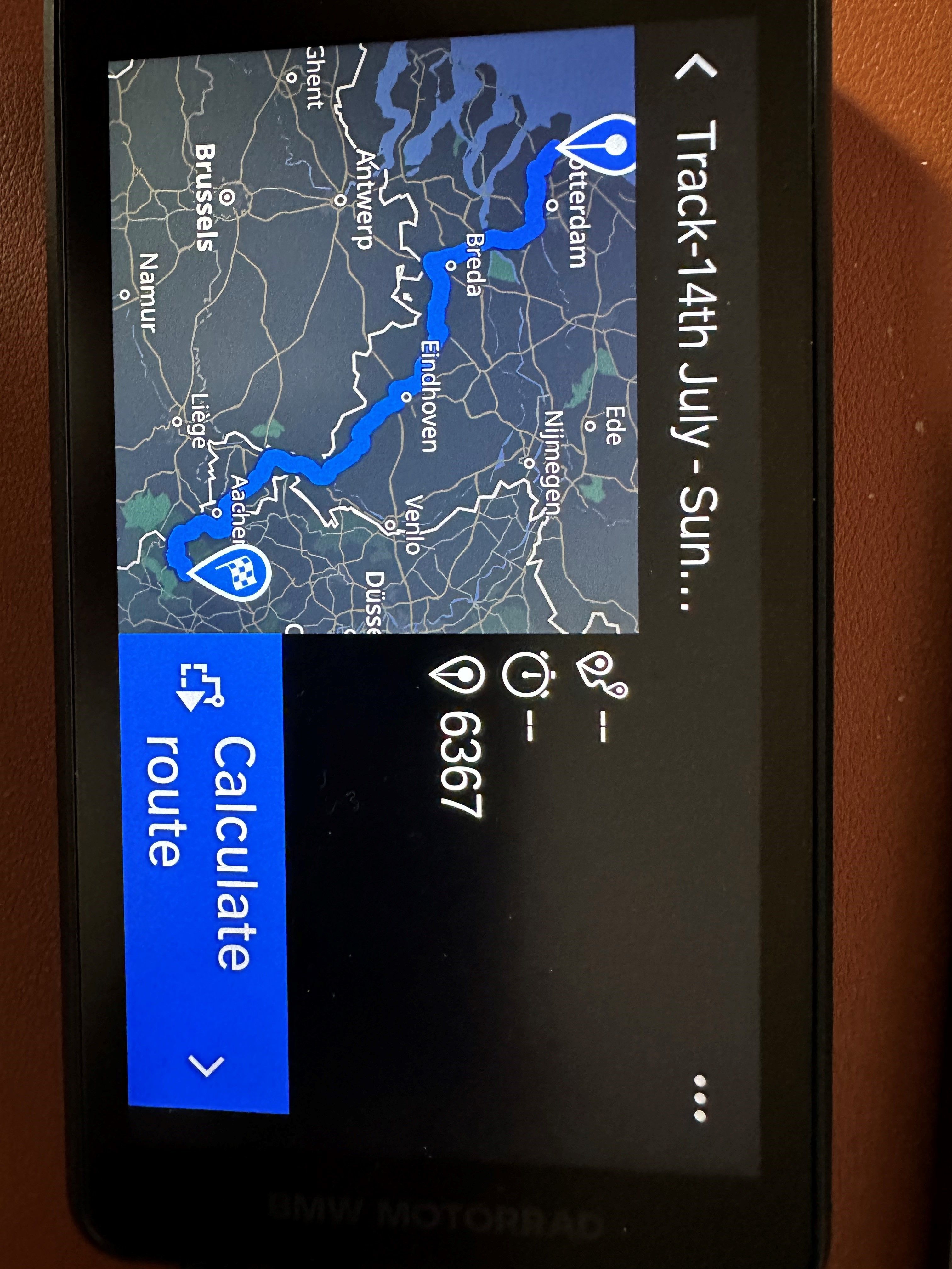

        @Ian-Montana One thing I thought was strange was that it doesn't show distance or time - just number of points
        Ian Montana 1 Reply Last reply

            On the phone or on the CRN I have the route switch to / show Route points. This only works fine when the Tom Tom map is used. When the here map is used the number of RP’s are in the thousands, the CRN can only handle up to 50 RP.
            So I create a route (or get one from the library), convert it to the TT map, check that my RP are equal or less than 50 (even complicated routes can comfortably fit within 50 RP). Save it as 1.1 gpx route and track, and mail it to my self. I then open the GPX in the phone app, import only the route. Then I use the option ‘switch to Route Points’. If less than or equal to 50, the route is calculated, then I save it. Within a few minutes the Route is visible in the CRN ( I use a SIM card, but Wifi will also do), including the Route points. It can then be calculated.
