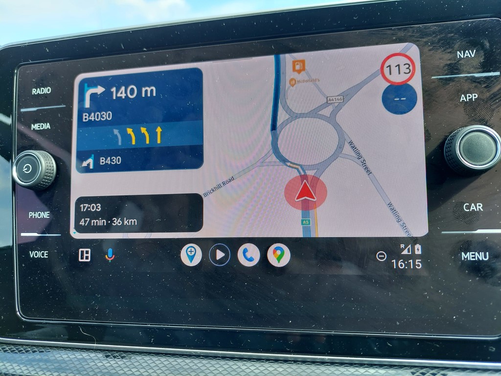

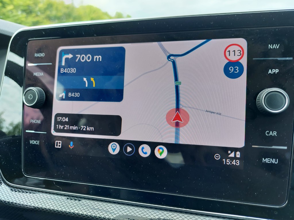

    Using a Google Pixel 7 Pro, Android 14, MRA-app 4.1.3 - 312
    Connecting to a rented VW T-Cross via Android Auto
    While using MyRoute App on Android via Android Auto, there were a number of occasions where the Turn and Next Turn visual cues (top left on the screen) did not update. The voice instructions were correct, but at some point, old instructions seemed to get stuck on the screen and not update.
    At some point, they did update and the app would start behaving correctly again, but this happened repeatedly on one journey.
    I have not seen this behaviour using the app directly on my phone. It seems to always work correctly there.
    Attached are a few photos of what was going wrong. The turn instructions are clearly incorrect.
    alt text
    alt text
    Looking in the log, all I can find is the same exception:

      @David-Emmett Thanks for sharing!
      I recently got a similar message from customer support.
      The issue is fixed in the upcoming update 🙂 We are still working on the other details of that update but rest assured that this issue will be solved!

        @Corjan-Meijerink This could have been the ticket I submitted 3 or 4 weeks ago as I was encountering exactly the same problem.
        Testing the new release this weekend, I initially thought it had been fixed but it seems not as 3 separate routes on 2 different Android auto head units indicated the same error. A few photos from my car below but the same happened on the bike. In fact I did about 70 miles of a 90 mile journey today on the bike with only a spinning circle in the next instruction box (the rest of the route it just showed the wrong instruction).
        Any idea when it will be fixed?
        20240719_092618 Small.jpeg 20240719_173737 Small.jpeg 20240719_092830 Small.jpeg 20240719_173936 Small.jpeg 20240719_173525 Small.jpeg

          I am getting the same problem on an Android Auto connected display on my motorbike. It updates the image of the road and my current position, but the flags of the next turn at the top left freeze, just showing a turn I did in the past.
          Then it asked me if I wanted to disconnect Android Auto. I refused that. Later it completely stopped with an error.

                  If i see the pictures. It is still an issue for countries where driving on the left is normal (like UK). I saw it also end May/Begin June when i was in Scotland. But i cannot recall it happens on the mainland of Europe.
