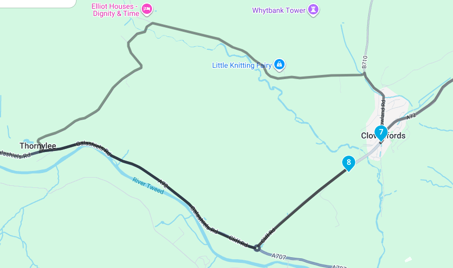

            I'm trying to go from 7 to 8 without taking that huge loop to the north. In Basecamp I would simply create a custom avoidance on that northern loop. How do I solve it in MRA? I've played around with different positions of 7 and 8 and with different maps, to no avail.

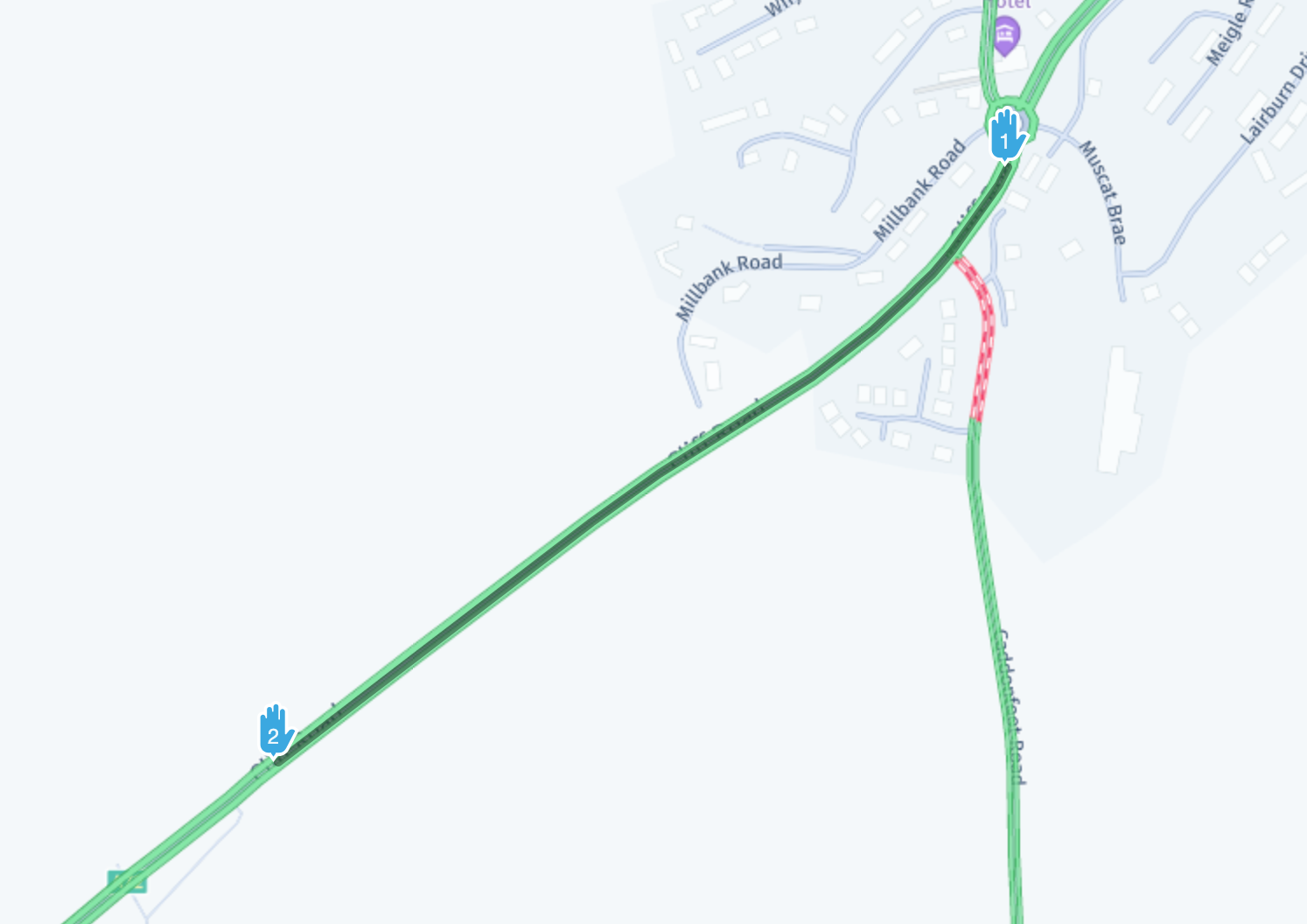

              @colin-irvine Perhaps there are works on that stretch? If you have the Gold version and turn on the “traffic layer,” you can see that roadworks are indicated on Caddenfoot Rd. Maybe they still affect Cliff Rd.? By the way, if you tick “Disable seasonal closures” in the Toolkit menu, you can see that the route does go via that road.

                Thank you - that did the trick!
