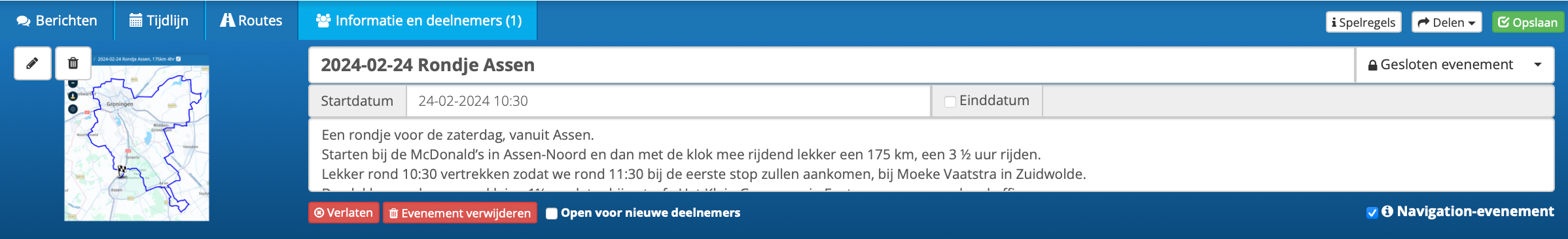

      @Albert-Renting
      When creating the event, there is an option to organize this.
      I think there is a check box asking if it is a navigation event.
      You can also place a check mark afterwards. If you choose to edit the event, the check box will be at the top right of the screen.

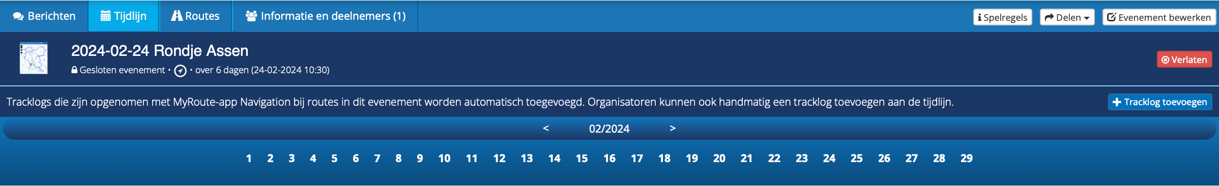

          @Jack-van-Tilburg
          Hello Jack, I am aware of this option and I use it as well, only, after having driven the event route, I have to add the tracklog manually to the event!
          In the past this tracklog was added automatically!
          The tracklog would appear under 'Tijdlijn'

            @Albert-Renting
            Could it not be that the track log ridden on 24 - 02 is added? That is the start date of your event.
            The other screenshot shows the option to "also". manually add tracks.

              @Jack-van-Tilburg
              Hello Jack, I am aware that the pictures I included are from events in the future, so there is no Tracklog (yet) for this event. The pictures were only to 'clarify' my intentions.
              But, past events had the problem that I had to add the Tracklog manually to the event while in the past this happened automatically (when the box was checked beforehand)
