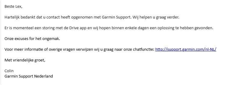

                    Just got this reply back from Garmin regarding the borked drive app. After I called them I uploaded an email with a pictorial description of the issues the the current version of the Drive app had caused. I think that a fair few people had contacted them about the issue which was good, as it will hopefully be resolved soon.
                    Thank you for your email.
                    This issue will be resolved in an upcoming Drive app update. We'll notify you via email once the new version is available for download in Google Play.
                    Apologies for any inconvenience caused.
                    Kind regards,
                    Jake
                    Garmin Europe

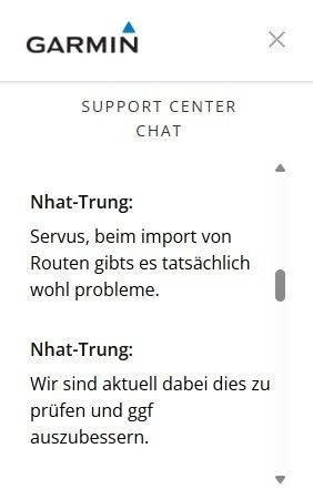

                    • Travellexxie
                      I have received more or less the same answers from the German and Dutch Garmin CS
