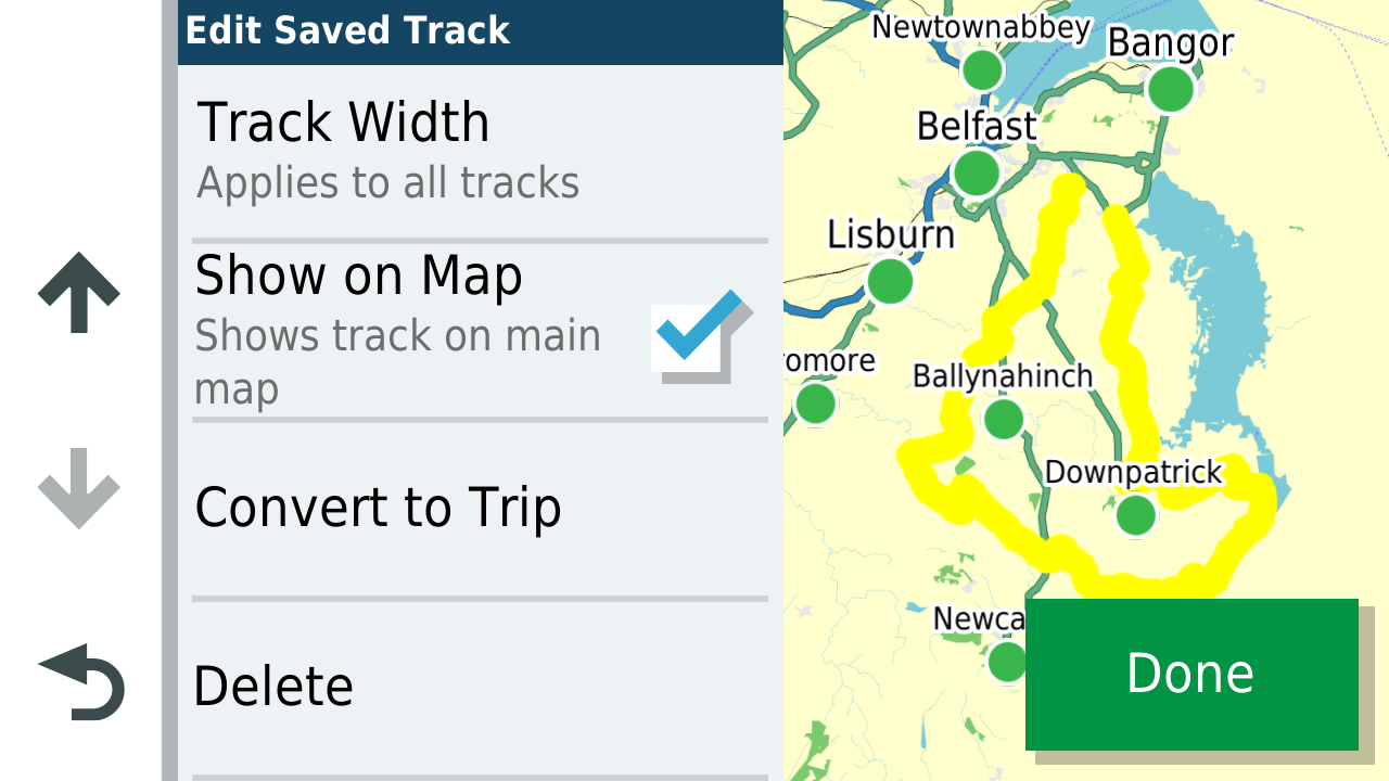

        Yes, if he is using a Garmin Device up to the Zumo XT a track can be displayed by enabling it in the devices track manager. For the XT this can also be achieved by connecting to explore and managing "Collections" but I wouldn't recommend it. If using the MRA navigation when navigating the blue line becomes white indicating the intended route, if you go off route and are returning to the route you can see the white intended route on the map display as you approach it.

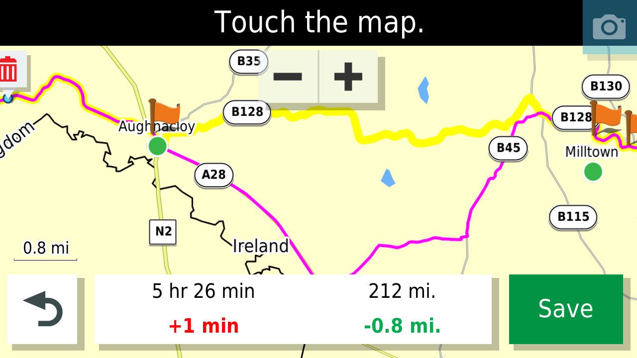

        A track never changes so if you are riding a route or downloading it into a device if gives a reference in case the device creates a different route than that intended.
        In this example, the track is in Yellow and the calculated route by a Garmin XT has taken a different route than the road intended (the Magenta line) so to correct this an additional shaping point would be required on the yellow line.
