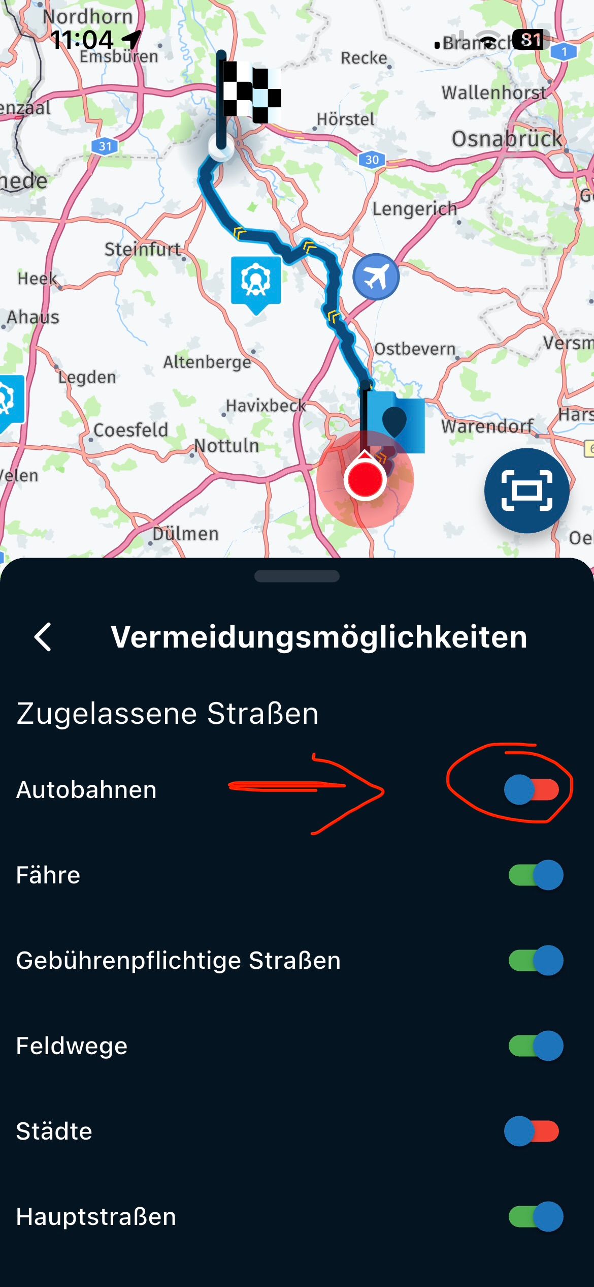

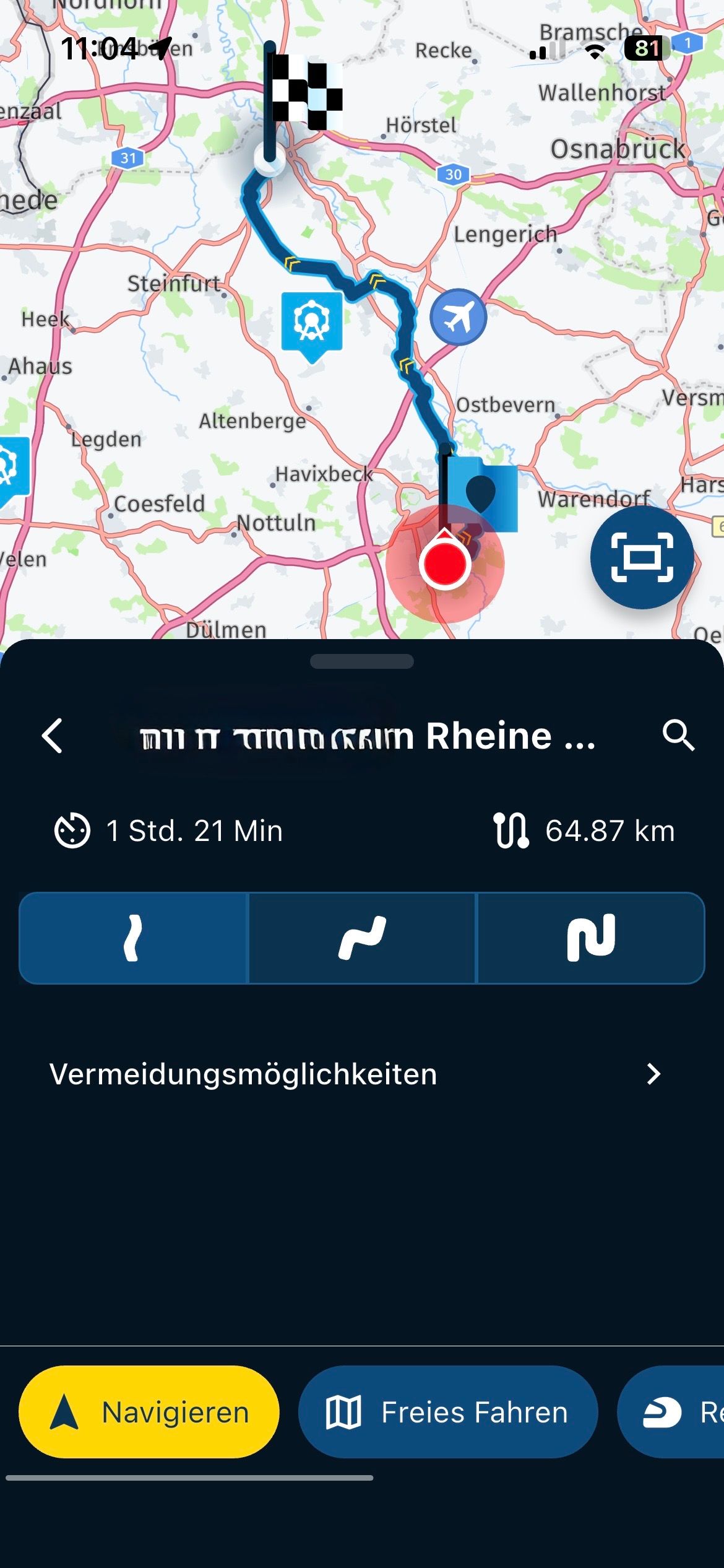

      I don't think it's a mistake; you really should check the track navigation settings before setting off—this is something you can and generally ought to do before starting a route or track. In your case, it is indeed track navigation, since you are talking about a route from point A to point B. Track navigation assumes a route with at least some curves—meaning it generally avoids motorways. Even if you start by getting onto a motorway on-ramp, the system will always take the next logical exit to get you onto a more winding route.
      VG
      Siehe die Fotos:
      Selection slightly curvy ..
      Avoidances …
      iPad 9. Gen iOS 26.7/ iPhone 16e iOS 26.7/ Navi iPhone Xr iOS 18.7.10 / PC mit MS Win11 /❗️MyRoute-App im Cradel und Remotek-One❗️ Info zu MRA & Remotek One
