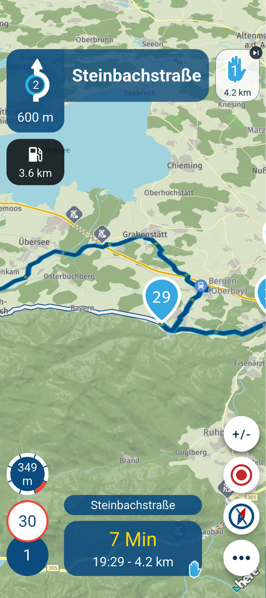

      When planning a round trip in the app, a nice route was made with 2 known route violations. Both were blocked roads due to roadworks. The mra said sent me over this road, did not provide a d-tour when we saw we could not pass and then it kept on sending us back to the same place knowing we could not pass. This was very annoying.
      wrote on last edited by MotoCon
      @Metalhead, the app will not send you back because of the blocked road, but because of a missed track point. It will send you back maybe 2 or 3 times, and then give up.
      Metalhead 1 Reply Last reply

          @Con-Hennekens this is what I question.
          Why does it make a route through a well known roadblock?
          Why does it not offer an alternative?
          Why does ik keep on trying to get me back to the routepoint I supposedly missed for far longer than 3 attempts.

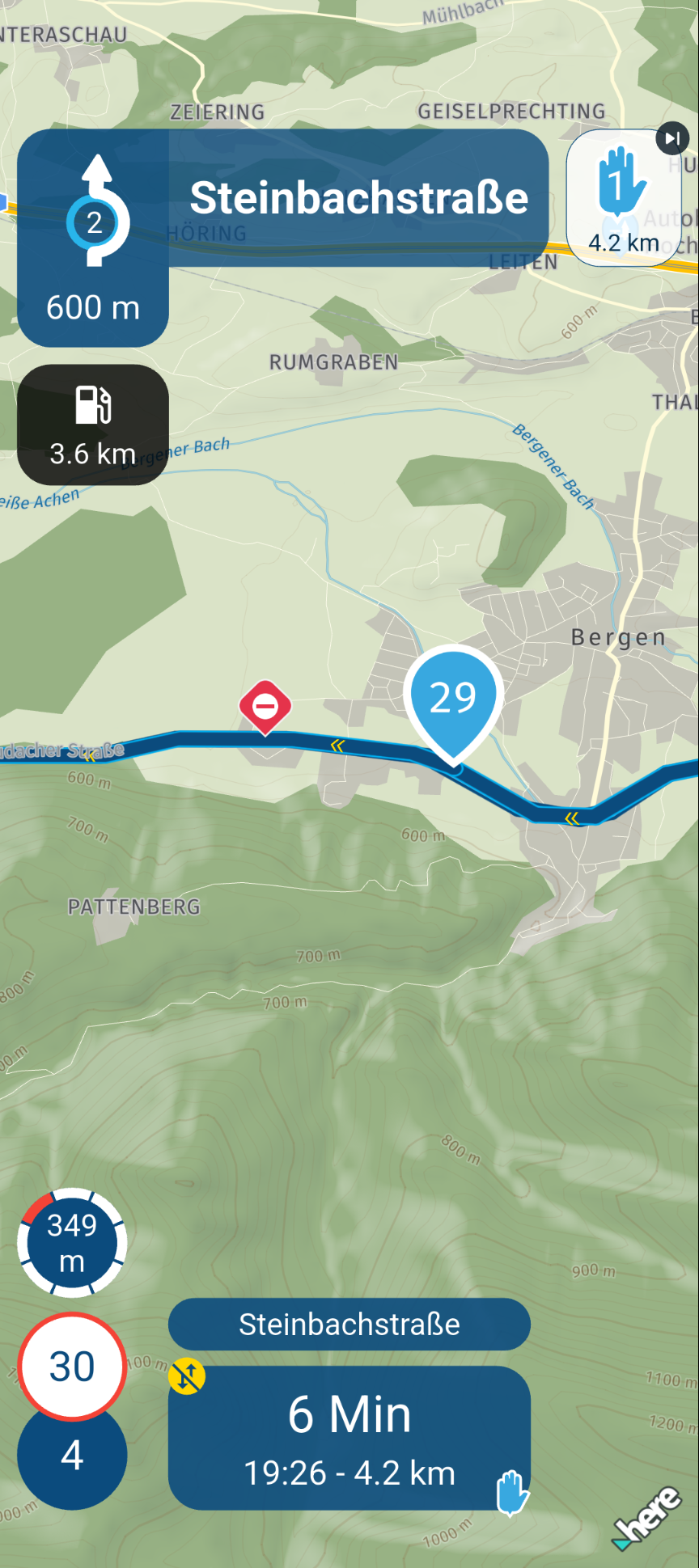

              The road block was visible in the map, the route info said there was a route violation due to the road block and the app kept telling me about the roadblock. The thing it did not do was not plan a route through the roadblock or provide an alternative.

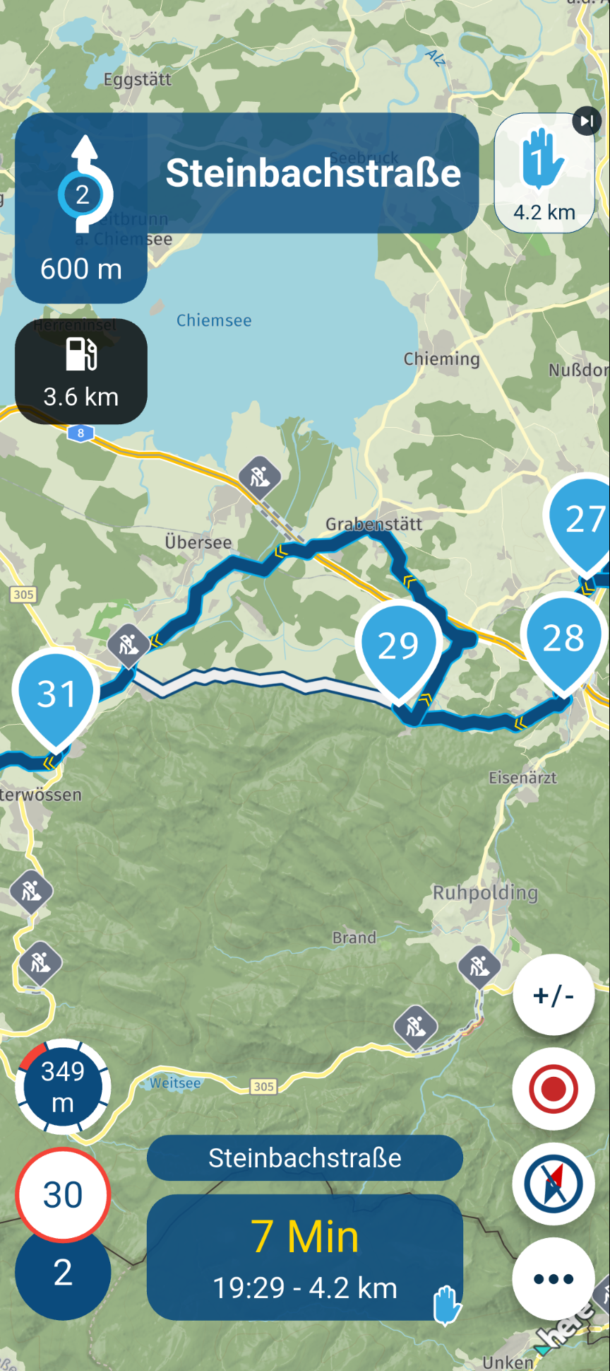

                I've experienced this as well. During my long road trip last month there was at least one location where the app stated there was a known route violation road closure, yet it directed me through that violation anyway without offering a detour. I don't know if it would have tried redirecting me back through it, because I manually looked up the best detour route and changed the route to account for it.

                  I might be wrong but I think that MRA does this "by design", but only if you navigate a route as track.
                  The reason behind: Closures are temporary and MRA sort of assumes that by the time you start riding the closure should be gone. If not, follow the signs on the road to guide you around.
                  But there are 2 reasons why I think this is not how it should be :
                  1st : MRA cannot know when you start riding and simply cannot make any assumption about whether the closure is gone or not.
                  2nd : if the road is for example a mountain road then the detour starts long before the closure, there will be no signs for you to follow.
                  Navigating a route as route might help out here. but honestly I think that mra should reconsider the design too.

                        @Herman-Veldhuizen I have noticed the following...
                        When I’m navigating online and Here is aware of a road closure, the app automatically creates a detour to bypass it.
                        However, when I navigate the exact same route offline, a message does appear to indicate the closure on the route, but the app does not automatically bypass it.19000.png 19001.png 19002.png 19003.png

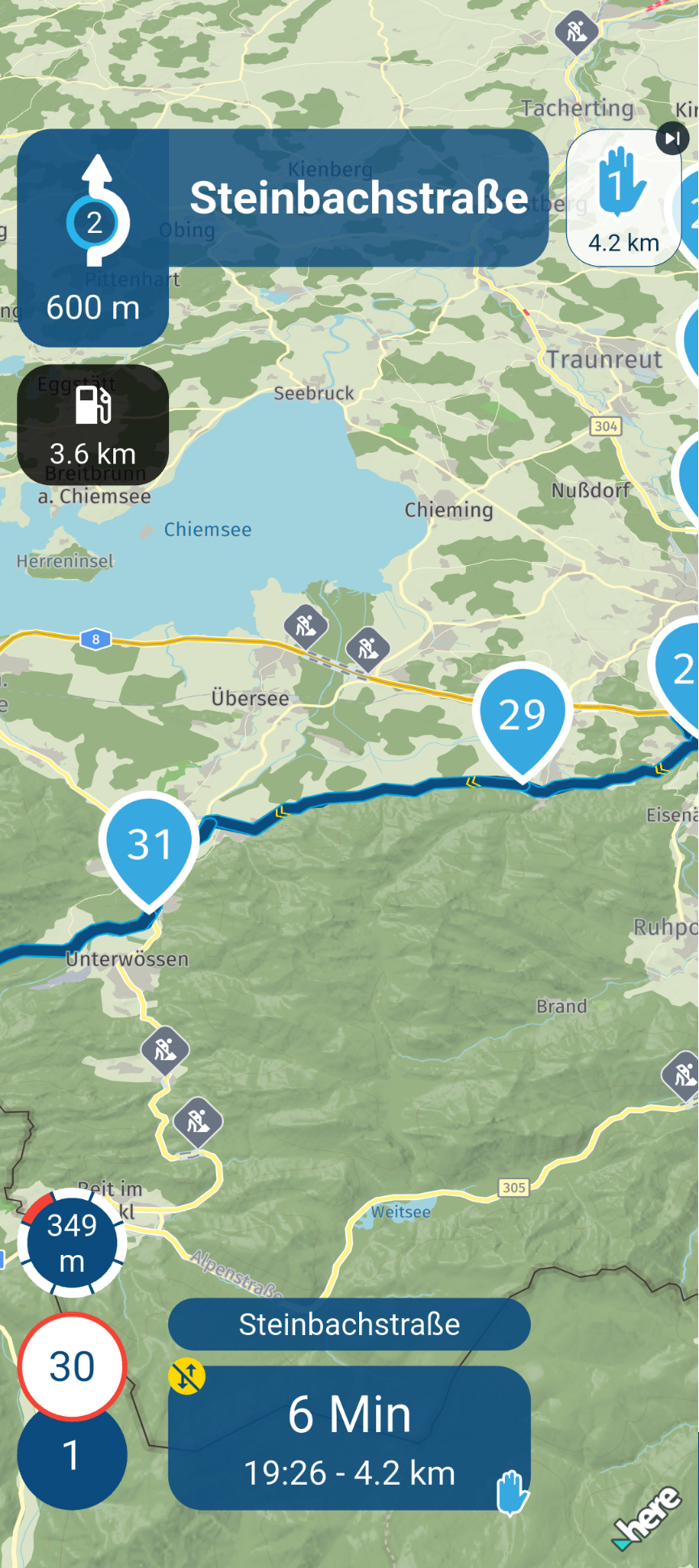

                          @Peter-Zehentreiter Road closures come from online information not from the latest map update. Thats why you get different results. Why you in your example still can see that the road is closed, while being offline, is something I dont know. Just guessing: it might be that HERE cashes road closure info (so it downloaded it for you when you were online) or the road in your example is marked as closed in different ways in online and offline map data. The road is closed in both but the app maybe only checks one way and therefore the inconsistency.
                          In your example you navigate a route as route. If you navigate a route as track the closure (i think) is always ignored and no alternative road is presented to you.

                              @Peter-Zehentreiter Is the track saved when I navigate a route as track (its a route, not a track)? From what I understand the track in that case is only created when I tap Navigate.
                              I question the fact that the way a route is navigated (as route or as track) should have an effect on how closures are handled. The issue of the topic starter @metalhead was that the app did not provide a route around the closure.

                                    @Peter-Zehentreiter Then the only advice to the topic starter is to be online and to NOT navigate a route as track. I dont think it should be that way. He doesnt have this choice when using a generated round trip
