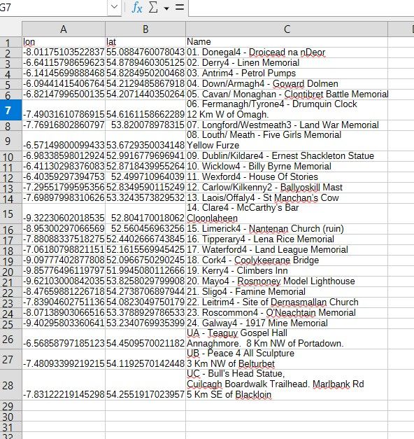

    • Mzokk
      Oddly to import a CSV POI list into MRA you need to organise the list by Long,Lat,and Name. This is a CSV of Irish photorally waypoints I have imported to my library.
      To get to this point I had to merge several columns of data into the "Name" column so that when you clicked on the waypoint on the map you got some meaningful indication of what the point was. When I imported the same info as a GPX all I got was the Long and Lat which wasn't very helpful. Its an aspect of the MyRoute app route planner that is ripe for improvement.

        First, thanks @mzokk. Despite that the fact that I said "lat/long" in the post, the columns were as you pointed out, "long/lat, in the file.
        Second, seems I managed to be "that guy" who manages to, on his first post to the list, waste space and time with a bogus question. I posted after the 3rd time looking things over and not seeing it, only to find, 10 minutes later on my fourth look, that I had uploaded a different file than I intended and was searching for the points in the wrong place. 😞
        I removed that import and imported the right file and, lo and behold, everything was as it should be.
