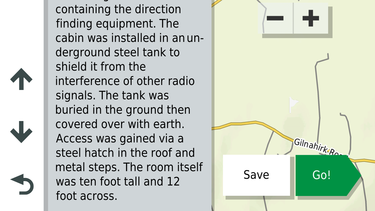

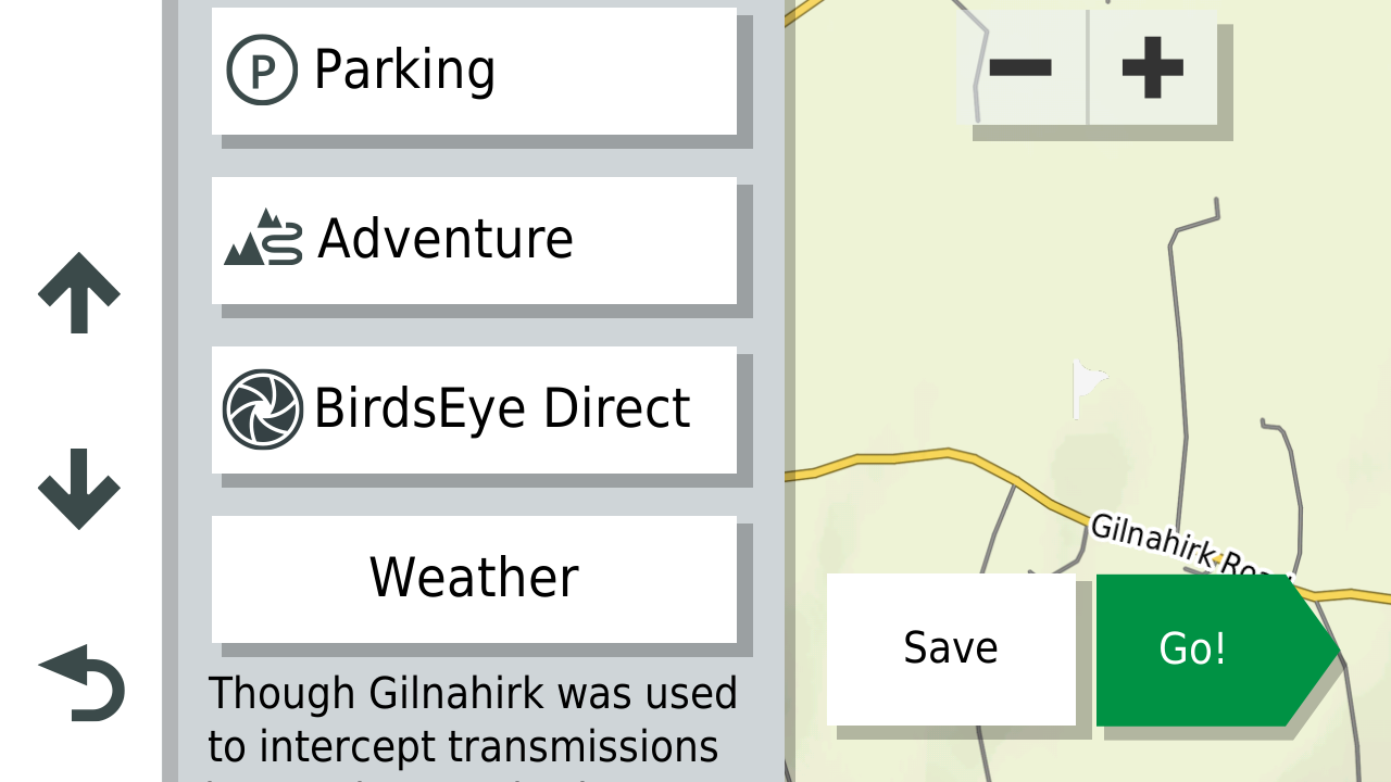

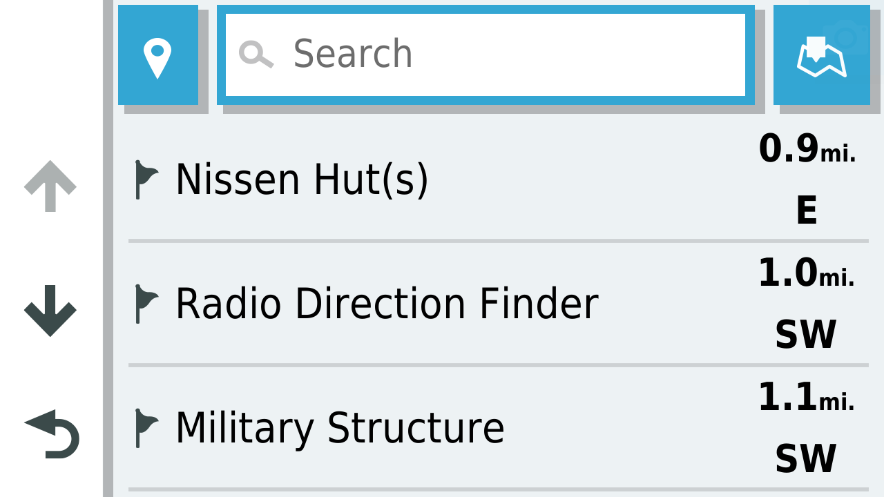

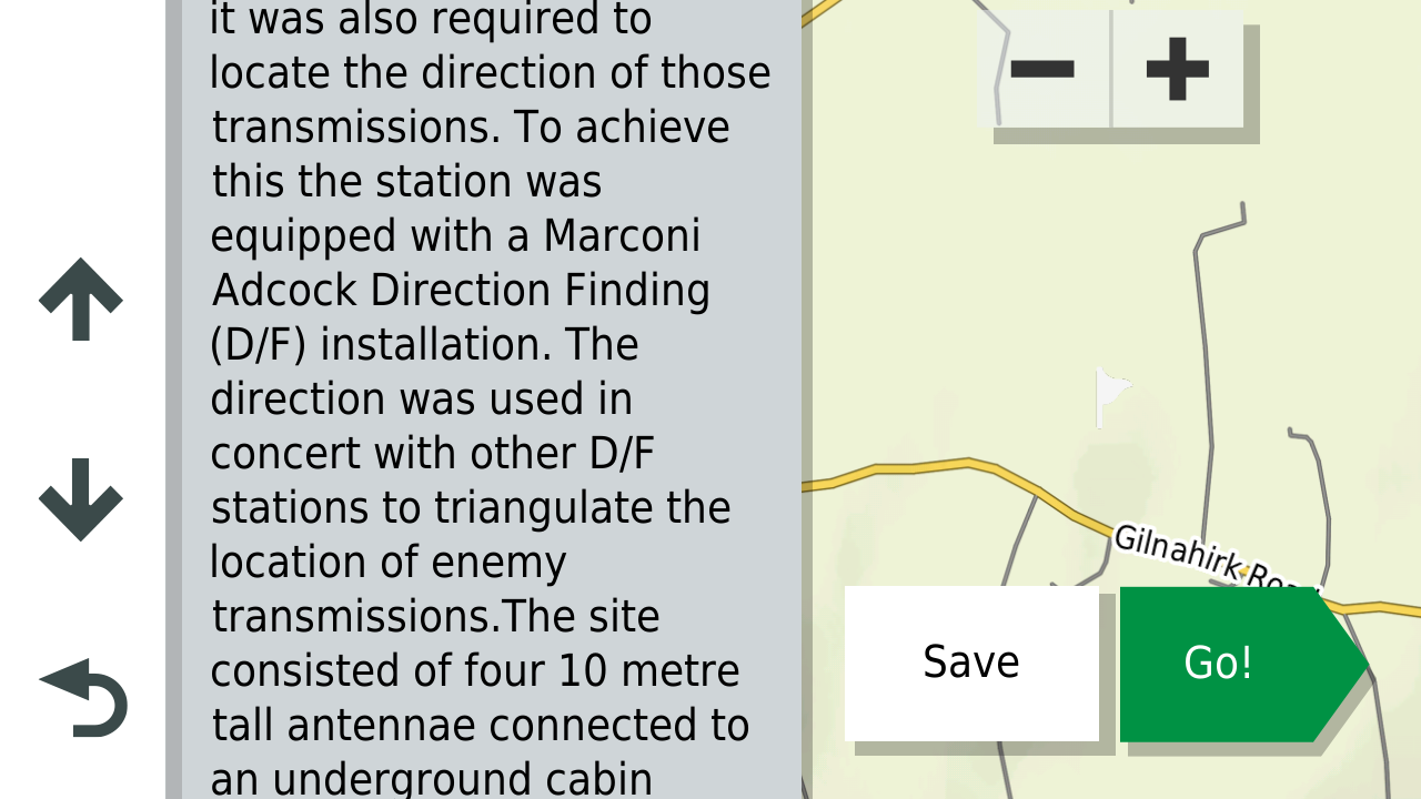

                  @Boštjan-Kreutz Similar to Will I run proximity alerted POI's for Picnic sites, Public Toilets, Dolmens and Ancient sites, Castles and WW2 defence heritage. Garmin devices do this sort of thing much better than MRA currently. That said I run MRA for navigation On my Africa Twin's Android Auto Screen and run the track of the route on the XT and use the XT for POI's. I started off looking for an alternative to Basecamp and my Zumo XT and have ended up using both 🐶
                  The Zumo XT also allows much more descriptive information to be stored with POI's loaded onto the device via POI loader. For example, there is an old WW2/Cold war listening station near me. I took the info from a govt website that publishes information about built heritage there are 2000+ WW2 sites listed in Northern Ireland.
                  So if I pick the radio direction finder site I get this information
                  So extensive notes can be attached to Garmin custom POI's something that MRA's implementation of custom Poi's isn't quite capable of yet (and perhaps never will be as Garmin POI information is stored locally on your machine or the device whereas MRA's info is kept in the cloud and therefore I would imagine space is at a premium.
