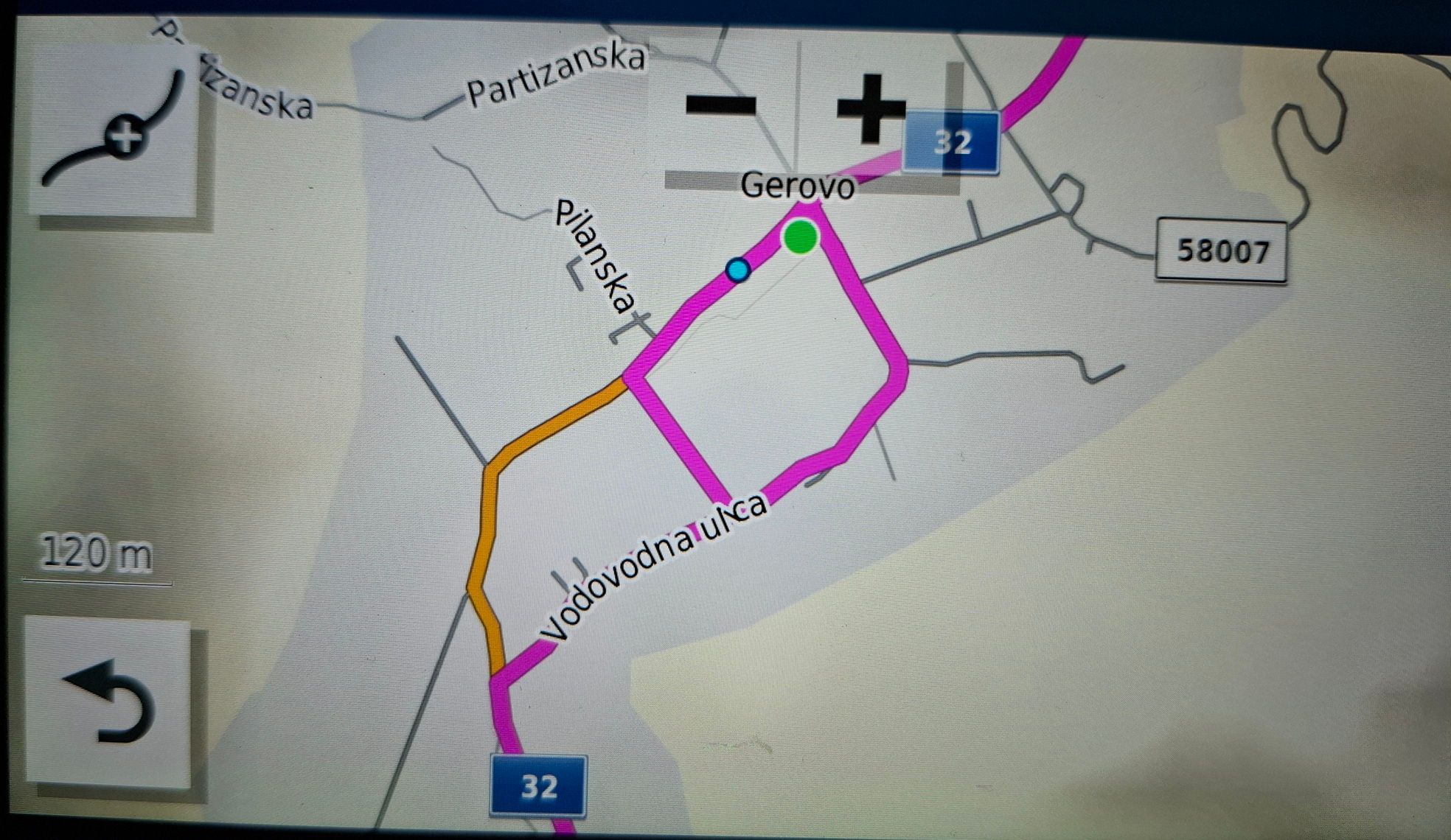

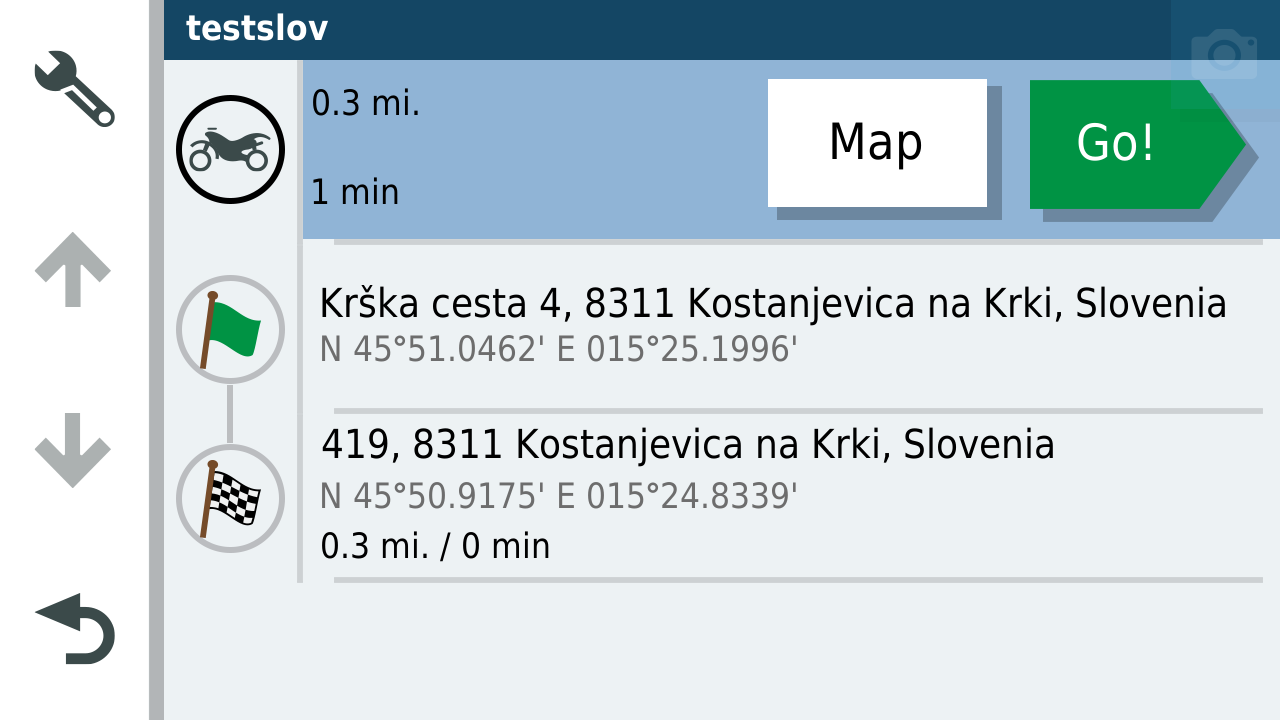

    Hello everybody. I am a gold MRA user and I use MRA to create routes in HERE maps and transfer them to my Garmin Zumo XT (using Garmin Drive and gpx 1.1 R/T/P).
    I noticed a weird behavior lately and I cannot understand what is going on. I first tried the Zumo XT forum, but couldn't get any real explanation there...
    Just to clarify, I have my Zumo XT updated all the time and I created the route in MRA freshly in the morning and drive the route few hours later on the same day.

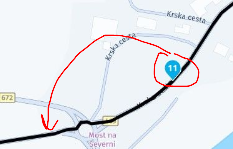

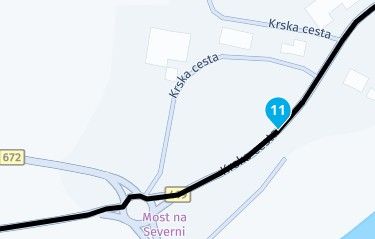

    This is how one part of the map looks on MRA - and this is exacly as I want it:

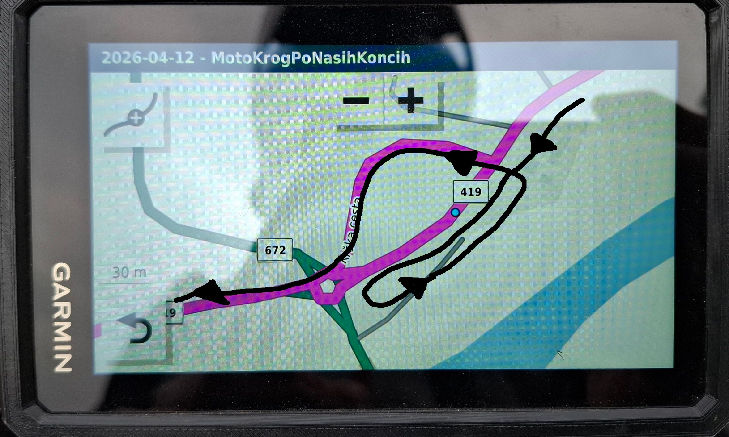

    This is how it looks in Zumo XT maps and the black arrows shows how XT wanted to navigate me through this section:

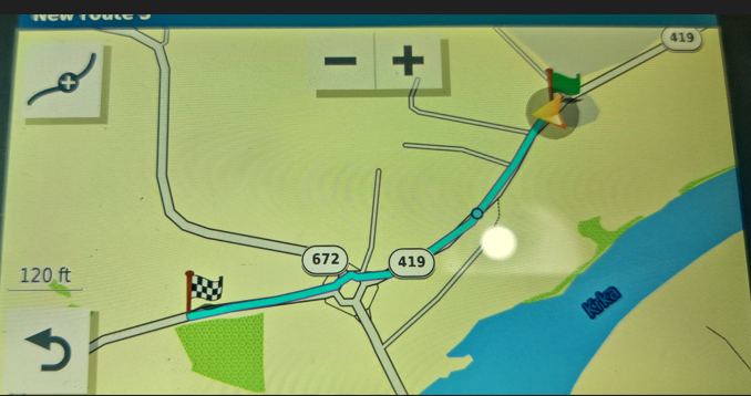

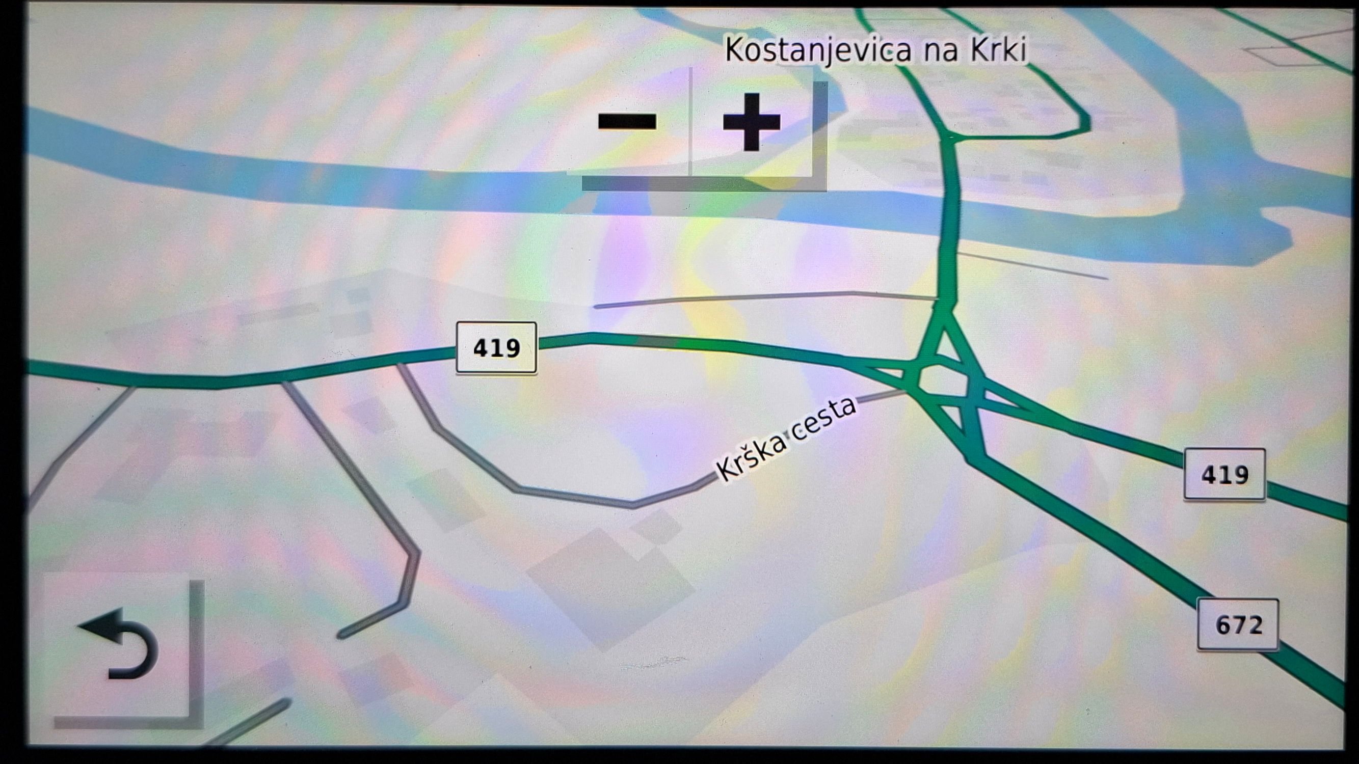

    What is weird though, this is the original map on my Zumo XT of this section, when I don't have navigation active (it has everything connected and it shows that Zumo XT knows which road is the main one):
    On the Zumo XT forum some suggested that I placed the shaping point in the wrong lane on the road, but from what I see this road doesn't have multiple lanes (not on MRA and not on Zumo XT)...
    I also checked my avoidance settings, but nothing helped there. Also MRA has the "shortest route" and Zumo XT also has "shortest route" selected.
    Any ideas on what I am doing wrong?

      It looks like your Zumo thinks a right turn is not allowed. It could be a map error on the Garmin map.

          @Con-Hennekens @Boštjan-Kreutz
          Garmin XT (which i also have) uses the NTU maps which is basically the HERE map with a few adjustments done by Garmin that turnes the HERE map into the NTU map.
          @Boštjan-Kreutz
          The suggestion made by that person on the Garmin XT forum makes only sence if the 2 lanes are splitted by a central reservation. If the two lanes simply lie side by side without a separation such as a central reservation than it does make no sense.
          Also, the route is determined by the way the routingpoints/waypoints/shapingpoints are placed. Routes made in MRA always goed from 1 to 2 to 3 to 4 to ..... (you get the idea).
          Just to clarify this:
          Have you ever updated your Garmin XT device? Garmin provides updates on a regular base.
          What your device is showing looks like some glitch to me. Check if you can update your device. In 99,9% of all cases updating the XT solves most problems.
          Just 1 hint from me which i always do, i always places routingpoints/waypoints/shapingpoints after roundabouts. Just to be sure that my XT is following the road as planned.

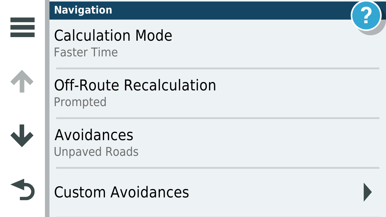

            It is recommended for XT users to turn off Automatic recalculation
            Most will have this turned on but i have notices (and read on other forums) that turning it off also avoids "crazy stuff".

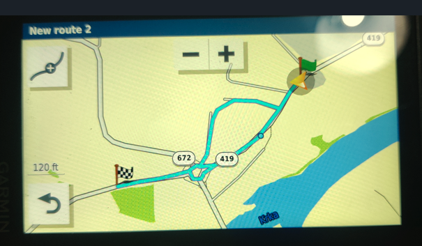

              @Boštjan-Kreutz there may be slight differences in the maps from MRA & that you get from Garmin,
              the 2 companies update the maps at different intervals,
              but I do not think the map is the problem here,

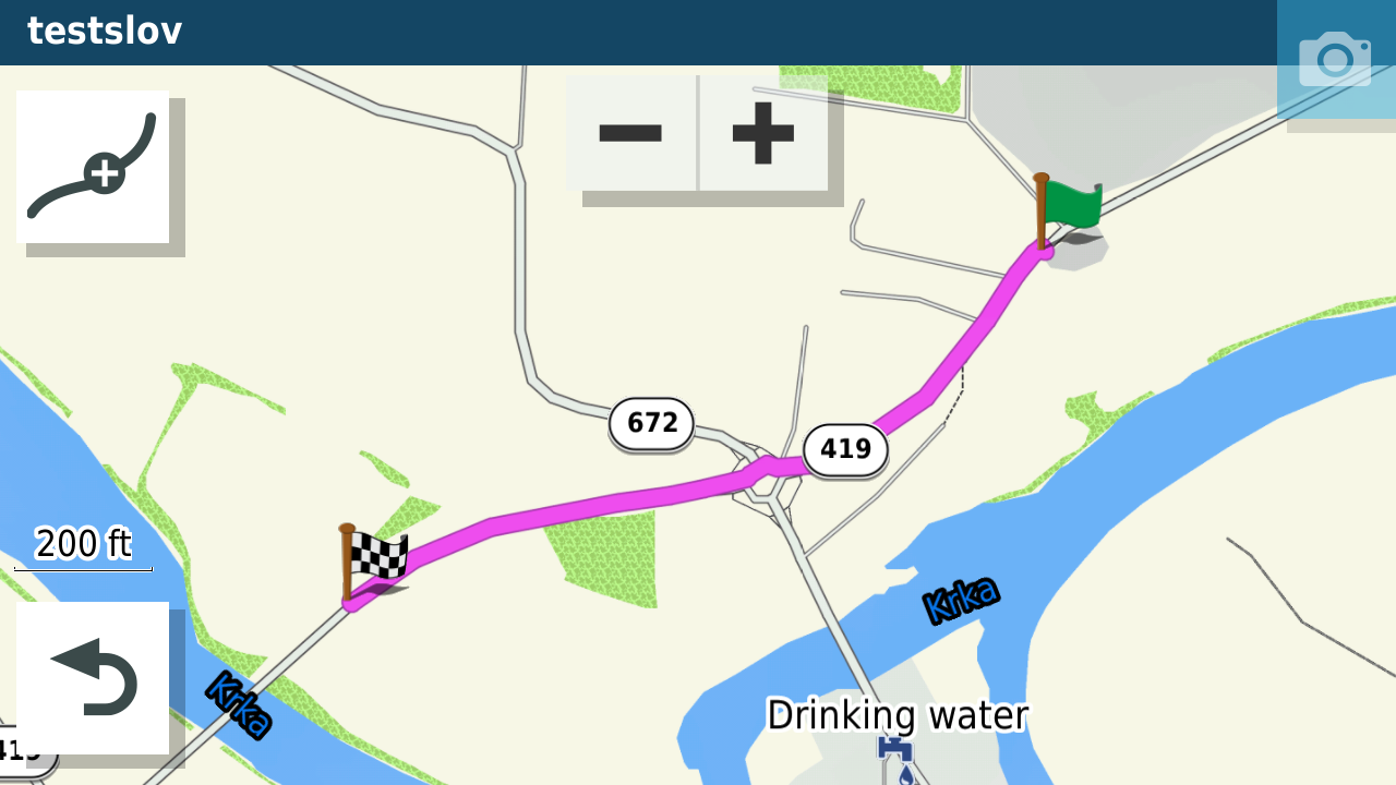

              First I used a simple route with 2 points either side of the roundabout, just the start green flag & the finish chequered flag, the simple route on my Zumo XT was good & the simulated path taken was correct
              I then added a middle point before the roundabout in a similar location as shown in your picture
              My XT gave a crazy route similar to yours
              For the last test I just moved the middle point to the north side of the road & the route works correctly
              For me this is just another crazy case of the Zumo XT doing stupid routing & why people keep repeating that you have to place the points exactly on the road.
              This case proves even when the points look correct the XT will still get it wrong, it looks like it is trying to get to the little side road to the south towards the river
              MRA navigation is a lot more, a lot lot more tolerant of point placement
              Because of crazy stuff like this it is why I gave up on the Zumo & why it now sits in the bottom of a drawer
              As I have said many times, IMO the XT is a piece of $&!7
              (recalculate on/off makes no difference in this case)

                      @Boštjan-Kreutz said in Weird navigation MRA to Garmin Zumo XT:
                      Also I think I have a recalculation turn on, I have to check. I also don't quite understand how does device reacts when I turn this off, I have to read about it some more. Because I do want the XT to reroute me if I do some unplanned turn because of the sightseeing, road block, or whatever reason. That is why I also use shapping points (not only via) to easily skip them during route if need be.
                      I understand your doubt about the recaclulation turning off.
                      But the main reason to do this which is also suggested on other forums is that, if you have a route and you want to follow that route from A to B as it is ploted and as it is intended, you turn it off to avoid any deviations/reroutes/etc.
                      I get the point that you want to be able to take an unexpected turn somewhere to the left or to the right. But kep in mind that your device might direct you back to a waypoint that you skipped.

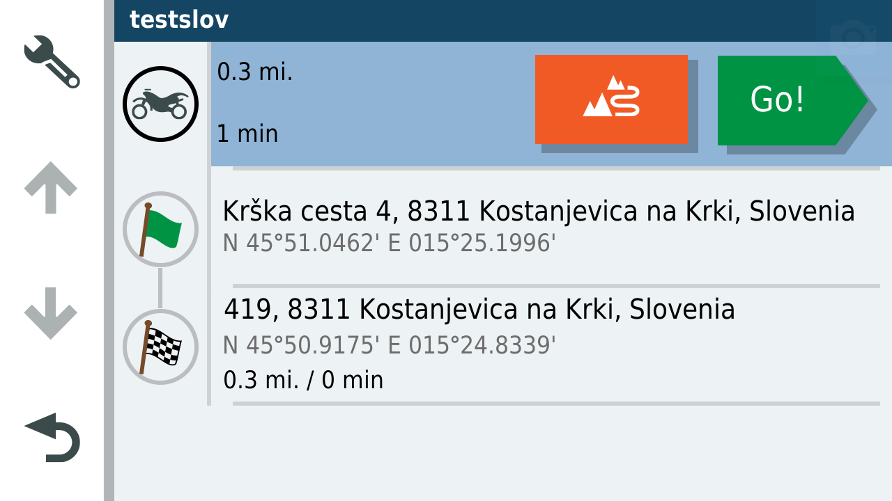

                        I've tested this route on my XT and it works fine with no glitches.
                        My calculation mode is faster time.
                        When you open the route to navigate it looks like this.

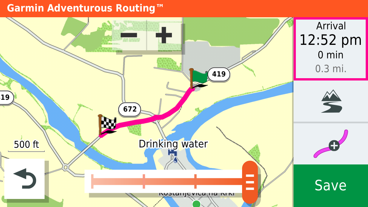

                        If you set nav preferences to Garmin Adventurous Routing you get the little mountain box
                        When you press this before hitting go you can use the slider to make the route more wiggly.
                        I don't use it as it can bring you round housing estates and city streets and I prefer to put enough shaping points in to pin the route to the roads I want to be on. Could this have created your issue?

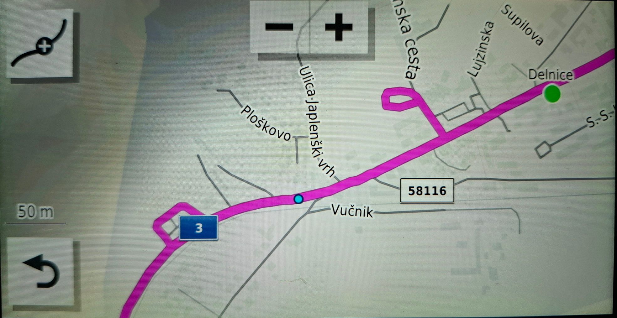

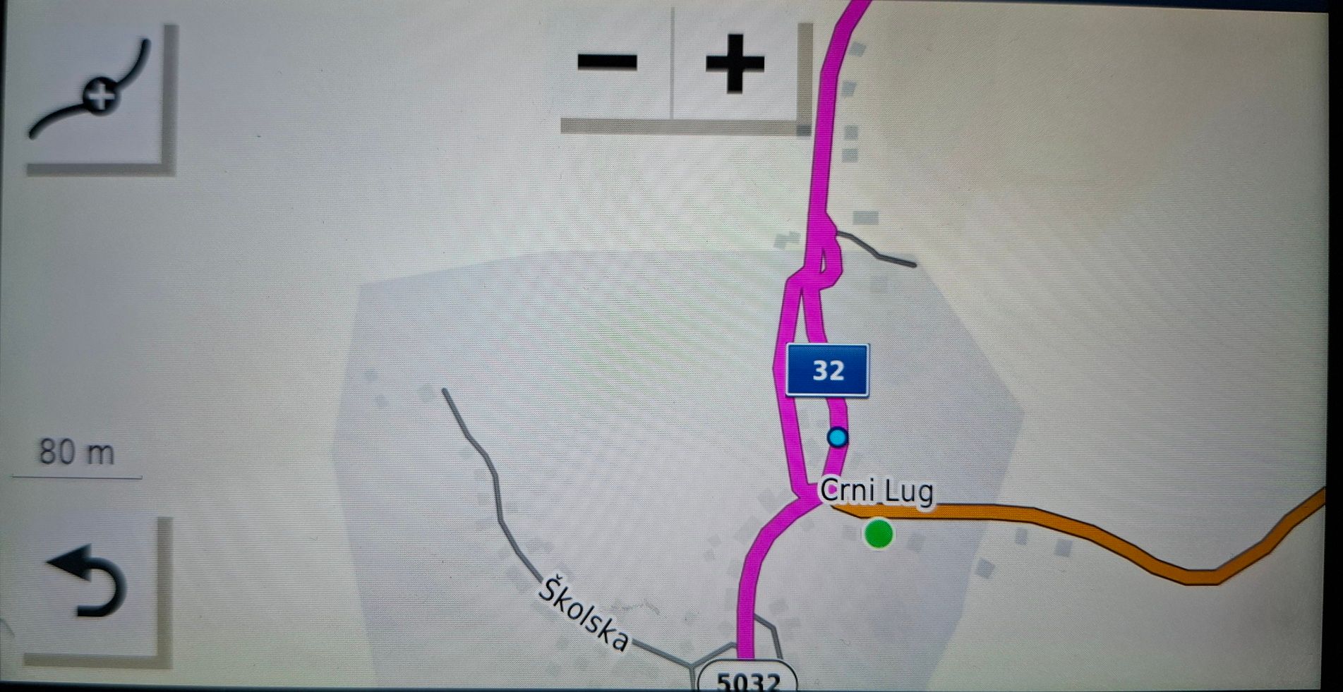

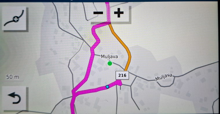

                          Anyhow, I dig up some more of the other similar cases I got - all these are just from the last two rides 🙂 And non of these has a roundabout or two lanes road.
