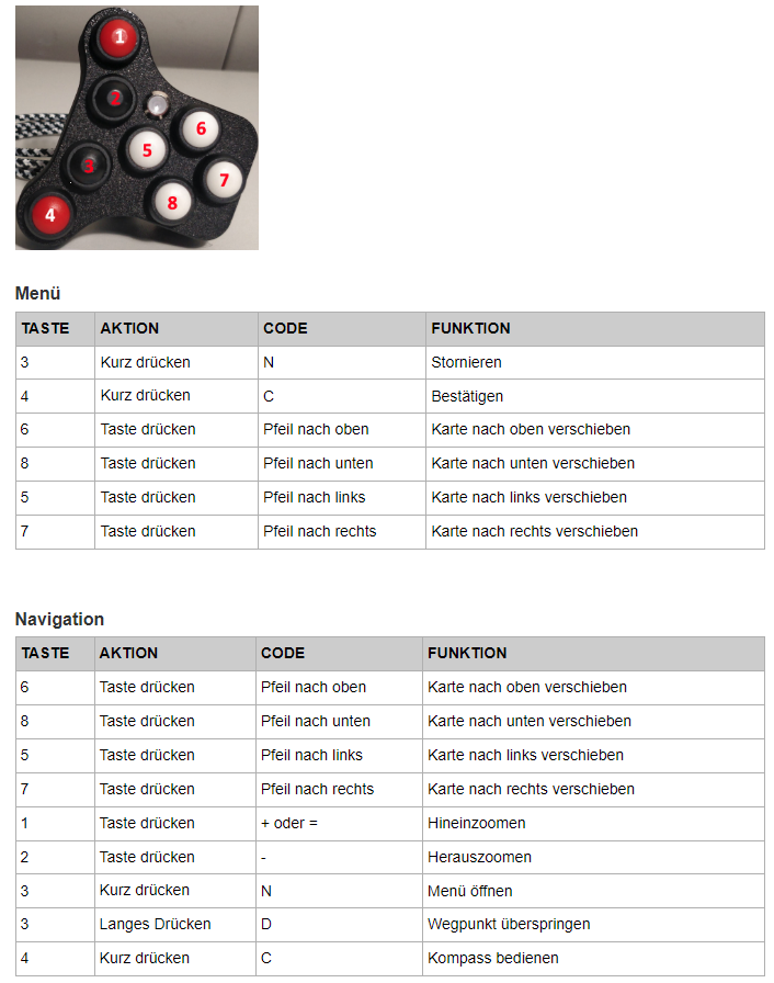

    Hi,
    I noticed today that I can not close the menu while navigating with the Barbuttons.
    Open is working, but not close.
    I tried at home with a Bluetooth keyboard and sent the letter "N". It opens the menu, but it does not close it.
    So if you change something (e.g. warnings) you need to tap the screen, remote does not work.

          Hi Con, yes this is maybe an option, but you need to hit at least 3 times the back arrow key to reach the correct position and then hit another key "C" to confirm it.
          And then the menu closes, but also changes the view into "Top Down". Because the "C" key was used. To get back to previous view, you need to hit "C" another 2 times.
          In the past, the letter "N" opened and closed the menu.
          Just one button 2 hits.
          I prefer the old version.

              I can not check now but, as I remember, + goes deepper into submenu, - goes back, so on the main level - should close menu - am I wrong?

                • and - does not have any function in menu (at Barbuttons).

                  @Corjan-Meijerink is it possible to bring this back?
                  Drawer (menu):
                  • arrow keys move focus
                  • c selected focussed element
                  • n close drawer
                  You wrote this here:
                  https://forum.myrouteapp.com/post/21057

                    Sorry, I use Remotek-one a didnt'n know that.
